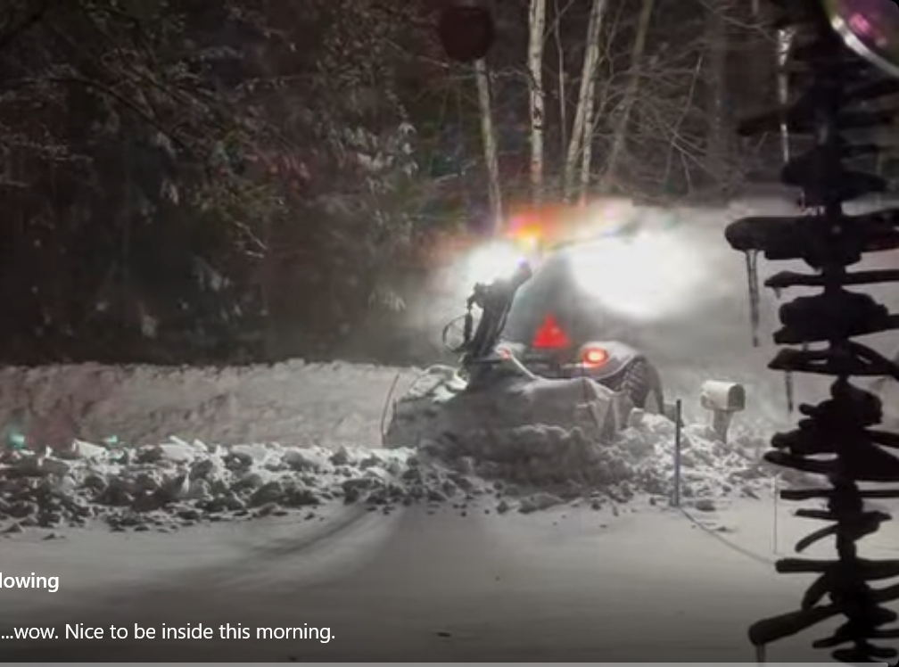

This was a nice storm. 💜

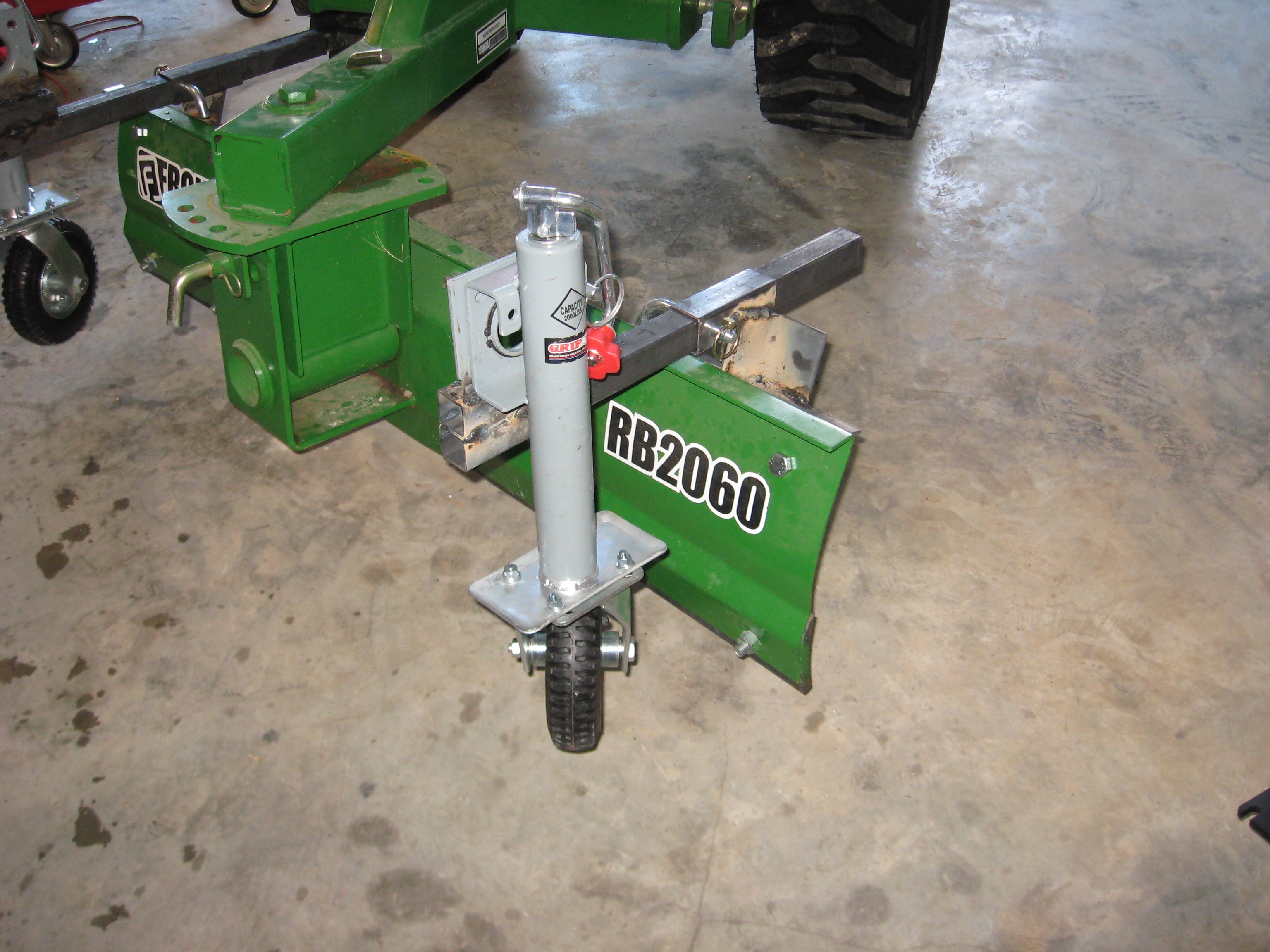

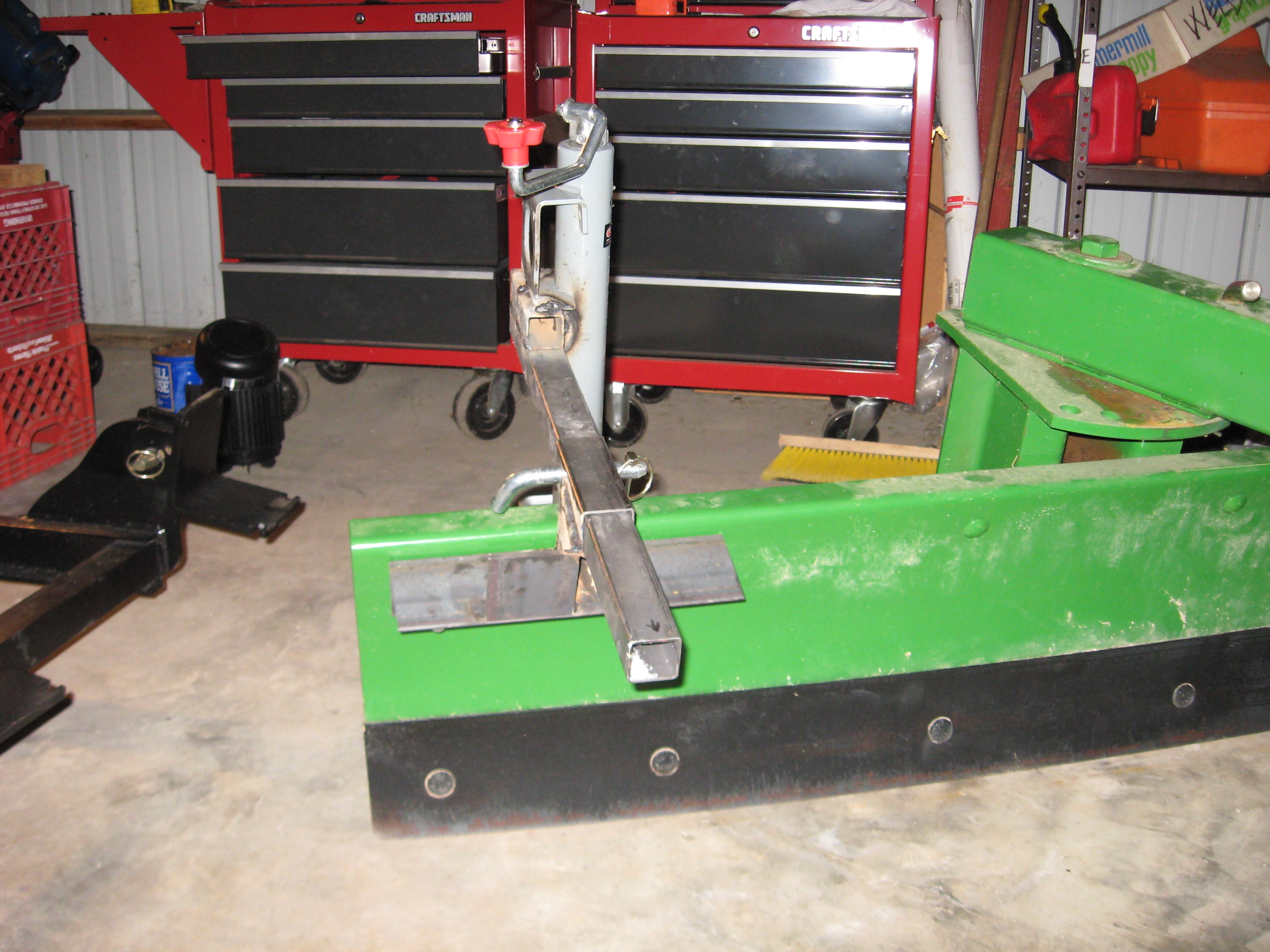

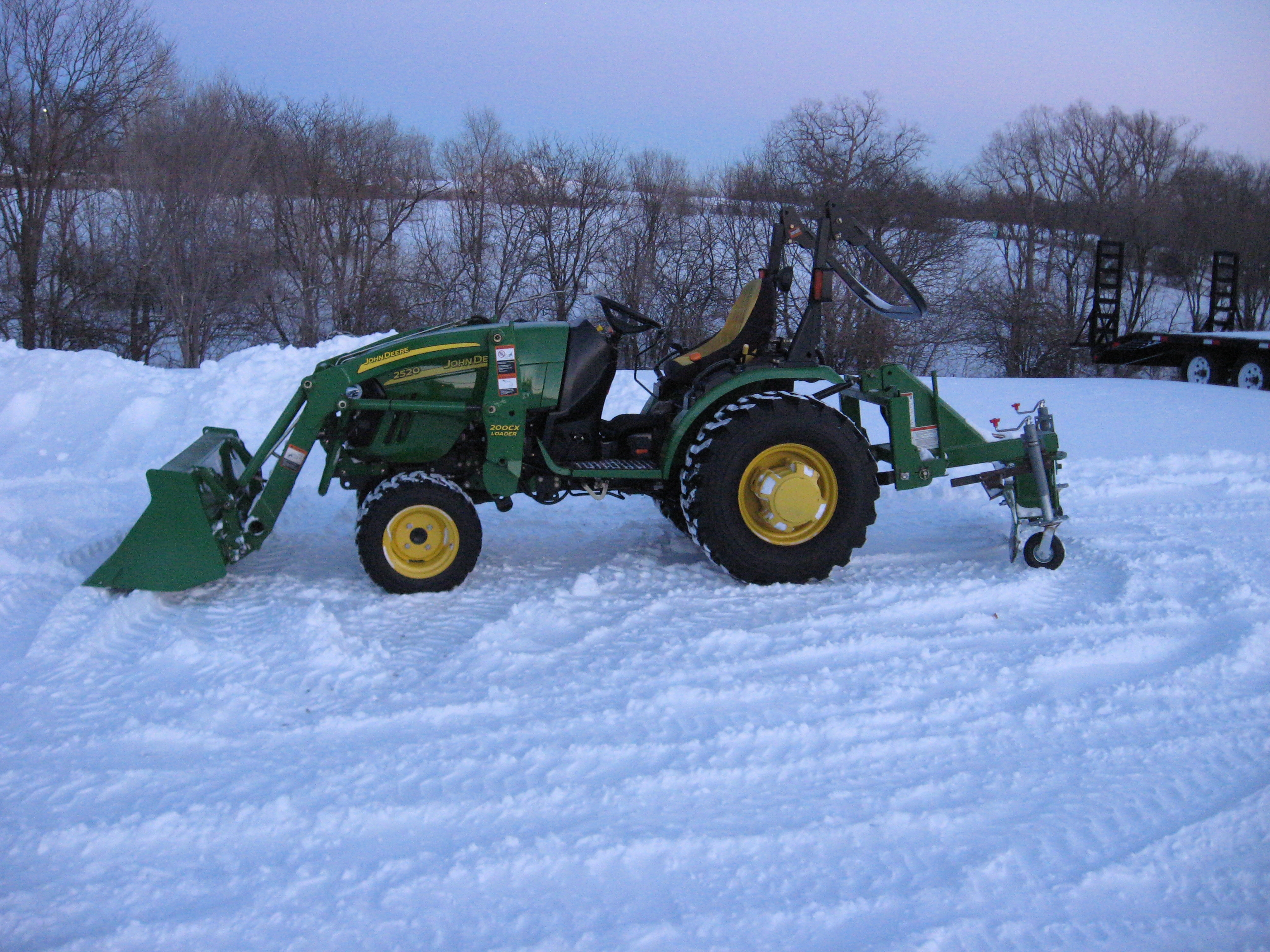

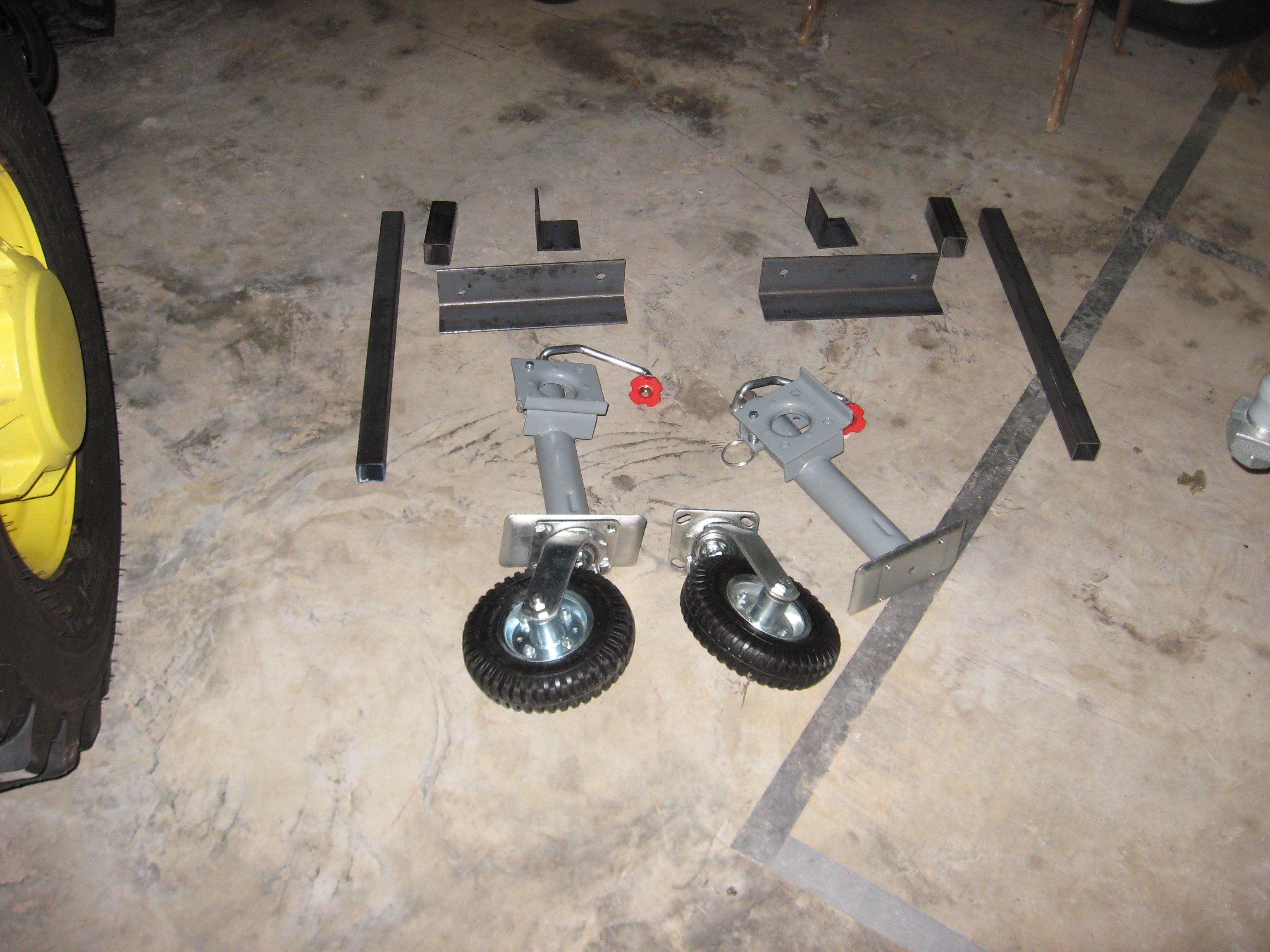

I'd like to see more pics/info on how you installed the gauge wheels on your rear blade
/ How do you plow snow? #279
Your wish is my command. Here are the pieces all blown apart.
And here is a close-up of the "finished" product.
Note: The cheapo air-filled tires you see in this photo lasted, literally, one pass before they were shredded, so now it has 6" solid rubber tires from HF.
Also Note: This was supposed to be a "prototype" and not intended to be the final product. However, it worked so well, I just pressed it directly into service and forgot about it. Didn't even paint it. The square tubing I used was cheap, thin wall stuff, but the actual plan was to use trailer hitch gauge material. Maybe someday I'll go back and make the "final product".
In summation, I don't know how anyone uses a rear blade without gauge wheels and I almost never take these off.
