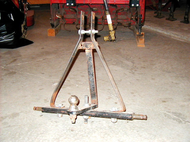

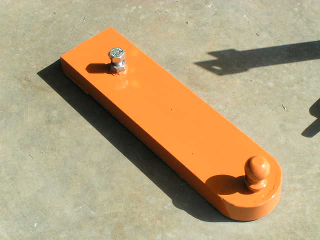

Oh, well, I'll put a picture of the one I made, since it was just scrap material I had laying around the shop.:laughing: I wanted to move the ball back from the drawbar a little so I could turn shorter. I used it quite a bit, but never did get around to cleaning it up and painting it like I intended to do.:laughing:
My scrap iron is prettier than yours. :laughing: Don't think the guy I built it for ever painted it either. :laughing:

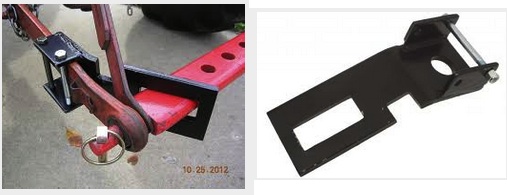

Ok, I have my draw bar lock ....what is the round hole for?

Is this what you have?
I've seen them with and without both the big hole and the top notch. Probably some specific tractor may need clearance for a bolt, etc, in that hole's position.
Bruce

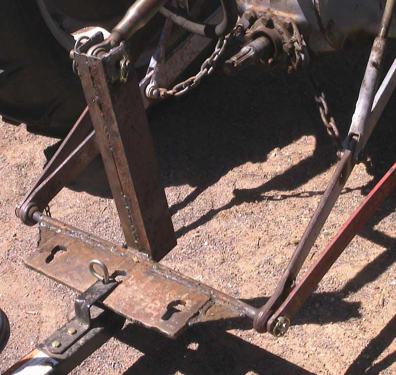

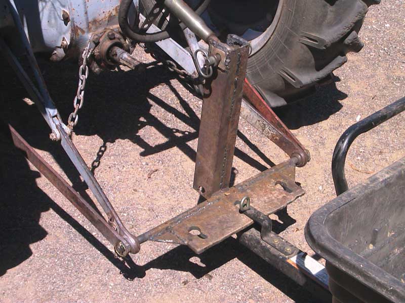

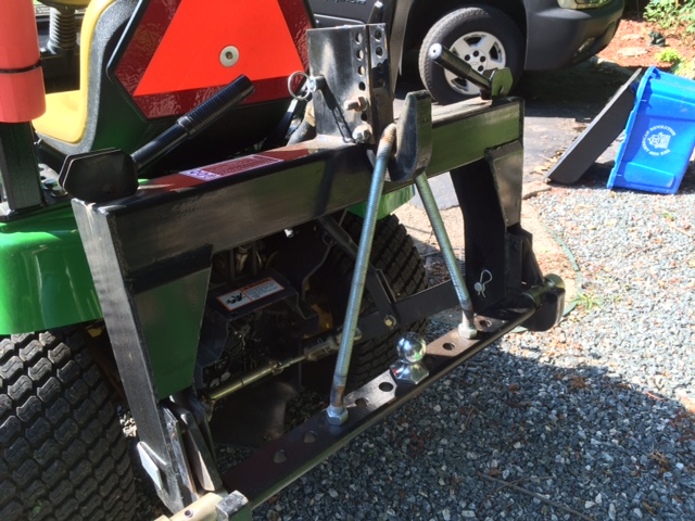

I have the Qhitch on nearly all the time. Here's something simple I made to stop the crossbar from revolving.
The little plate (one on each side) is welded to a cat1/cat2 sleeve, then that assembly is slipped on to each pin and bolted to the crossbar on the inner side and also through the hole out near the tip of the pin - out where the clevis pin could go.
This is sufficient for my 18 and 24 hp tractors pulling a 2600 lb watering trailer on rough ground.
kimg1766rqh-toplinkpins-jpg.475243
Also in that photo - I use removable pins so I can adjust the height of the Qhitch's top hook, or even to mount it upside down to hitch an implement that has interference below its top pin.
