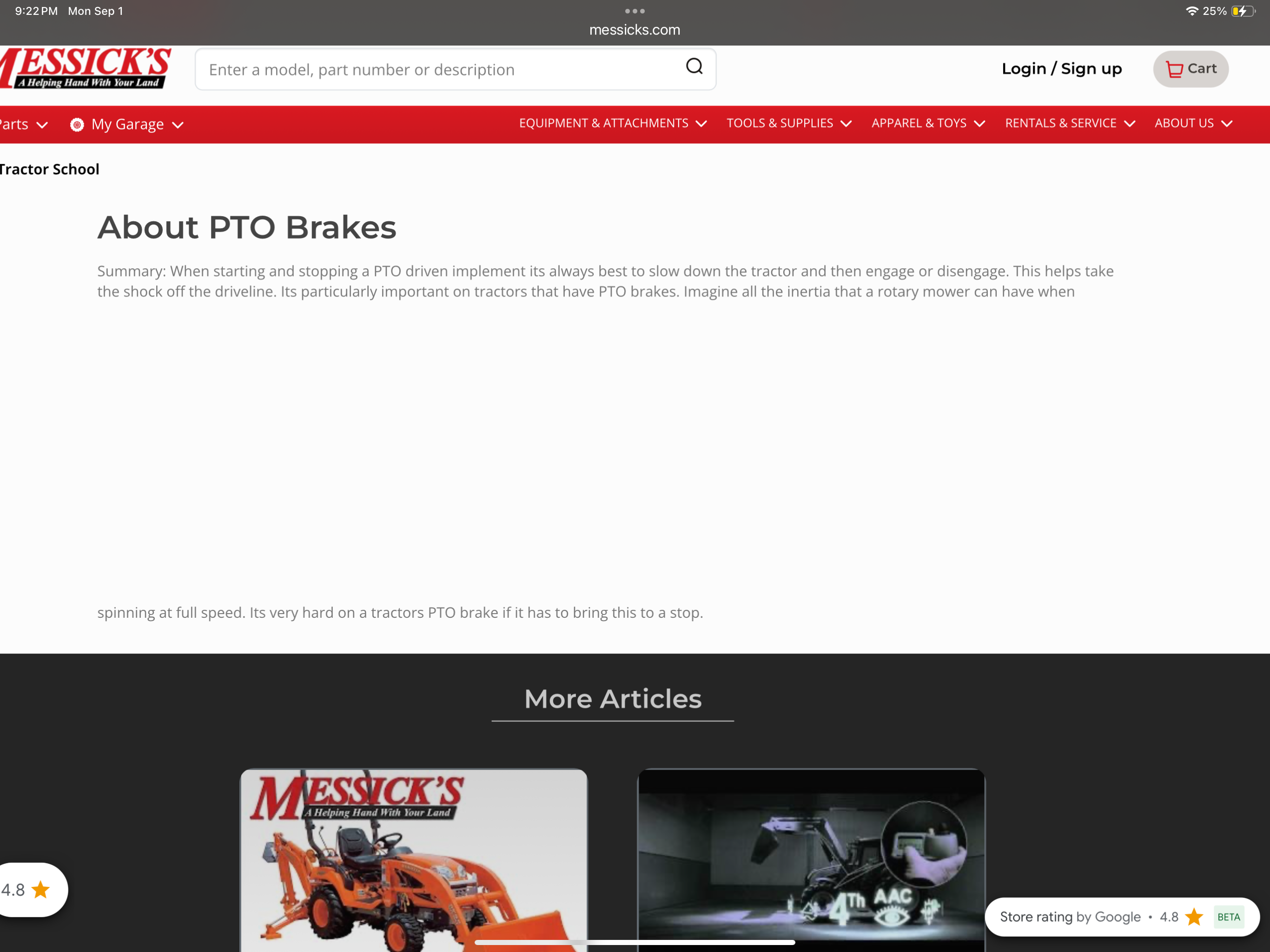

I could be wrong but I believe the MX series tractors use the PTO clutch pack for braking as well as engaging.
/ How Much Damage to the Kubota? #30
Tractors with a wet clutch for the PTO need a PTO brake, otherwise there would be enough drag between the multiple clutch discs that the PTO would spin all the time, arguably, still enough drag that could possible hurt someone if caught on the PTO shaft.
It's there for a reason, specially on those tractors that you can't put the PTO in Neutral.
Usually, the it's a spring actuated brake. As the PTO is turned off, a spring pushes the piston of the wet clutch back and also against a fixed clutch disc that acts as a brake. Others will apply pressure on the brake when the engine is running and let it freewheel when the engine is shutdown.
About the only time it's problematic is for those tractors that have a single speed PTO with no way to put it in Neutral. Otherwise, a PTO brake is no issue at all.
