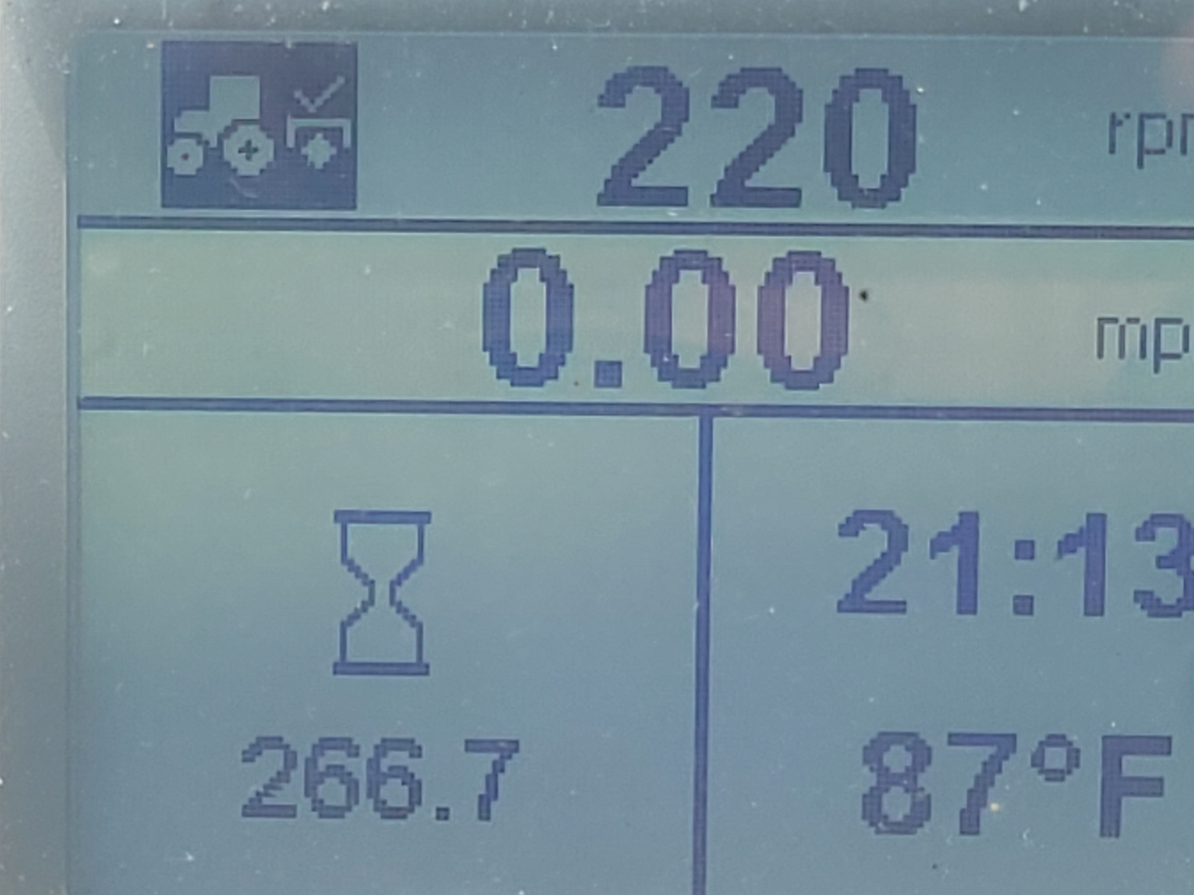

Was mowing front pastures today and got off to get a drink from the fridge. Here is what the PTO indicator looks like when operating normally and after pressing the yellow button. It just reverses the image. After I returned and sat back down in the seat it went back to normal operation. It did get up to 95° before I stopped. Thank goodness for a cab and AC. My clock is wrong, mowed from 1100 to 1530.

niiiice didn't think about that one..... should be an over ride switch somewhere?? My wife actually suggested "we" need a wood chipper yesterday.
On my 25+ year old JG 870 you just tip the seat forward and pull up on the safety switch. Very straightforward. It seems to be more complicated on newer models.
