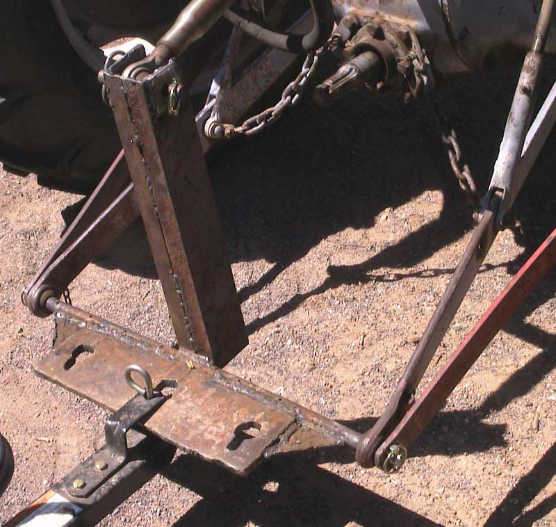

Oh, well, I'll put a picture of the one I made, since it was just scrap material I had laying around the shop.:laughing: I wanted to move the ball back from the drawbar a little so I could turn shorter. I used it quite a bit, but never did get around to cleaning it up and painting it like I intended to do.:laughing:
My scrap iron is prettier than yours. :laughing: Don't think the guy I built it for ever painted it either. :laughing:

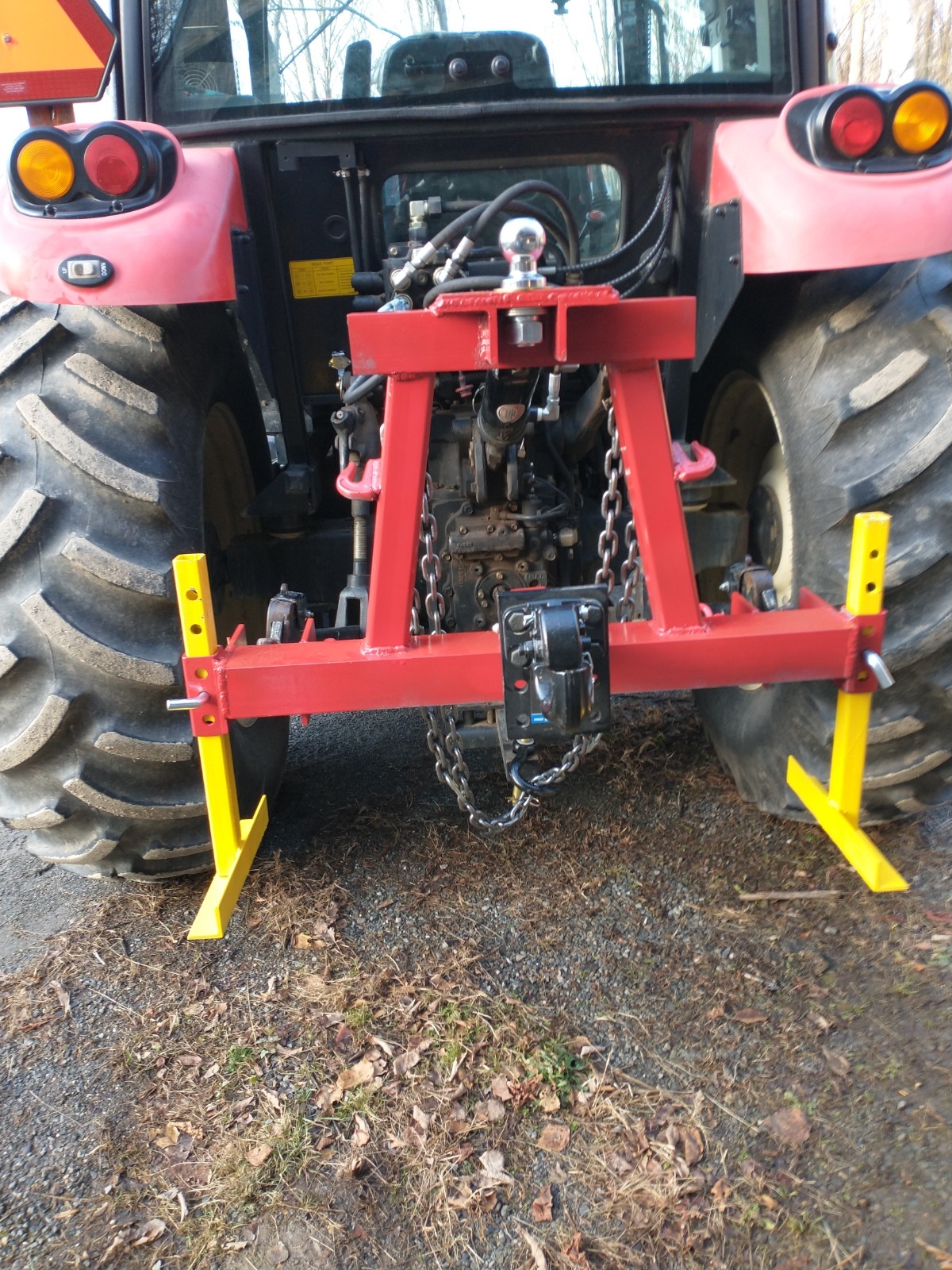

This is what I use to pull my trailers and some implements around. It has two receivers the top I use to attach a trailer carry all and the bottom I put my ball in and it works flawlessly. I wired a 7 pin round connector to it so I can hook up any trailer and use all of the features (brakes, lights, signals, ect.)
