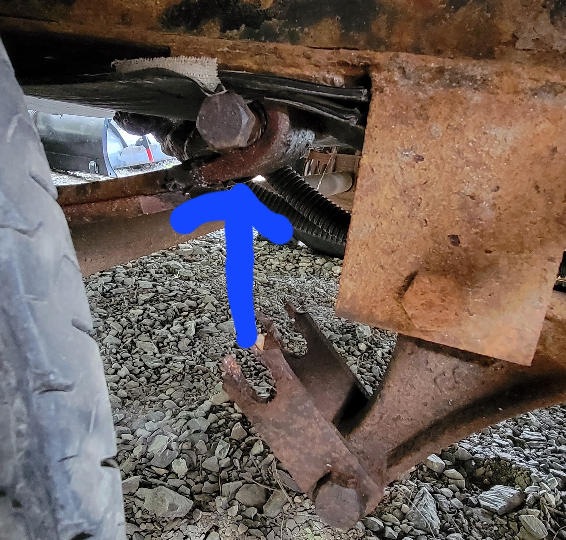

I use my tractor to spin my RV in our upper driveway so I can back it into its parking spot. Driveway is gravel, and I use a 3 point receiver to attach it to the tractor (The pivot spot is flat). The RV is 35 feet long with dual axles, and probably between 8 and 9K lbs depending on what is in it.
Before a trip a while back, I was looking at the suspension of the trailer, and noted the rear tire leaf spring was resting on the frame and the shackle plate connecting leaf to equalizer had sheared! (see photo)
After the repair I got to wondering how this could have happened. the next time I was spinning the RV I noticed that the act of spinning the RV in place was putting side torque on the tire (one wheel was pushing inward, the other outward). I am not 100% sure, but I think this was the cause of the shackle shearing.
All this to say, if you are trying to turn a dual axle trailer 180 degrees (using the 3 point or FEL), Keep an eye on any sideways pressures being put on the suspension system!

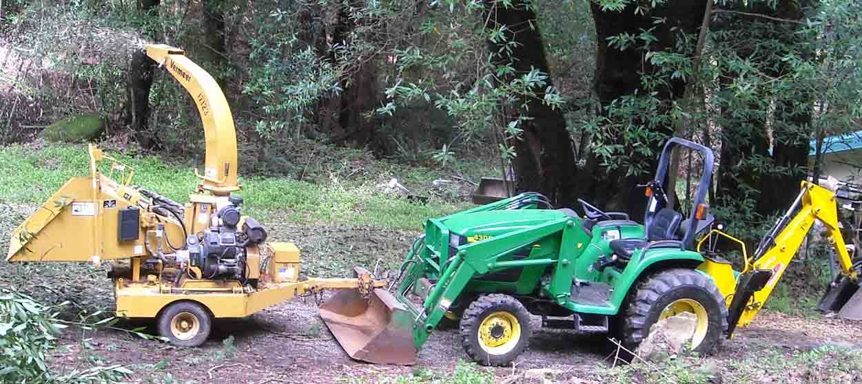

I do what you describe, and my paved road is 15% grade, measured, for hundreds of feet.
I have pulled and pushed with my FEL my flatbed dually trailer (1500#), 2 towable manlifts (2500#), and the chipper in this photo (2500#).
Turning sharply on this kind of slope, even on pavement, is to be done very carefully, and always in 4WD, low range. Jackknifing is a real risk. That noted, my tractors were 2x or more the weight of the trailers, 5000-5500#.
I did go off my pavement pulling/pushing all 4 of these machines, and did go on steeper slopes, but it got too dodgy to do any significant turning on the slopes. Better to pull uphill, vs. push.
I prefer a bolted-on ball, or welded-on receiver. My Kioti's forks can attach a dedicated custom trailer-tender that works quite well.
Be careful.
