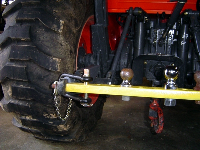

Has anyone made a bracket to keep the trailer hitch (that piece with all the holes that fits across the quick hitch) from rotating? I want to use it to pull boat trailers and thought some of you may have already made a quick solution to this problem.

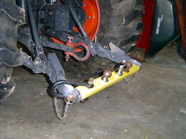

I welded a little dimple on one of my drawbar arms and used a shackle to keep it from rotating. The dimple keeps the shackle from turning off the drawbar. Cheap and simple and you can use the shackle for other things, too.

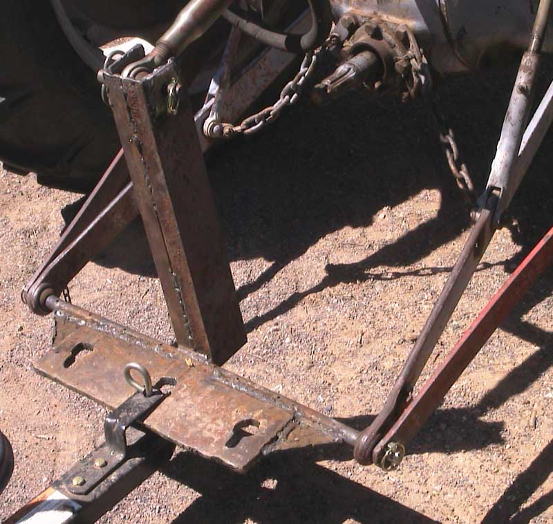

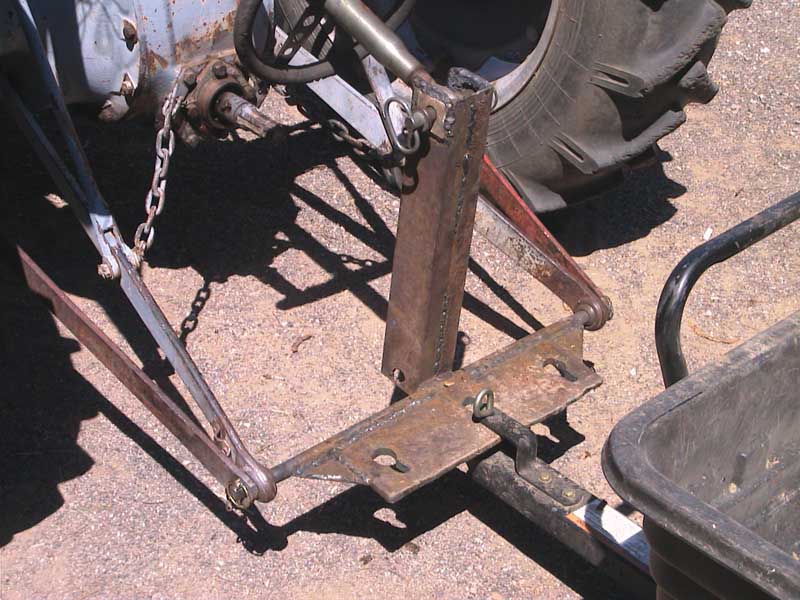

Here is a quick built draw bar. Key holes for chain or "T" hooks, room for 3 balls or use it for a simple pin on. It's on a 50's Fergie and has pulled mt 1,500# roller. About 2 hours from start to finish. :thumbsup:

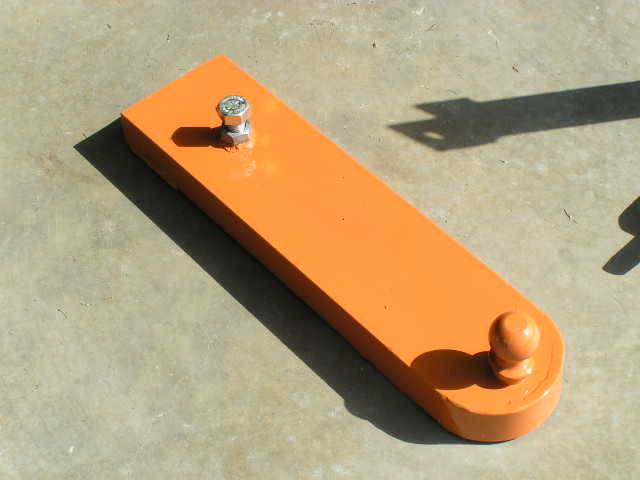

Here is a pic and material list of what I slapped together back in '01. I can see my total expense was just under $18 and an hour or so to build it. I've since made several different styles including ones that work on gooseneck trailers. I can't remember the last time I used it though after I got a set of forks for my tractor and have a forklift. The 2nd picture is somthing I use hundreds of times per year. It sure beats burning a hole in a perfectly good fork and bolting a ball on the fork! It took me a couple of hours to design that and weld it up. I can put it on or take it off in just a few seconds with no damage to my expensive forks.

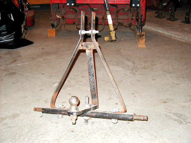

Oh, well, I'll put a picture of the one I made, since it was just scrap material I had laying around the shop.:laughing: I wanted to move the ball back from the drawbar a little so I could turn shorter. I used it quite a bit, but never did get around to cleaning it up and painting it like I intended to do.:laughing:
Now that is an enlightened solution!
I did something similar to what others have posted (but unfortunately not the slick idea Dave provided), see below.
8' of 2"x2" angle, some quality time with the welder, a couple bolts, one hook and a hitch-pin and I was done.
