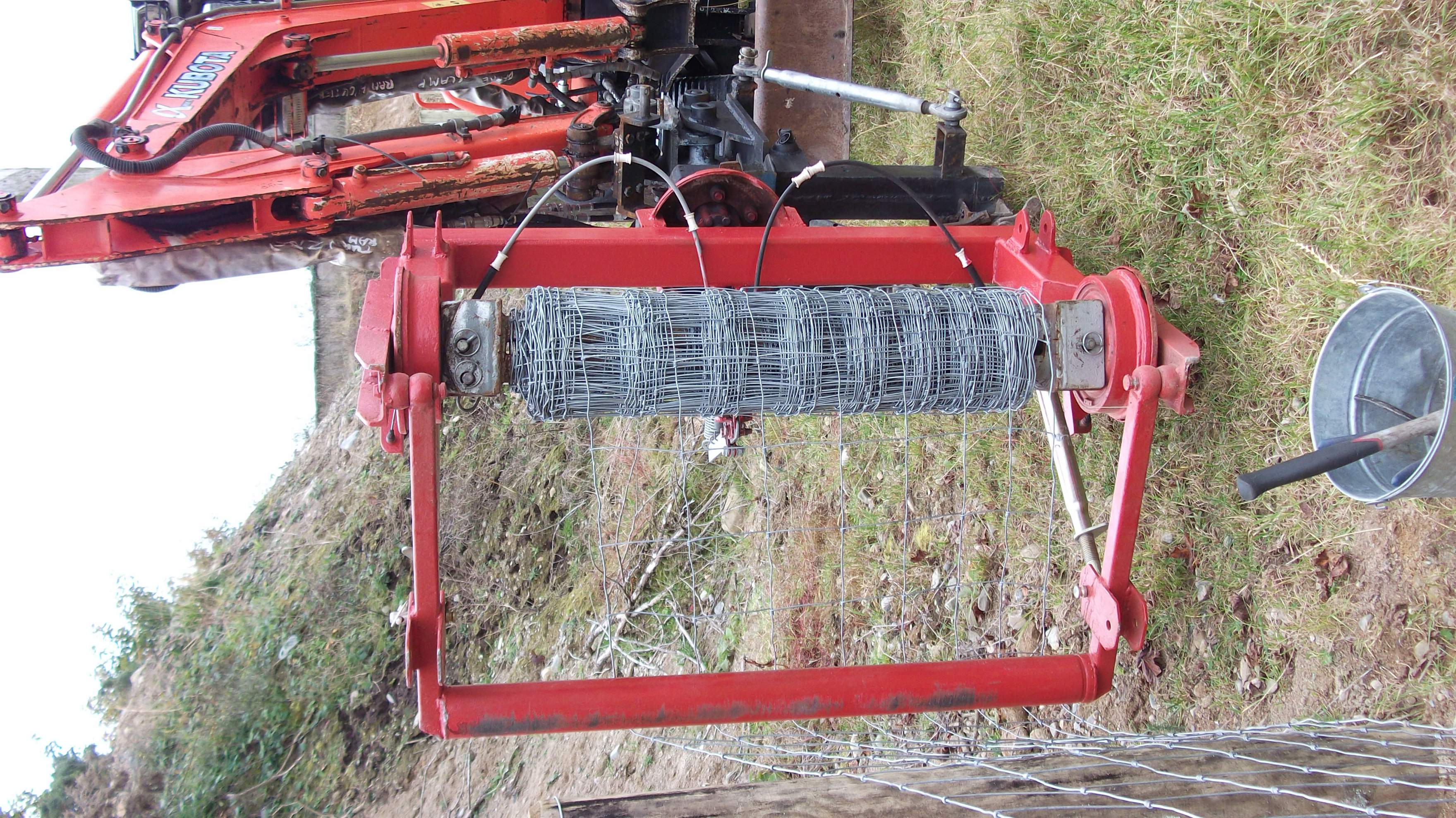

Two homemade items here.
ry%3D400
1st is a 3pt receiver hitch....simply a copy of one sold commercially. Quite useful to move anything in the way of a trailer/etc.
2nd is a something I did come up with to roll off field fence wire. Piece of 2" square tubing (to go in the the receiver hitch hole ), then a piece of flat plate , and a 3' piece of 2" pipe welded at a 90 to the plate to act as a "toilet paper holder" for the roll of wire.
To load a roll, I remove the top link of the blue hitch, and raise the lift arms as high as they will go, this puts the 2" pipe about 15 degree angle from the ground, slide the roll on, and tilt it forward, reattach the top link pin.
Worth building if you have a lot of field wire to install. I attach the start of the roll to a post, and simply drive down the line of posts. Throw a crow bar or piece of 3/4 pipe in the roll at some point to keep it from turning, and use the tractor to tension the wire ( very gently ! )
Later modification was a piece of 3/4" plywood on top the metal plate at the base of the roll..the roll would hang on those square corners of the metal plate, so I cut the plywood in about a 24" circle and screwed it to the plate. Solved that problem.

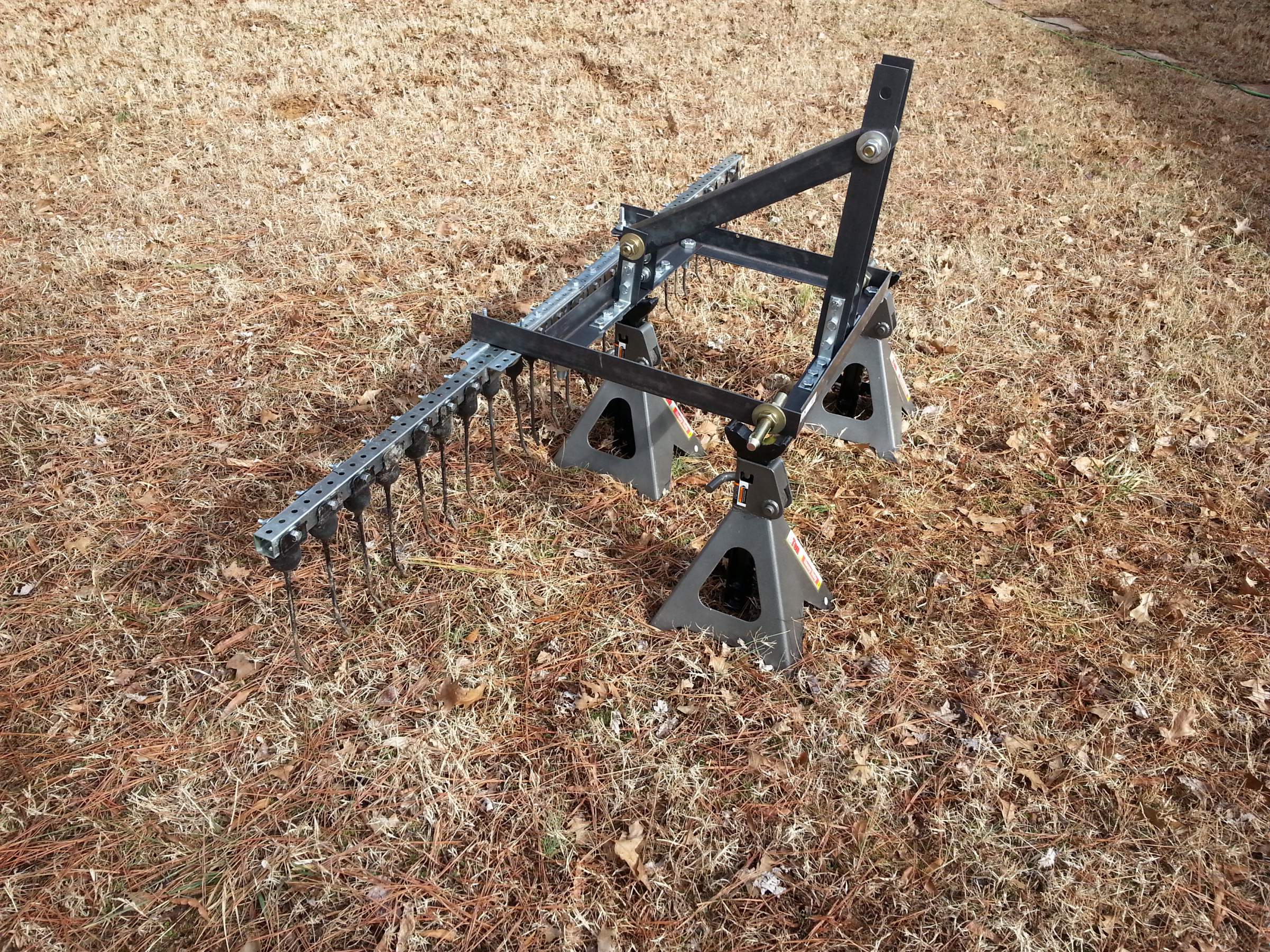

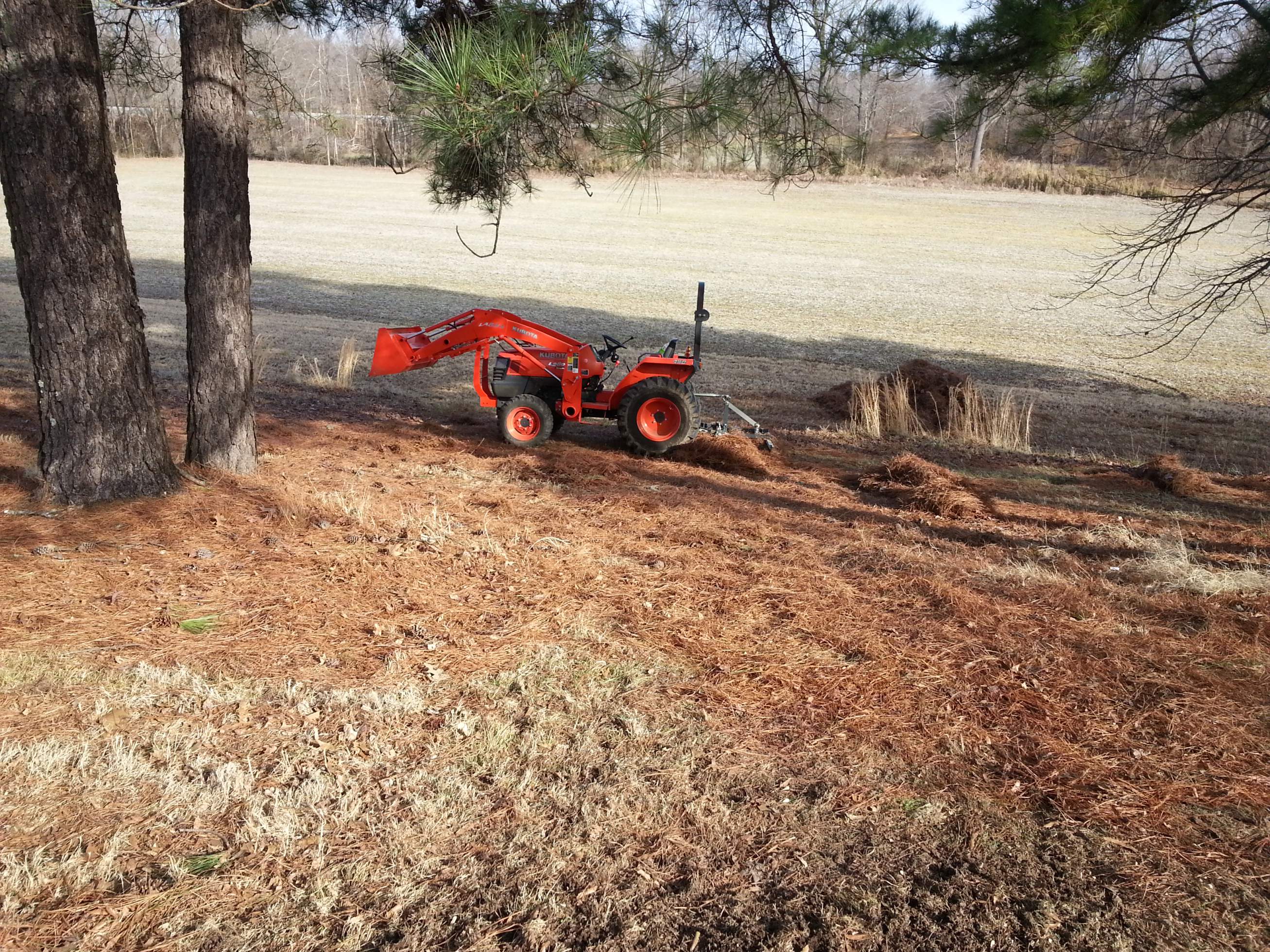

I've steadily worked, weather permitting, on the mods for my yard/pine needle rake. I added tines to get the spacing to every 3 inches and built a 3pt hitch so I could raise it higher to get it out of the pile of needles I just raked.
1., 2., & 3. 3pt hitch I made
4. & 5. rake on tractor
6. &. 7. before raking
8. some raking done
9. pile of pine needles 10ft in diameter and 3ft high. About halfway done on this side of house. I have a pile similar in size on the other side of the house.
10. after raking

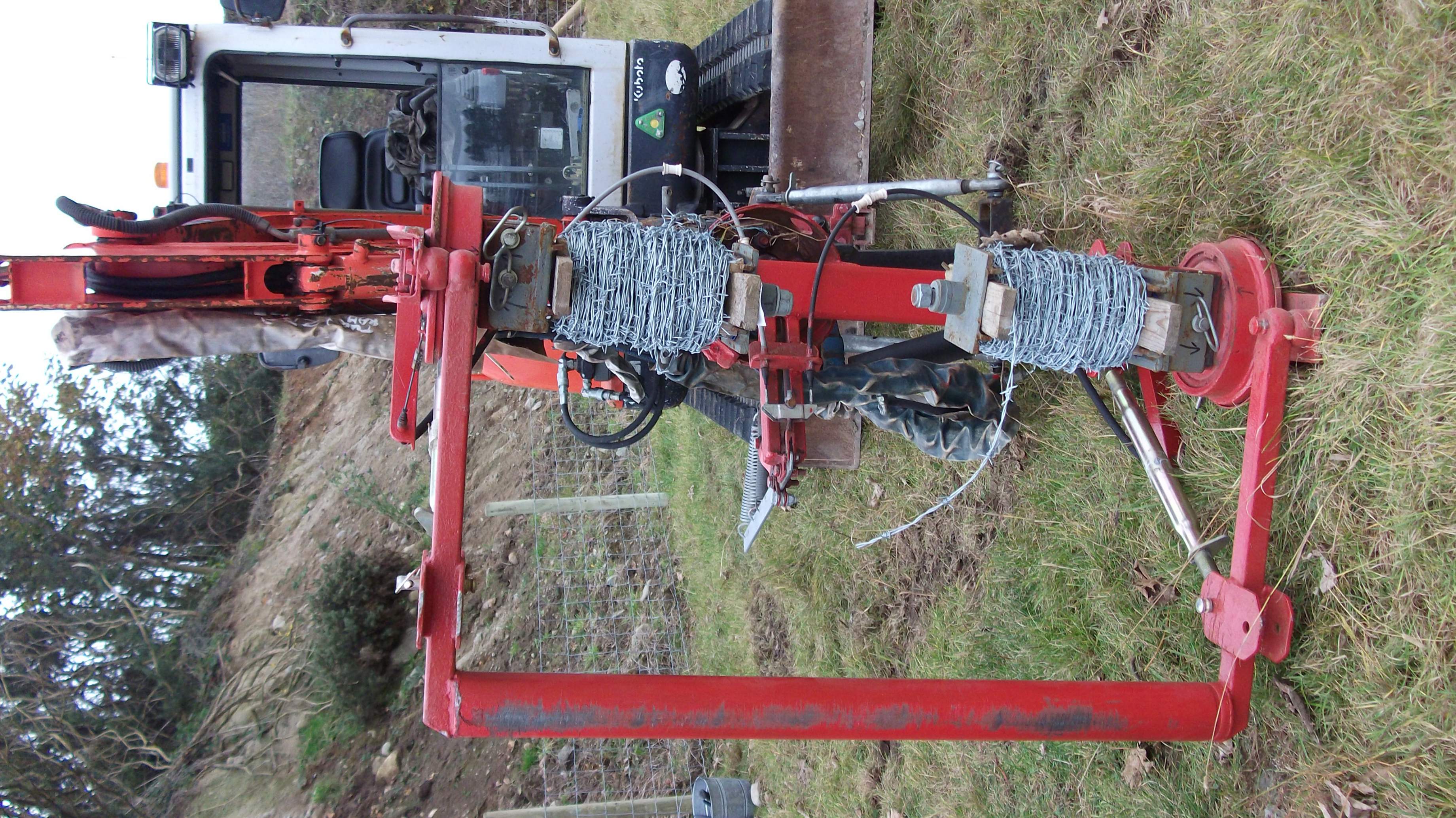

ry%3D400
