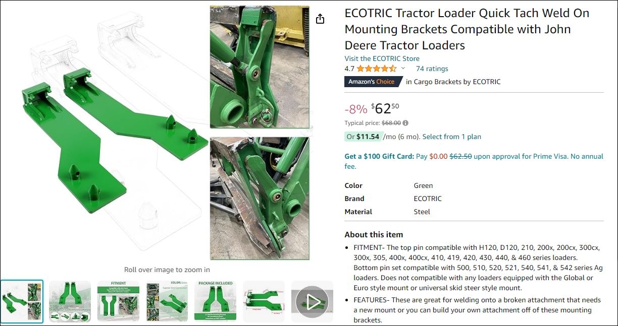

Iam looking to add a quick attach conversion to my model 75 loader on my Deere 850 tractor.
Was wondering if anyone has done this and what I might want to watch out for. Was considering purchasing
A weld on unit from one of the Chinese manufacturers or are these junk? A Pin on unit made specifically for my loader is just way to expensive.. your thoughts?

I found a kit from J.D. with it's own part number for this conversion. Works great on my 80 loader, even the level indicator. I bought a new bucket, forks, a hay spear, tree puller, a grapple, and extra plates from Amazon to make a snow plow mount and a front loader mounted hydraulic PHD that only uses 1 loader arm.
I only had to narrow the curl cylinder collars by a mm to make it work. A grinding wheel and 5 minutes was all it took.

You are looking for a skid steer quick attach (SSQA) conversion, and yes, the weld-on kits from overseas are way cheaper.
