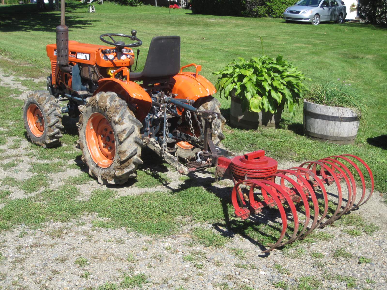

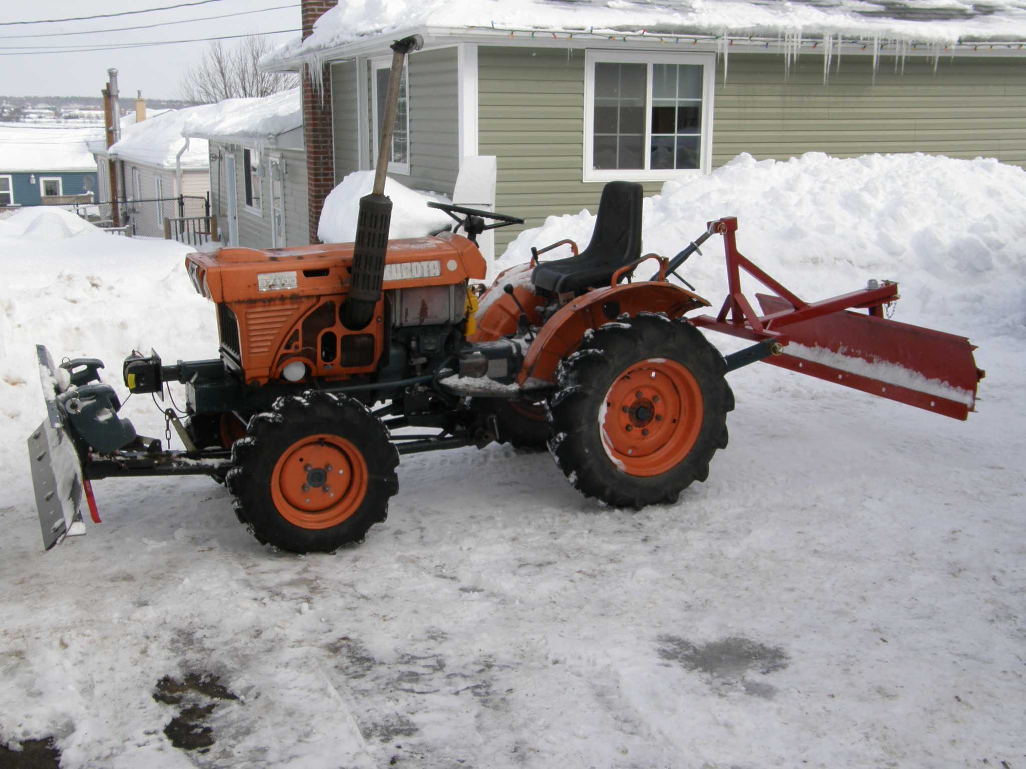

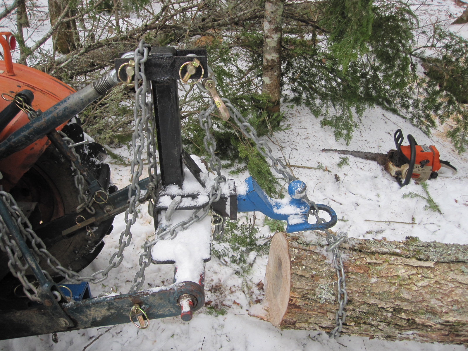

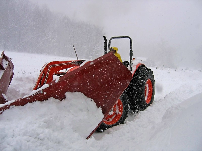

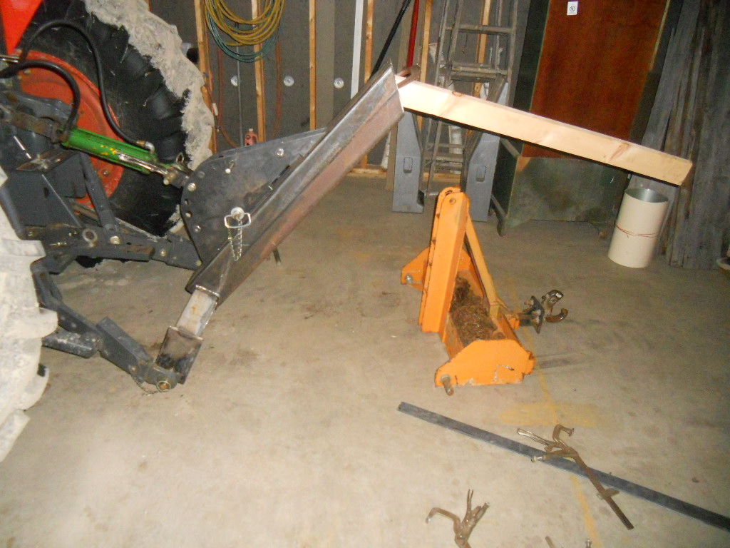

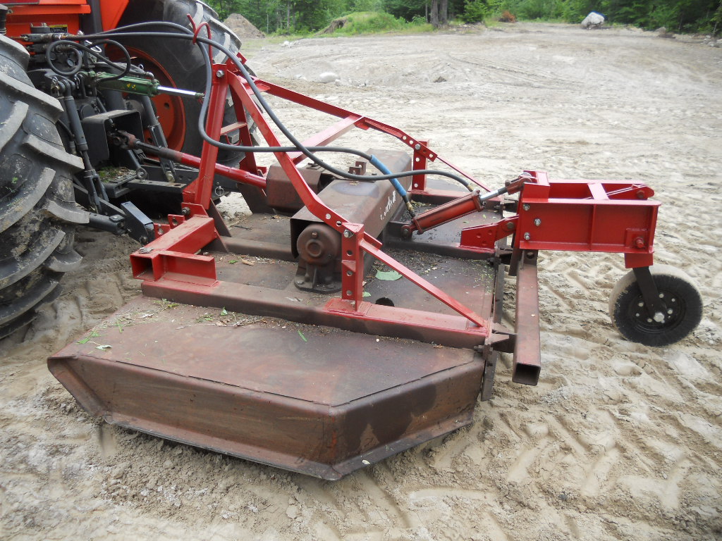

A few more, I adapted the Vee blade to fit a SSQA. Modified my old 8' pull behind mower to 3 pt. with a hyd. adjusted tail wheel, and built the bucket for the SS. Right now I'm working on something to lift and drag logs out of the woods. I really can't justify the price of a 3pt. winch, and I'm thinking that this will do.

Rustyiron, a couple questions:
The hyd tail wheel.....Is the linkage to keep the pivot pin in proper vertical alignment as you change heights?
The V-plow....Looks a tad oversize for the tractor...did you do it just because it was sitting there and you thought, hey why not?
I definitely like the crane arm & roof rake
/ Home-made attachments... #204
Exactly
Yes, there is some "hey why not" involved, but it really works well if a heavy storm get's ahead of you, and beats the heck out of my straight blade in the deep stuff.
Thanks.:thumbsup:
/ Home-made attachments... #205
Love that big V-Plow.

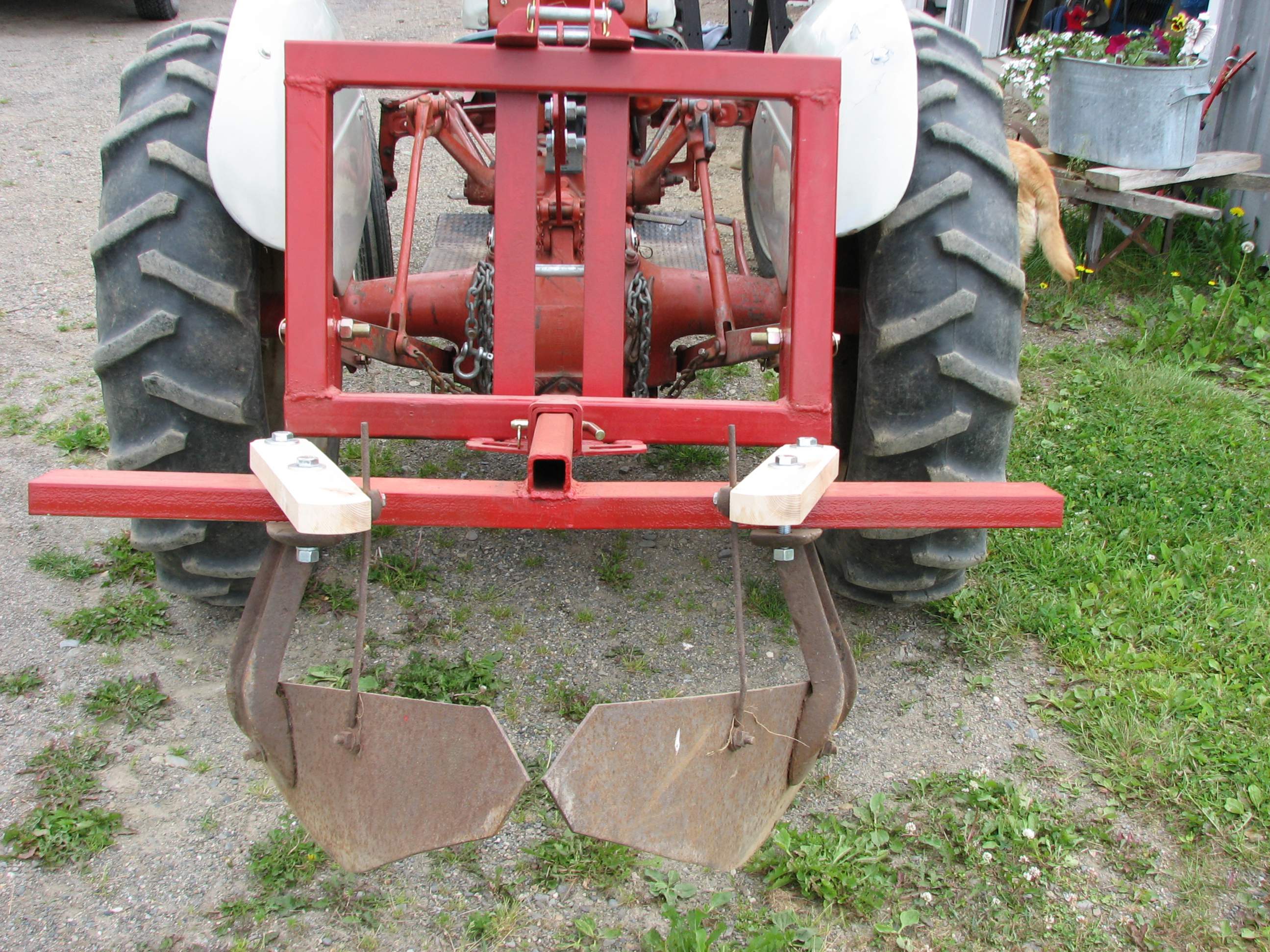

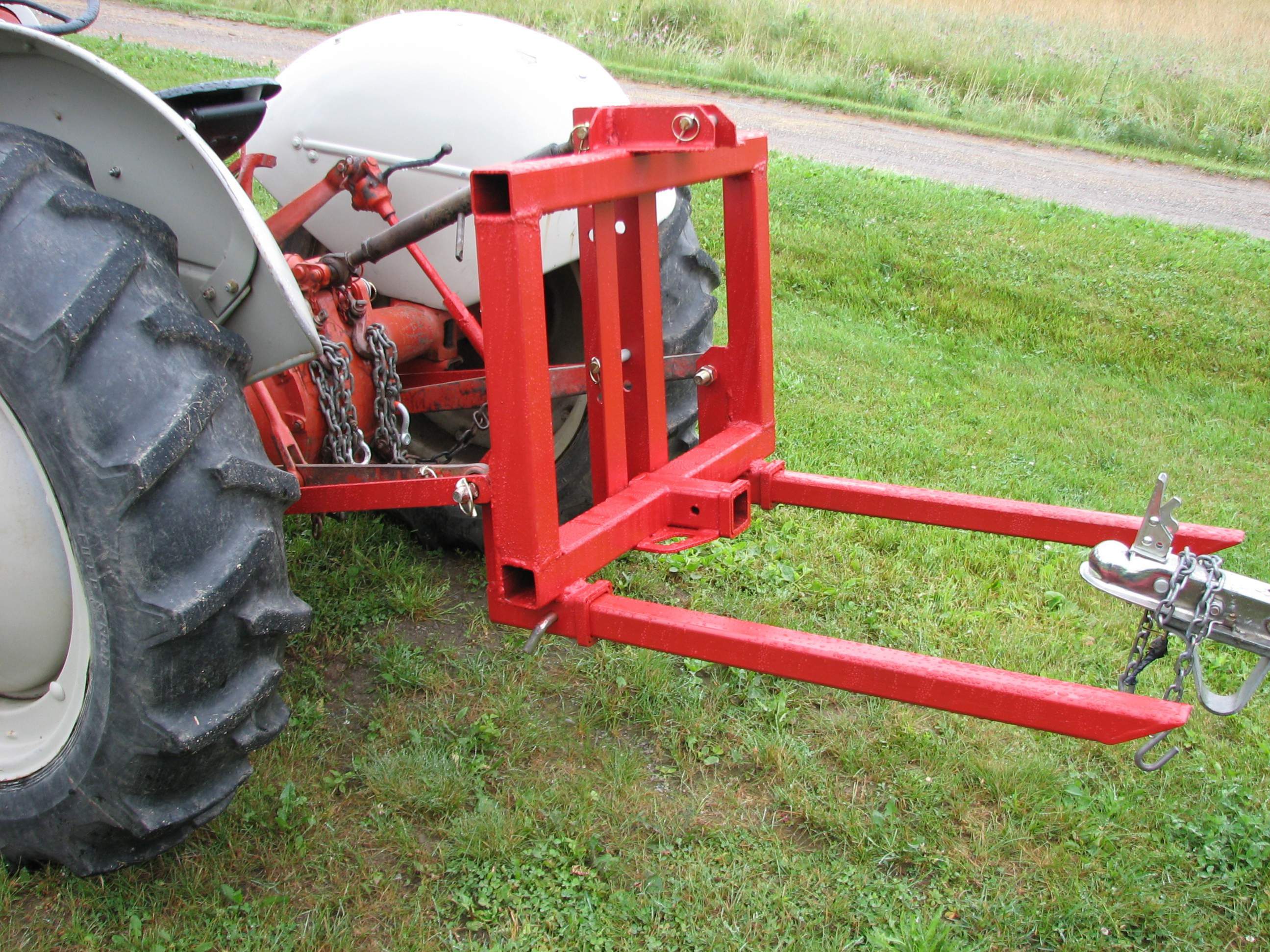

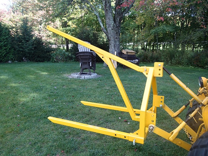

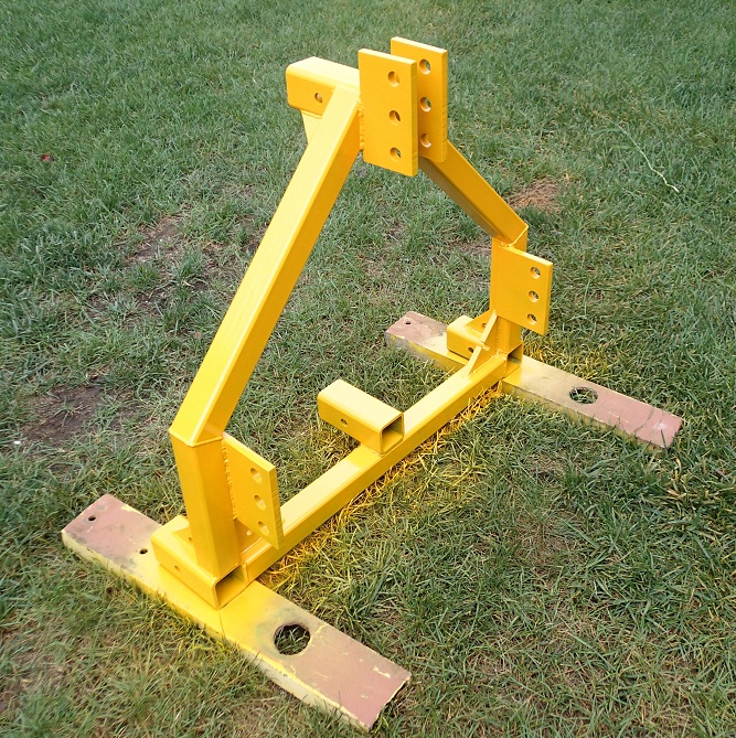

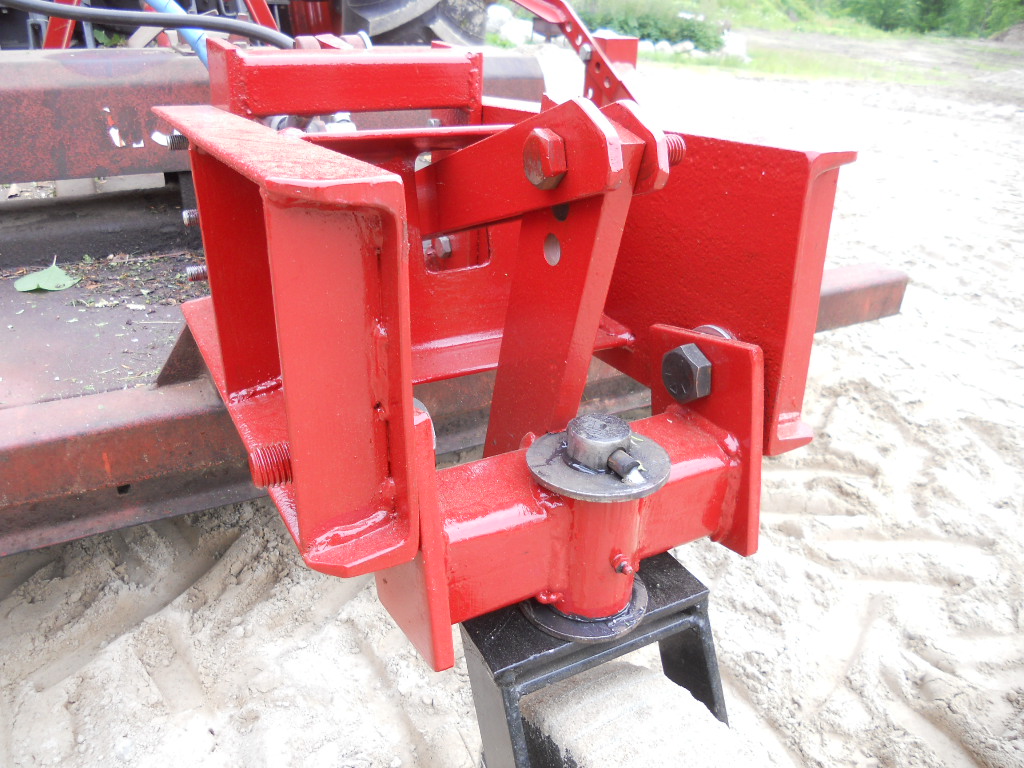

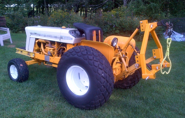

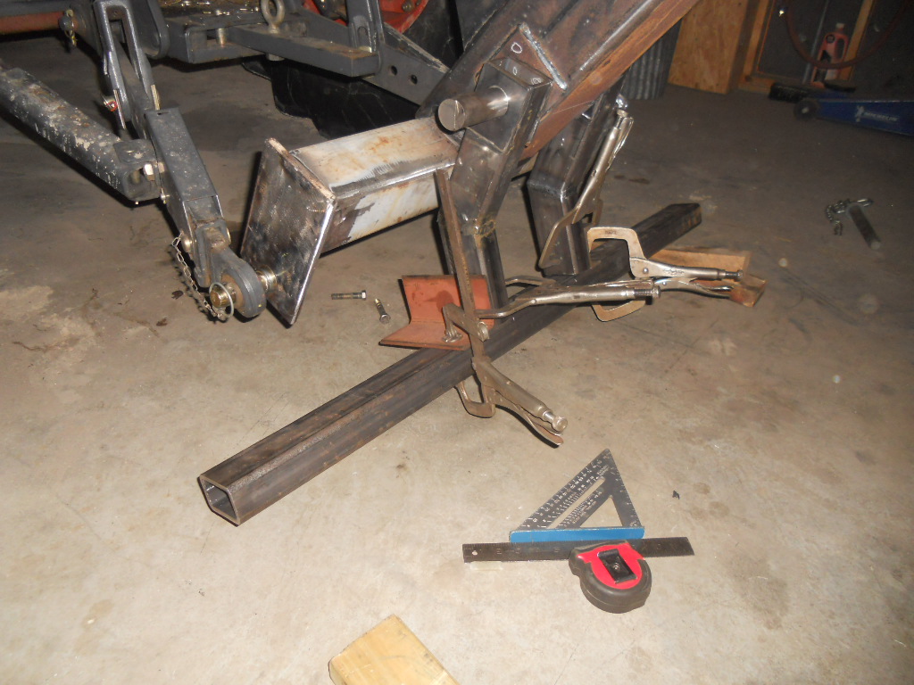

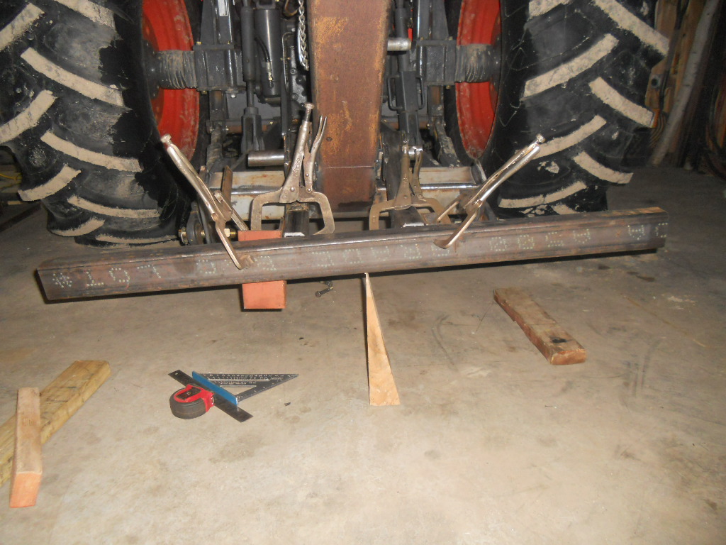

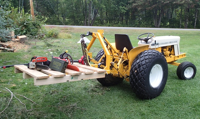

I made this multi hitch for my lo-boy. Can be used as a trailer mover, fork lift, log dragging frame and even a boom pole mount.

Pretty nice unit you made LFEng. I like it.
/ Home-made attachments... #214

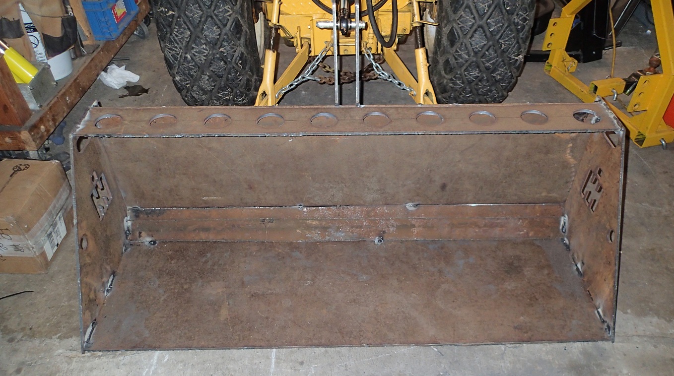

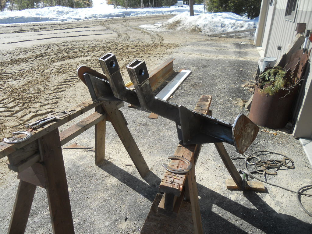

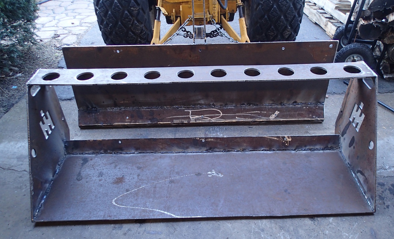

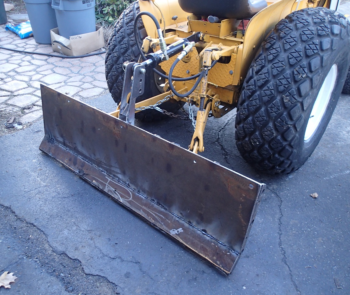

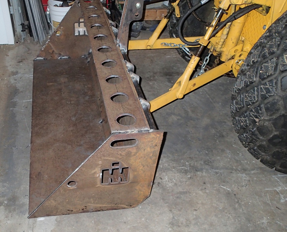

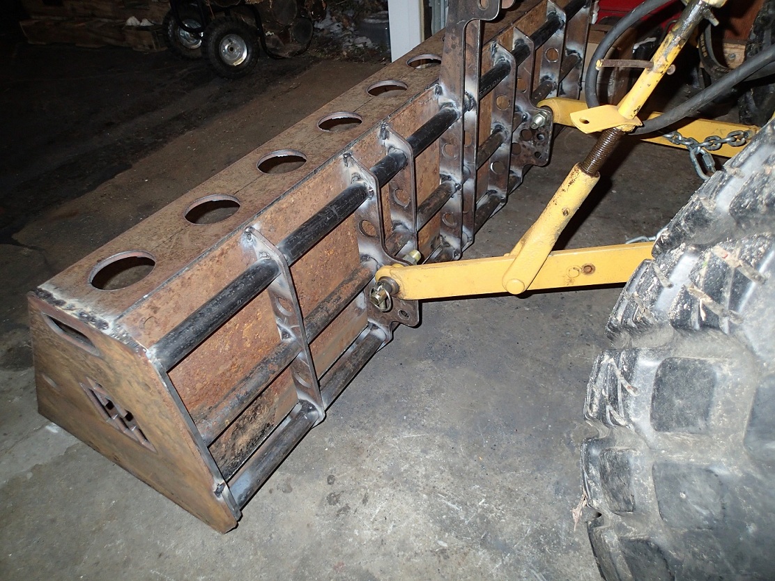

If you couldn't tell from the multi-hitch design I like attachments that have more then one purpose. My next project is the plow/bucket. Bolt the bucket section to the backing plate and it'll lift 350 lbs of whatever you can throw in it. Replace the bucket with a cutting edge and it'll be ready to do battle the worst New England winters.
It was assembled and put to work last week to help my father-in-law fill in an old pool foundation. I plan on cleaning the edges and painting it when it gets back to the shop.
The original design called for 1/4" plate, but my supplier said he's sell me a 5' x 8' piece of 5/16" for the price of 4' x 8' 1/4" if I'd take it with a little rust... So I did.;) Only downfall is she's a little bit heavier then expected. Tipping the scales at 300 lbs empty I had to do everything I could to cut weight, which is why I CNC plasma cut the chain holes, hand openings and IH logo into the bucket.

Love that rear bucket and the multi-hitch! Great stuff.

Would I be right to guess that your hyd top link will extend far enough to dump the bucket?

CDN Farm Boy: Depending on material and pin setup the bucket dumps 75%. I would be nice to have full dump, but I'd loose most of the curl with the current cylinder. I've found a few nudges with a flat shovel help the remaining material out of the bucket.

I must be missing something! What keeps the plow attached to the bucket?
Or is it welded as one.
