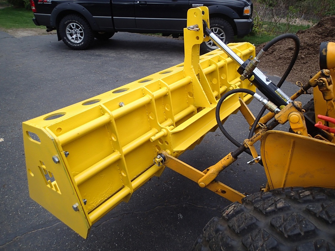

Cool looking grader. Is he happy with how it works. Looks like the blade may be a bit too close to the rear wheels.
/ Home-made attachments... #225
He loved it before the change to the jd blade and quick attach. He took it up and down the driveway once after the change, found out the pivot pin/bushing are worn out a bit far so he gets washboard easier. We'll get rid of the play at the pivot and try again.
/ Home-made attachments... #226

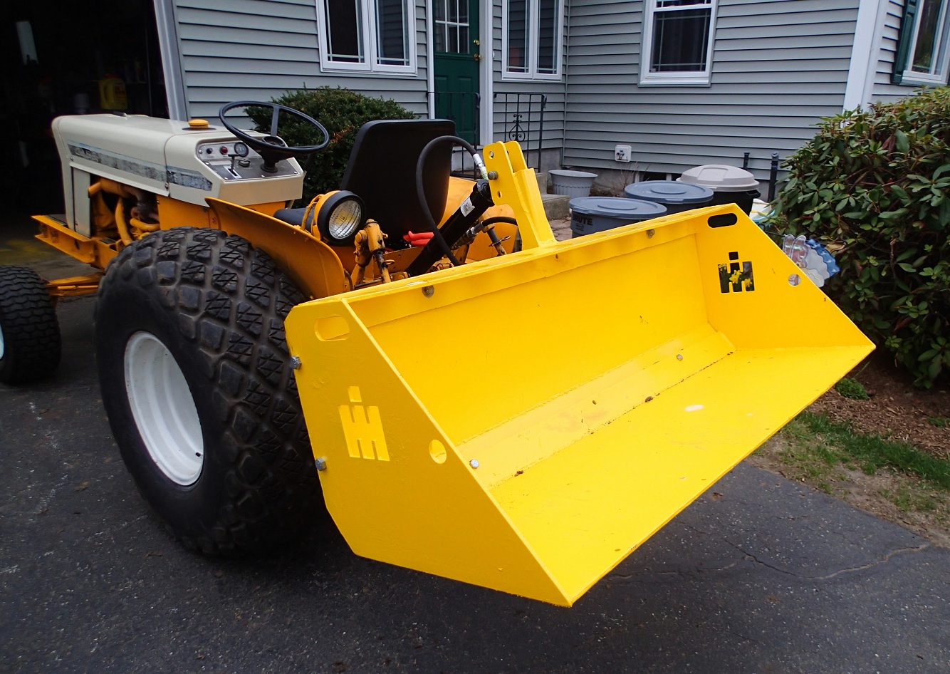

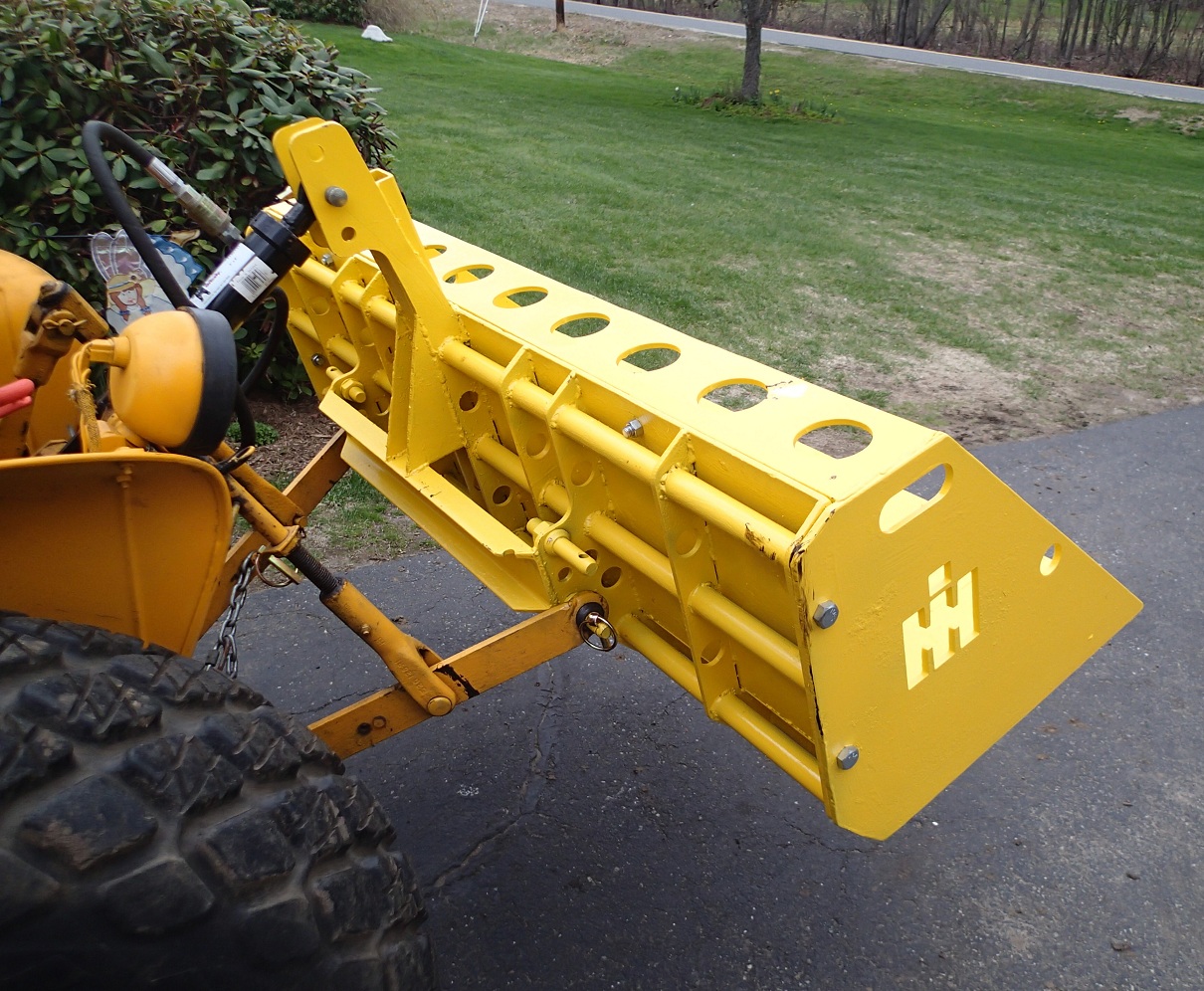

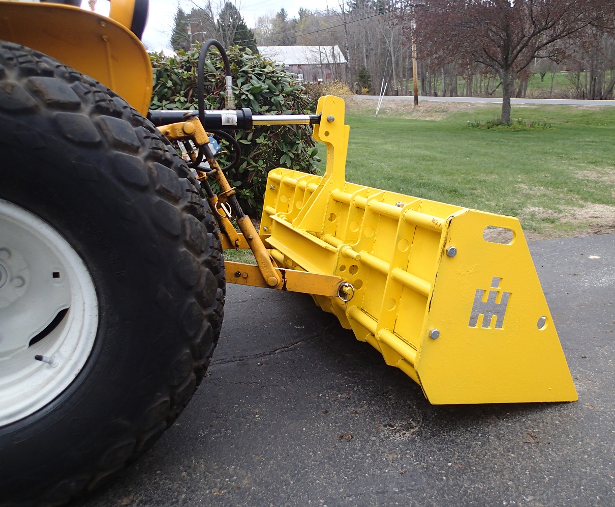

Good eye. It's welded on in the picture, but I did that just as a mock-up. The finished design (pix coming soon) uses two 5/8- bolts on each side plus four 1/2" bolts across the face to attach the bucket to the plow.
I must be missing something! What keeps the plow attached to the bucket?
Or is it welded as one.

As promised, here are a few pix of the finished plow/bucket.

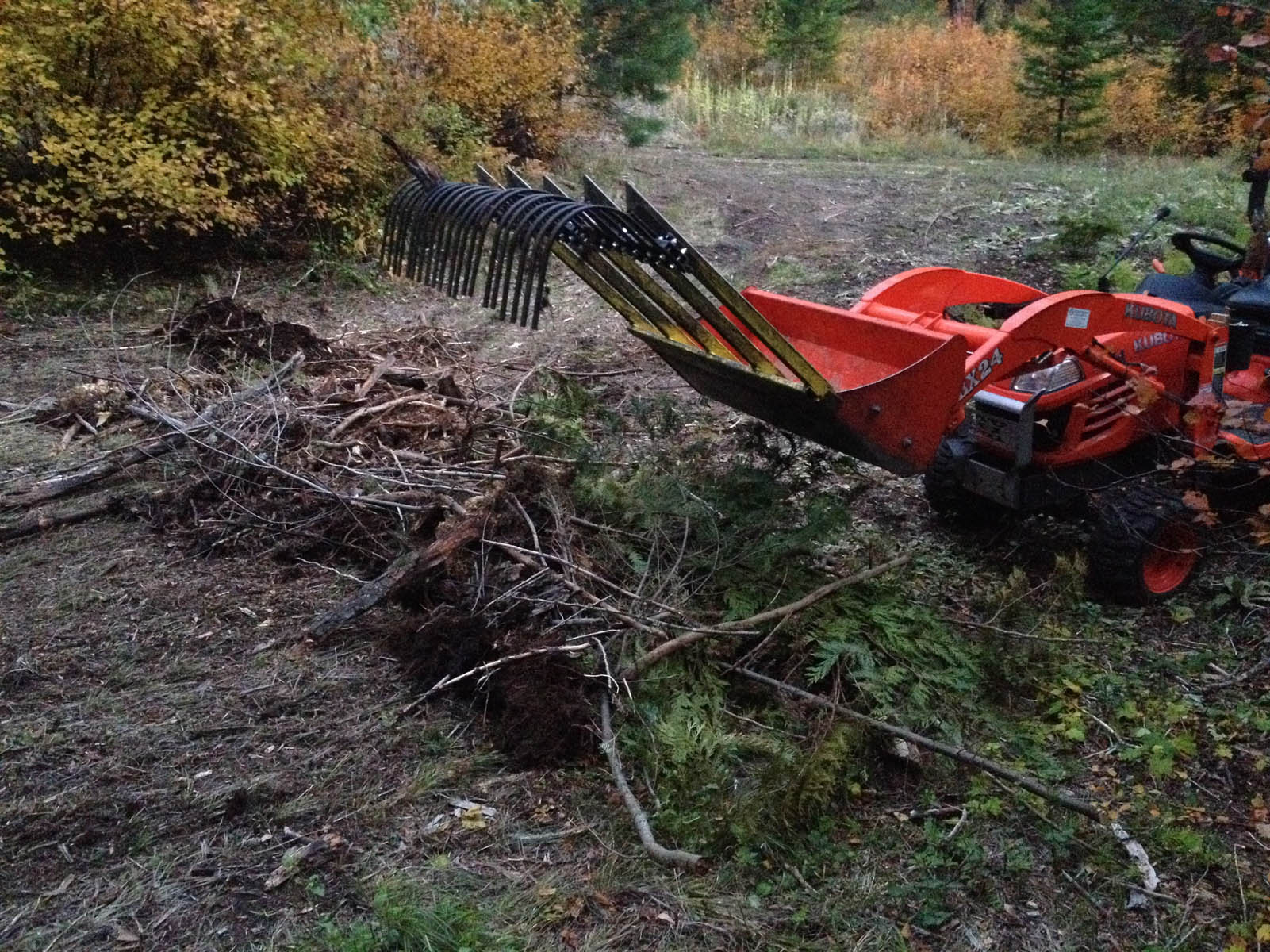

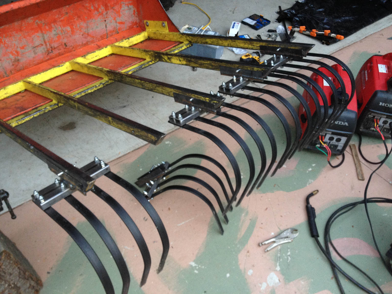

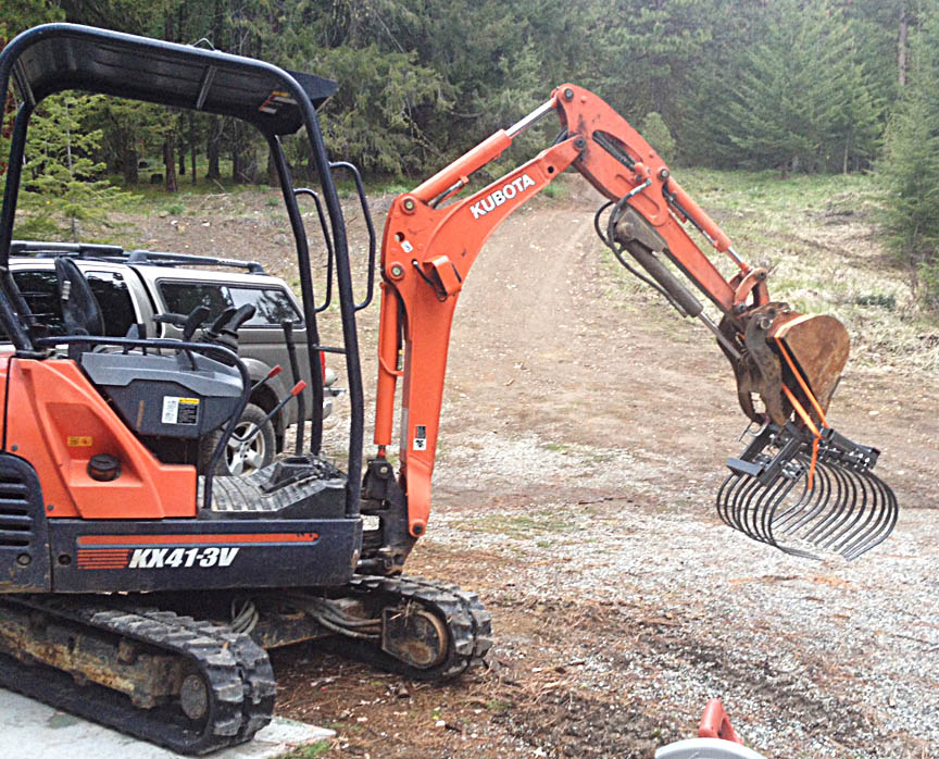

I made a brush fork for the Front End Loader of my (sold) BX-24 tractor, it became my favorite attachment.
Then I made 5 mini-stick rakes that pin onto the tines of the brush fork.
374056d1399422460-home-made-attachments-forkrake_pile-jpg

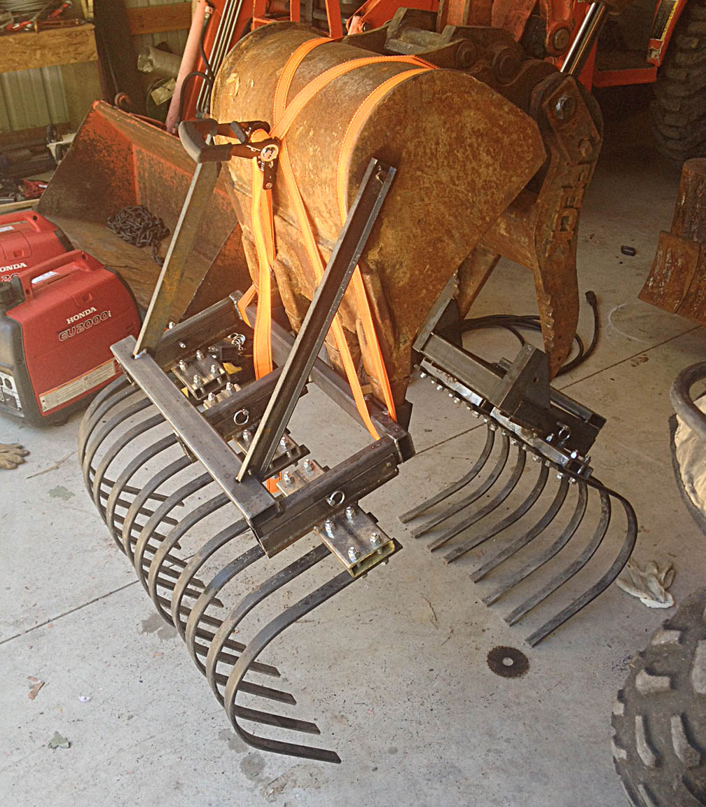

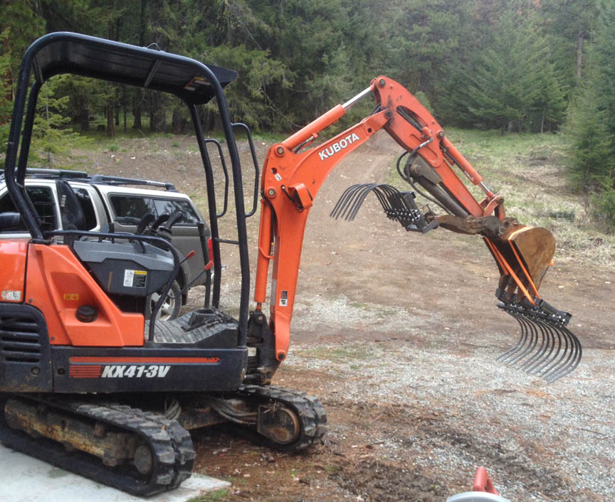

Then I got a mini-excavator with a thumb.
Recently started adapting the mini-stick-rakes to the excavator. Not tested yet but hoping be able to rake up sticks like its nobody's business! ….and drop them on a trailer…..then tow the trailer (with excavator) to the burn pile……and toss it on the burnpile with the X! Fun stuff?
374060d1399422827-home-made-attachments-kx41_stickrake__testing_open-jpg
374059d1399422794-home-made-attachments-kx41_stickrake__testing_closed-jpg
