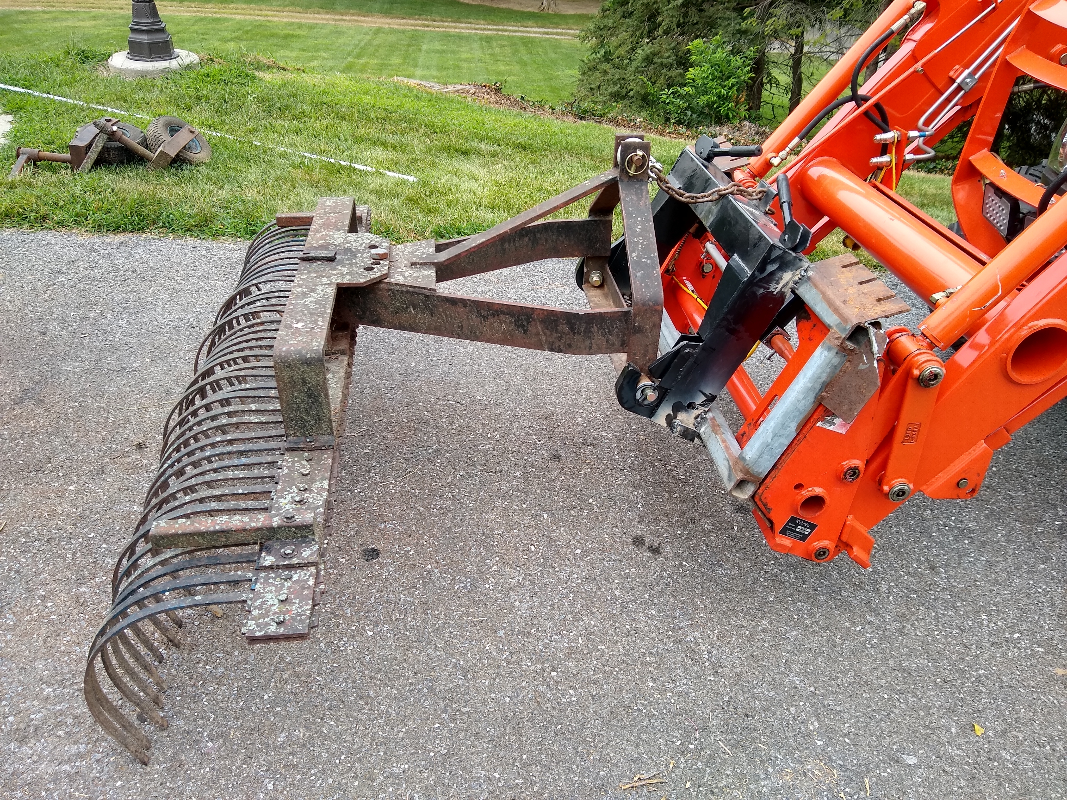

You may want to wait till you get a 3 point implement. Perhaps wait till you have more than one 3 point implement. The main reason for having a QH is to make swapping implements easier. Unless your first implement is something you want to install and remove frequently, why bother with a QH at all?
Just my experience, but it hasn't been too challenging to swap implements without a QH. I bought one shortly after buying a new tractor in 2002. That tractor was replaced in 2012 and that tractor was replaced in 2018. The QH sat unused in the shed through three tractors until very recently. It was obvious the QH wasn't ever going to be used as intended by me, so it became a donor for a project. I made a QA frame to mount my York rake to reach into places like the fence row. The goal was to run the rake in and under stuff when backing the tractor in wasn't feasible. So a little work with the plasma cutter and welder finally made the QH useful. I have some other implements that could see use on the front of the tractor, but the main thing was the York rake.
EDIT TO ADD: The wheels have always been more of a bother than a help, so you can see in the background they've been sawed off. If I ever need to remount them, as they said in The 6 Million Dollar Man, we have the technology.
