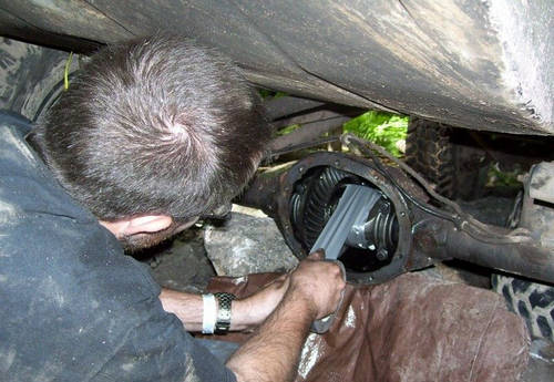

<img src="http://www.tractorbynet.com/forums/attachment.php?attachmentid=358352"/>
:thumbsup:

Looks like a Dana 30 rear axle under a Jeep Cherokee or Grand Cherokee to me??? :)

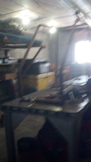

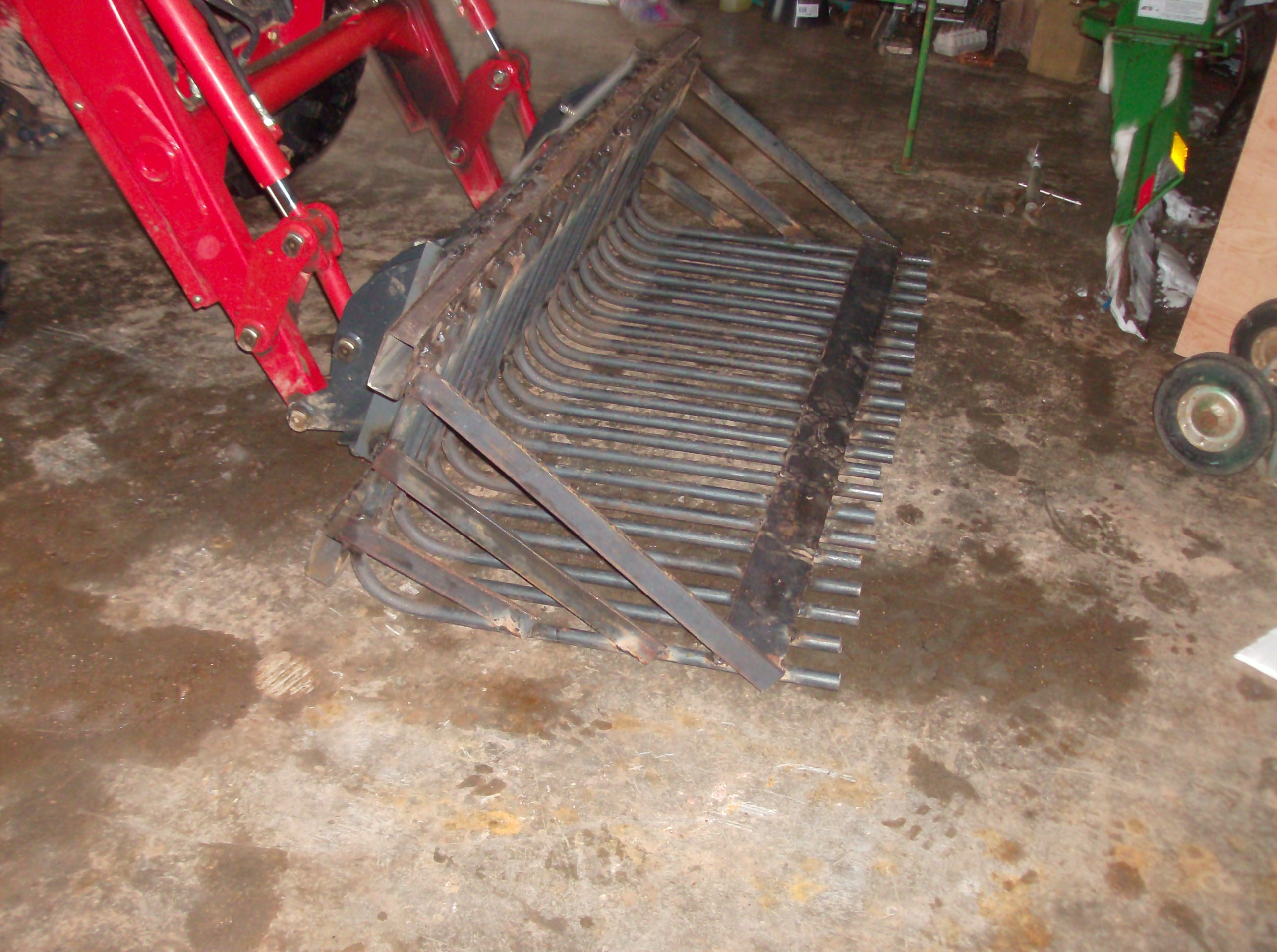

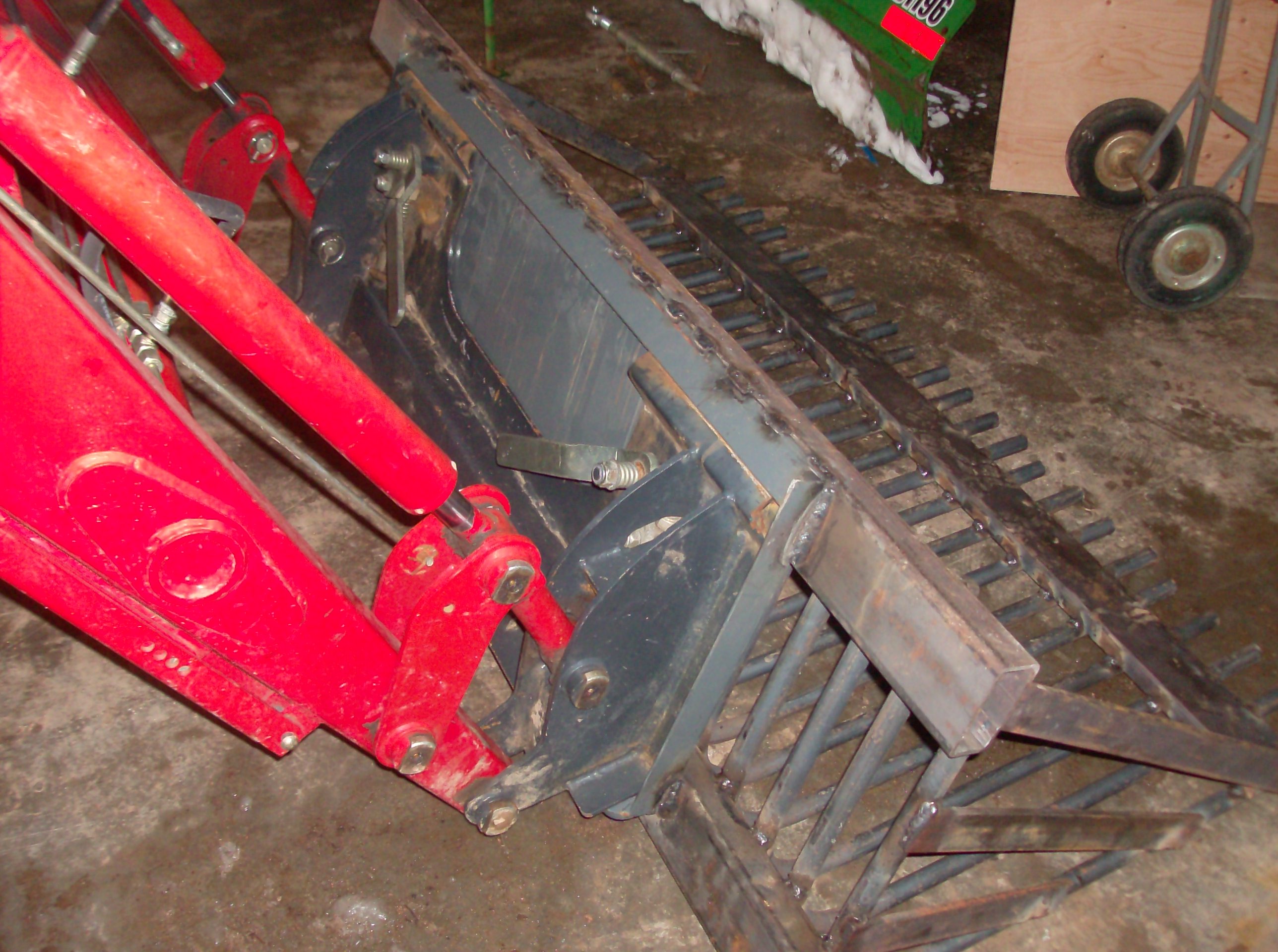

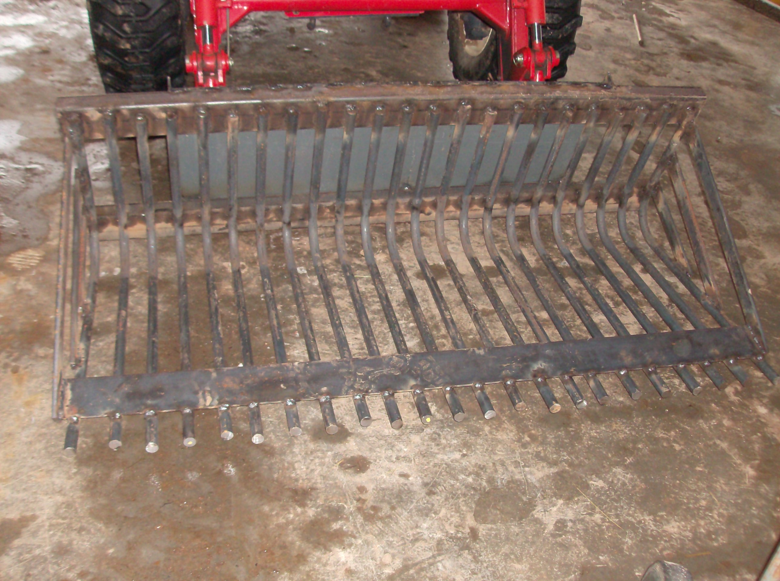

Clever rock bucket design, makes it possible to build one without expensive plasmas/etc. and just a simple bender! I might try that this year, how much solid rod did you end up using?
/ Home-made attachments... #138
I bought 5 20' pieces and have 8 'left over. $45 ea Spacing is about 2" Used 1" hot rolled (I think it was hot rolled . The cheaper of the 2, hot or cold rolled) Bought the skid steer plate for $100. Used 2x 4 tube for framework and 3/8 plate for the sides. I tacked it all together nd had a welder get it solid as I doesn't have a big enough welder.
Whole thing was $550.
Each of the bars took close to 200 pumps on the manual hydraulic bender.
The welder suggested a last piece welded under the front plate on the bottom for more support.
Last thing the bucket front is 2 pieces a 4" wide and a 1" wide to form a lip
