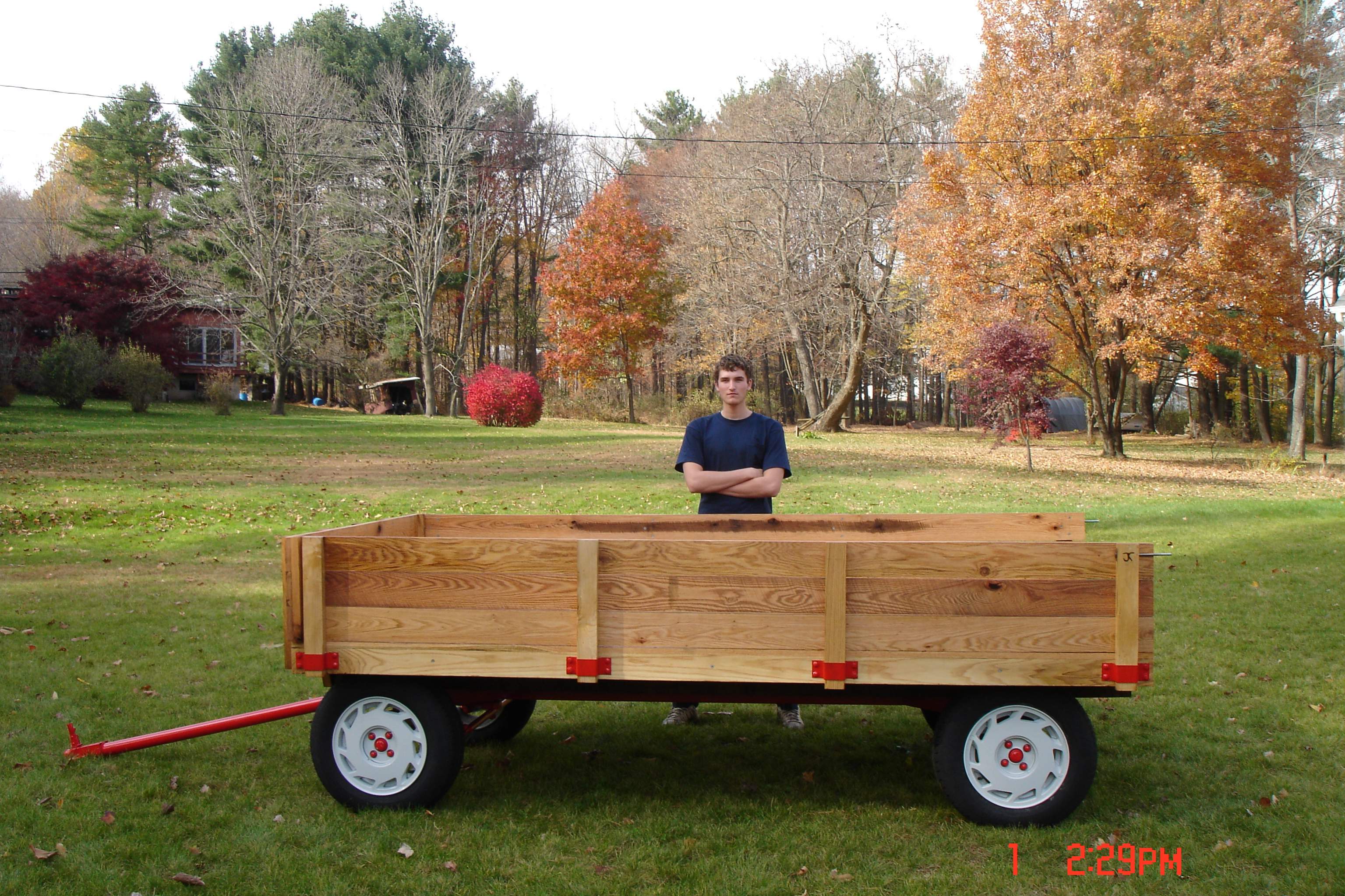

Thought I would throw in my hay wagon rebuild from this summer. I picked this "Electric ...." wagon running gear for $150 with froze spindles. I ended up splitting the spindle housings with 4 1/2" angle grinder and cut-off wheel. Then cleaning up the spindle shaft , then rewelding the spindle housing . Straightened the tierod , lengthened the wagon to 16' , it is my intention to use for hayrides .
Wood from a neighbors removed pool deck ... 2 x 6 treated. Main rails 2 x12 treated.

Very nice! The kids (young and old) ought to enjoy that ride.
/ Hay wagons; let's see them! #133
Great project and great hay wagon.
/ Hay wagons; let's see them! #134
Nice job. Did you paint the tractor too? I don't see any decals on it. Is it a WD?
/ Hay wagons; let's see them! #135
Thanks, yes it's a WD . Been working on restoring it for about a year now. I painted the wagon first , then
the tractor . I still have the fenders, rear hitch and loader to paint
/ Hay wagons; let's see them! #136
Nice job on the wagon and the tractor.
