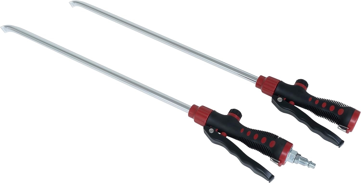

I agree with the above posts. Sounds like radiator may be restricted from debris.
I use these (radiator Genie)all the time and they help keep fins clean.
Those look like pressure washer attachments. How do you use them?
One attaches to an air Chuck and the other attaches to a standard hose. I use the same as pictured for my Kioti DKSE, the air wand let's you get in behind the radiators and blow out, works extremely well
Do you like a particular brand? The ones in the photo?
Whoops! Radiator Genie brand! Thx!
