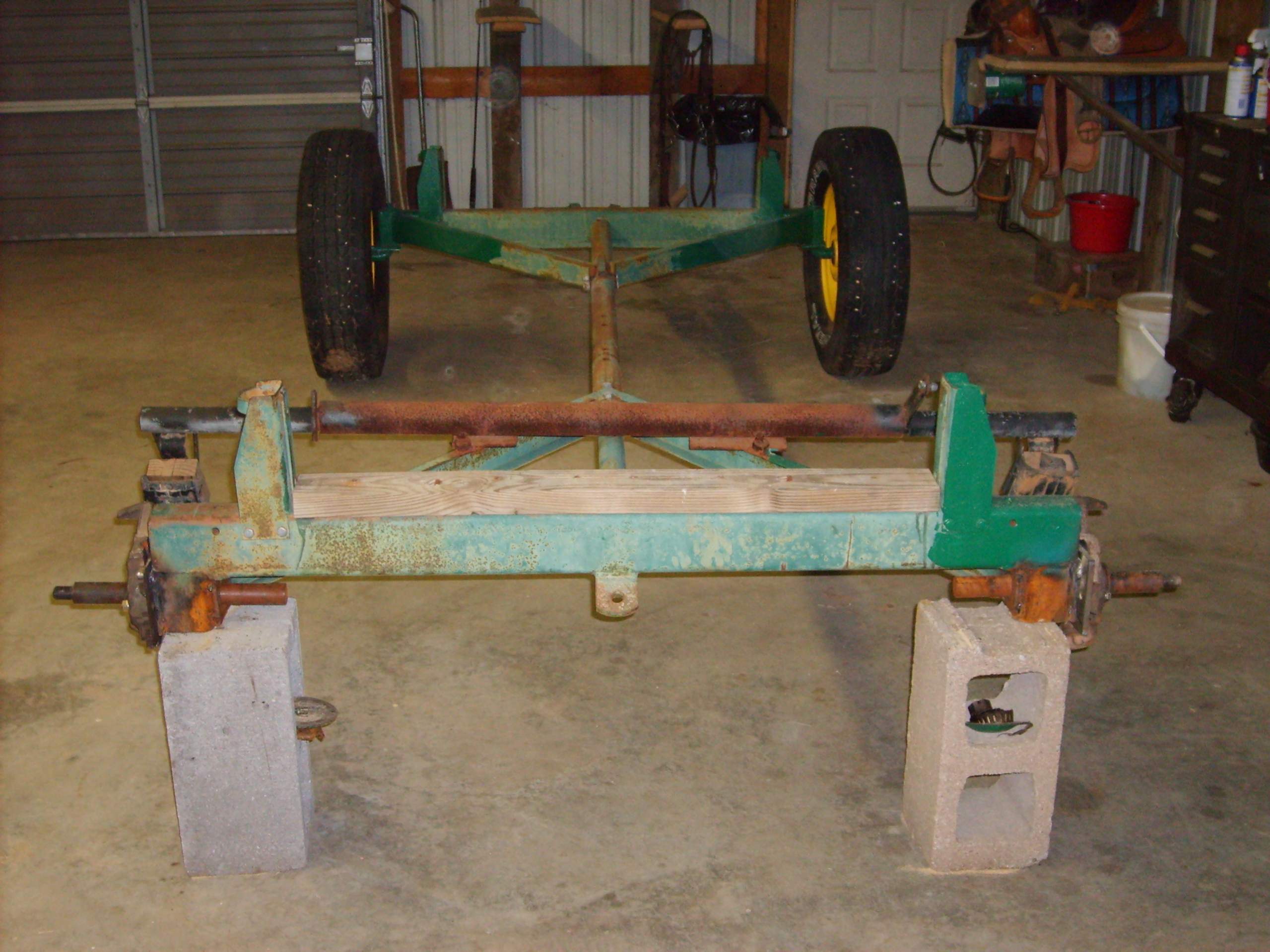

I just picked up a Gehl running gear; not sure of the model but it's about 12' from axle to axle (adjustable) and about 6 1/2' wide from tire to tire. I am going to build a wooden/steel body on it for hauling small square bales. My partner has a similar set-up and the body on his is approx. 15' long by 9' wide. I can copy his pretty much, but I was wondering if anyone knows of any plans available that would be helpful. Also, I'd love to see some pictures of what other TBN members use/have created in case there is some design feature you may have that would be beneficial to me.
So let's hear what you've used (materials, sizes, etc.) and better yet, post some pictures up as well!
Thanks!

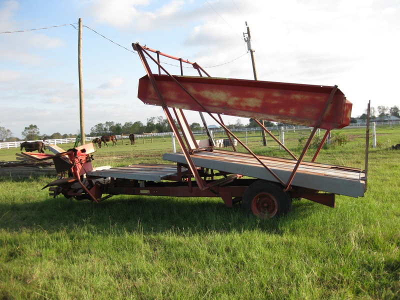

DMF, I can relate to your pain of handling "small" square bales of hay. First thing I'd do is get that poor fellow who's "bucking" those bales up onto that wagon a pop-up loader. Usually found around here at auctions for pennies on the dollar. Believe me, they're worth their weight in gold to a hand who's over forty and no longer can (or want) to keep up with those young, flat bellied, kids who we once were. That is provided you can find one who's willing to haul or load a bale of hay nowadays! Anyway, I'm rambling. I haul mine on 16' utility trailers so I may be talking out of turn here but I like your idea of staying with a wagon. I know what you're saying about backing a wagon, it's not the easiest thing to do. We have one similar to what you described but it's converted to a "covered wagon" now with seat, bows, a sheet and two good sized mules to pull it. Like I said our running gear is similar in size and build but your friends is built more for hauling some serious weight. Copying his might work unless you want to replace the wood with some heavy walled box or rectangular tubing or channel iron. We actually were able to retrofit our with rear disc brakes with a small ball valve in line by the seat to lock the brakes while parking. Bear in mind they aren't vacuum assist!? Kind of like the not-so-old days! I know this doesn't seem too informative but some sort of brake or chock might alleviate the wagon from pushing the tractor back while parking it in the barn.

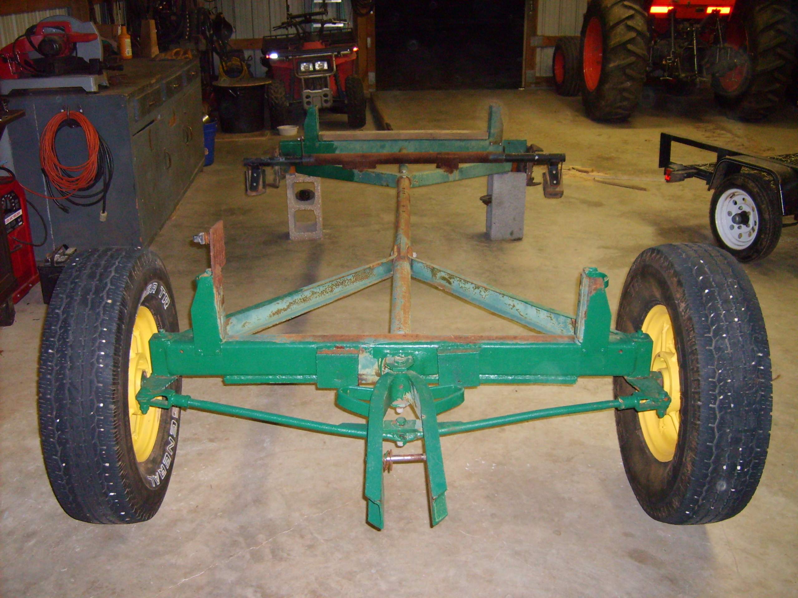

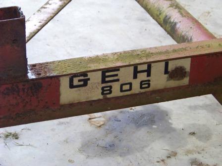

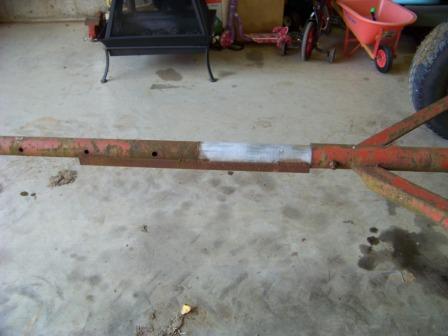

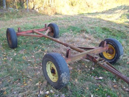

I've finally gotten back to work on my wagon... It's a Gehl 806. You can see where the original owner extended the frame. I didn't need/want it this long so I took off the extension (very easily in fact which is kind of scary in a way...) and shortened it up. Every tire is a different size and actually one rim was a 16" vs. the 15" on the rest. I got another 15" rim from the original owner and swapped it out.
Since these pictures were taken I picked up a matching set of light truck tires for free on craigslist, painted the rims and re-packed the bearing replacing one of the real seals as well.
I picked up my lumber from a mill last weekend; more pictures to follow if/when we ever get some weekend days without rain.

Hello again DMF. Looking forward to the running gear with a bed on it. Help me out here, I can't see any steering linkage in the last picture. Is it my old eyes or are they hidden?

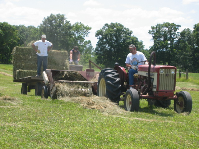

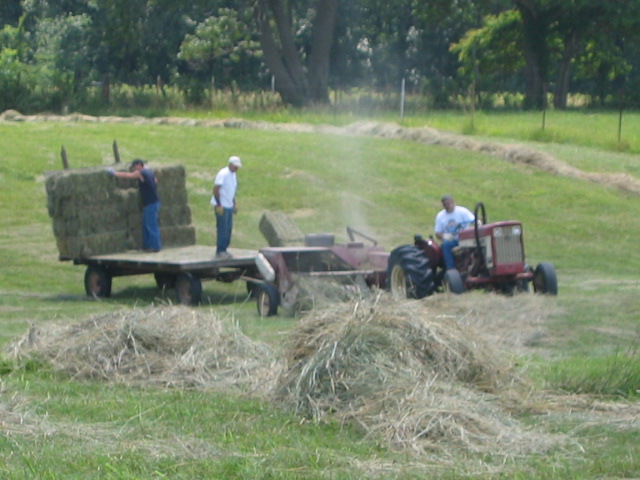

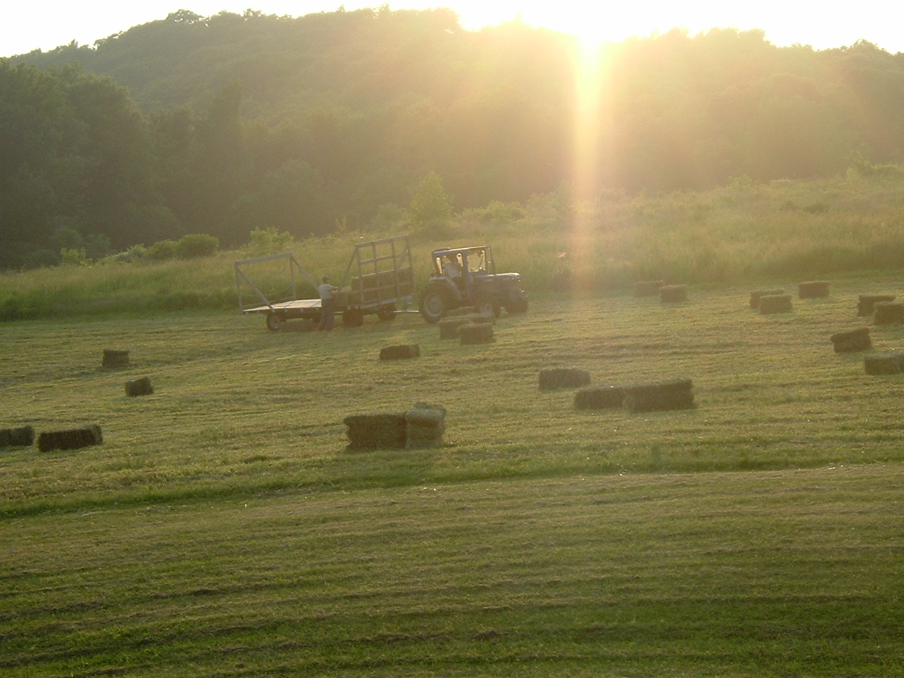

We pull ours behind the baler. No sense in lifting them off the ground when working on flat gournd. We call them rack wagons around here. We fill two wagons then unload them in the shed or on to my fifth wheel to haul to another farm. These are home made. One with rough cut oak on the floor and the other with ply wood. The plywood floor is very slick.

DanD78;
You have to tell the story behing your exhaust system. It almost looks like a rubber hose. Inquiring minds want to know.
SimS
/ Hay wagons; let's see them! #18
My guess on that exhaust pipe is it has a metal bucket hanging from the frame of the tractor and the pipe goes into it so if there is a spark from the exhaust- it is put out before it hits dry hay. Correct?

Nice set up there DanD78. I can see that would work quite well when everyone is there to do their job. Save from having a separate pulling vehicle and a pop-up loader or "bucker"! For those who don't know or haven't ever experienced the honorable job of "bucking" the bales upon a wagon, trailer or truck: It's the new guy, unlucky guy or MACHO guy that gets to throw the bales upon the wagon, trailer or truck. In our case it's the "young whipper snapper" (if you can find one now days who'll actually work) who wants to prove he's got the muscle and grit! :p Anyway, I'm rambling. I bet that plywood floor is slick as you mentioned. Did you have to extend the chute on the baler to reach the wagon? Shorten tongue?

My Brother in law didn't like the exhuast in his face so he made his own bottom exhusat. It gets kind of hot under foot. The bale chute is extended so it is just short of the wagon and a little high so the bales are easily to grab. Bailing like this is the only way I have know till a few years ago. Some of the big operations use a bale accumulator the pick up 8 bales at a time with a loader attachment. The only labor is unloading in to the barn off the rack wagons or fifth wheel trailers.
