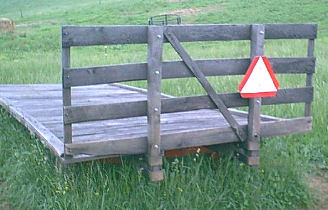

We've got 4 hay wagons on the farm. 3 are large ones, hold about 280 bales when stacked right. The other is small and has the deck removed right now for hauling lumber.
Up here racks are all built with big stringers and 2x6 deck run the width.
I see in the US smaller stringers with 4x4's run short ways and 1" deck run the long direction is common.
Ours live outside and seem to last about 15 years. Takes about 3-4 hours to completely redo one. I've started using seal healing asphalt over the stringers so I only have to redeck in the future.

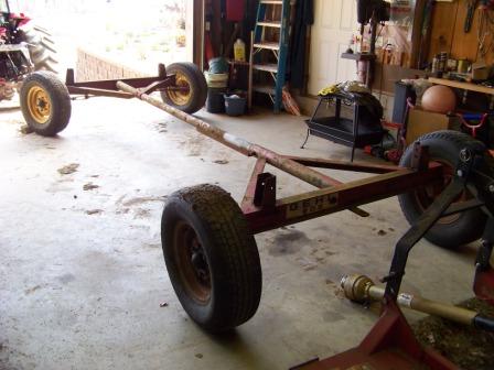

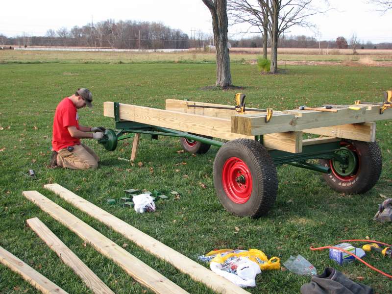

What size is your wagon??? How high are the sideboards??? What did you use for your runners on the frame??? Did you use 4x4's for the "floor joists" What size wood did you use on the floor??? Is it pressure treated??? I was worrried about loose corn falling through when the pressure treated shrinks.
Do you have any pictures of the construction process???
BTW: I like it.
I'm going one day this week to look at some running gears. One guy has two that he wants $100.00 each for. I want one to pull behind my corn picker, It's a New Idea 323. Looks a lot like yours.
Another guy has a wagon with a floor and sides he wants $250.00 for. Not sure what it looks like though. It does have Electric running gear.
Sorry for so many questions.
My wagon is 7'x12'. All of the wood is pressure treated, bought from Lowes (you could save a lot if you have a local sawmill). The main beams are two pairs of 2x8's and the "floor joists" are 2x6's. I notched the main beams and cross beams an inch each so they interlock. The floor and rails are 5/4"x6" standard decking boards. I butted everything up tight when I screwed it down hoping that once it shrank it wouldn't open up too much. So far I don't have a problem losing corn through the cracks. The side rails are 3 boards high, so that makes them 17" tall. Also, to be exact, the floor is 15 decking boards wide so that makes it 85" wide.
I would say that if you can get a decent wagon for $250 that sounds like a great deal to me. I couldn't even find a halfway decent name brand running gear for that around here. I've got way more than that in mine just for materials. My picker is also a New Idea 323. I'll attach some pictures of the build. Good luck!

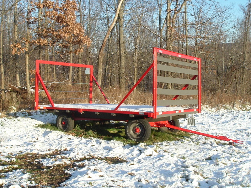

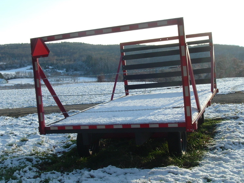

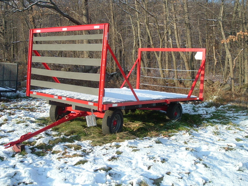

As promised, I took a few pictures of the finished product. Sorry for the snow...the deck boards are painted the same Massey-grey that the head board and wheels are.

Great job, Rich. What is that 3" channel? I like how you brought the corners together on the uprights. I see grass doesn't just grow on top of the septic tank but under the wagon as well!:D
Jay
/ Hay wagons; let's see them!
#48
Jay
Yup. That was channel I picked up cheap from a place that was going out of business. It's the sameplace I bought the pallet racks I mention in my thread "Implement Shed" in the projects forum: http://www.tractorbynet.com/forums/projects/158849-implement-shed.html.
The hay wagon was my first real welding job and I did it all with a stick welder. I'm pretty pleased with the results.
As far as the grass growing underneath it, I had recently parked it there before it snowed. When I had the wagon assembled but not yet painted, the grass under it all died, I assumed from some acids leaching out from the oak floorboards. ;)

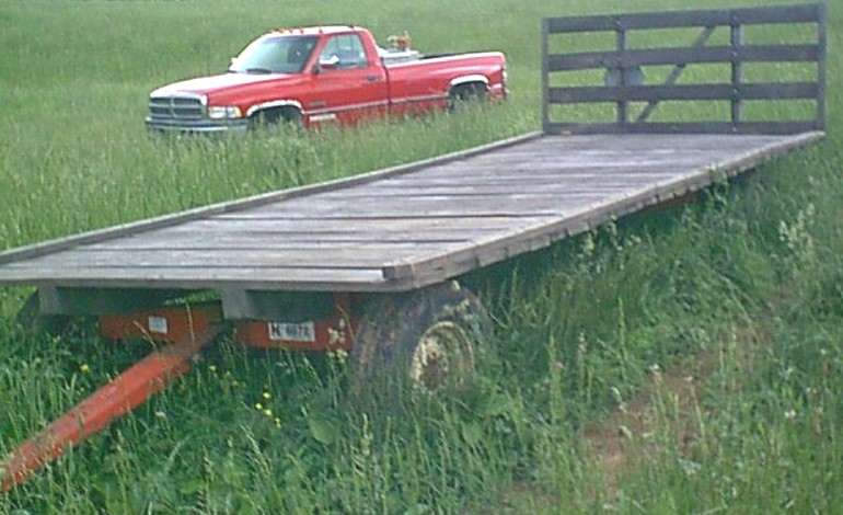

My first choice (and long standing, years ago memories) would always be pulling the hay wagon behind the baler, with a trusty helper carefully stacking the square bales.
But anymore I work alone, dropping the bales on the ground.
Next pass is with dually truck and gooseneck trailer - low to the ground, easier to back into the barn. Just works for me these days.
For the couple thousand bales a year I put up, is the best I can come up with.

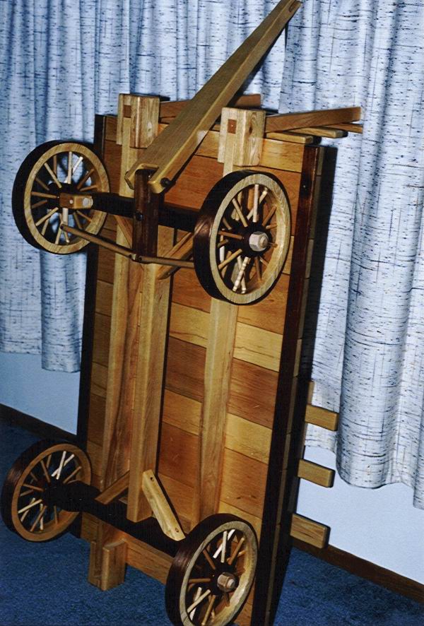

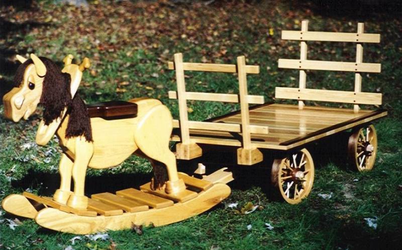

Just for fun, here is the hay wagon that I built several years ago. Made from wood obviously but it was fully functional. All of the fasteners were wooden threads and the wheel rims were steam bent walnut. The main body was made from ash and the trim is all walnut.
Soon I will be making a steel version of this wagon, just a bit larger for the new Deere.
