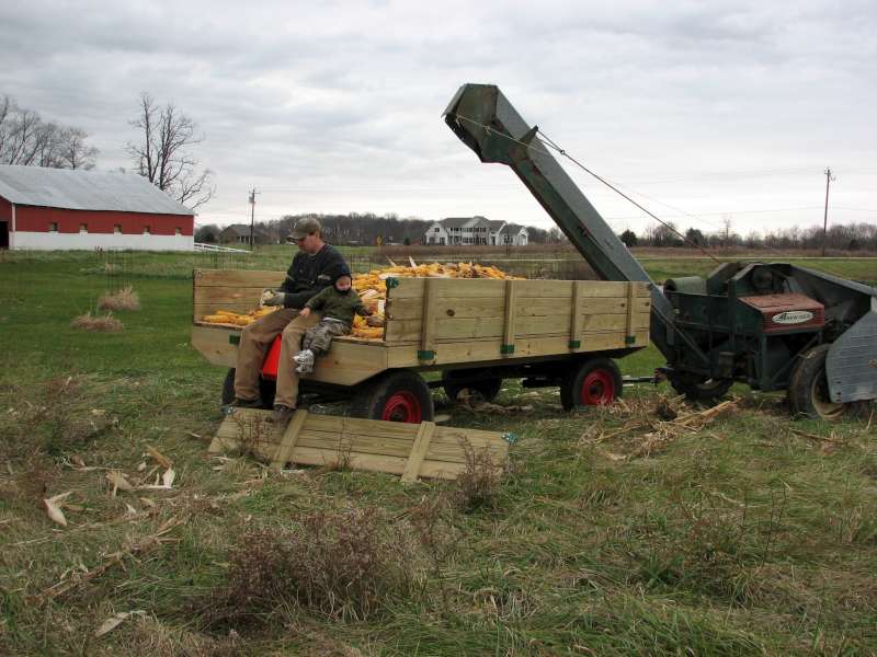

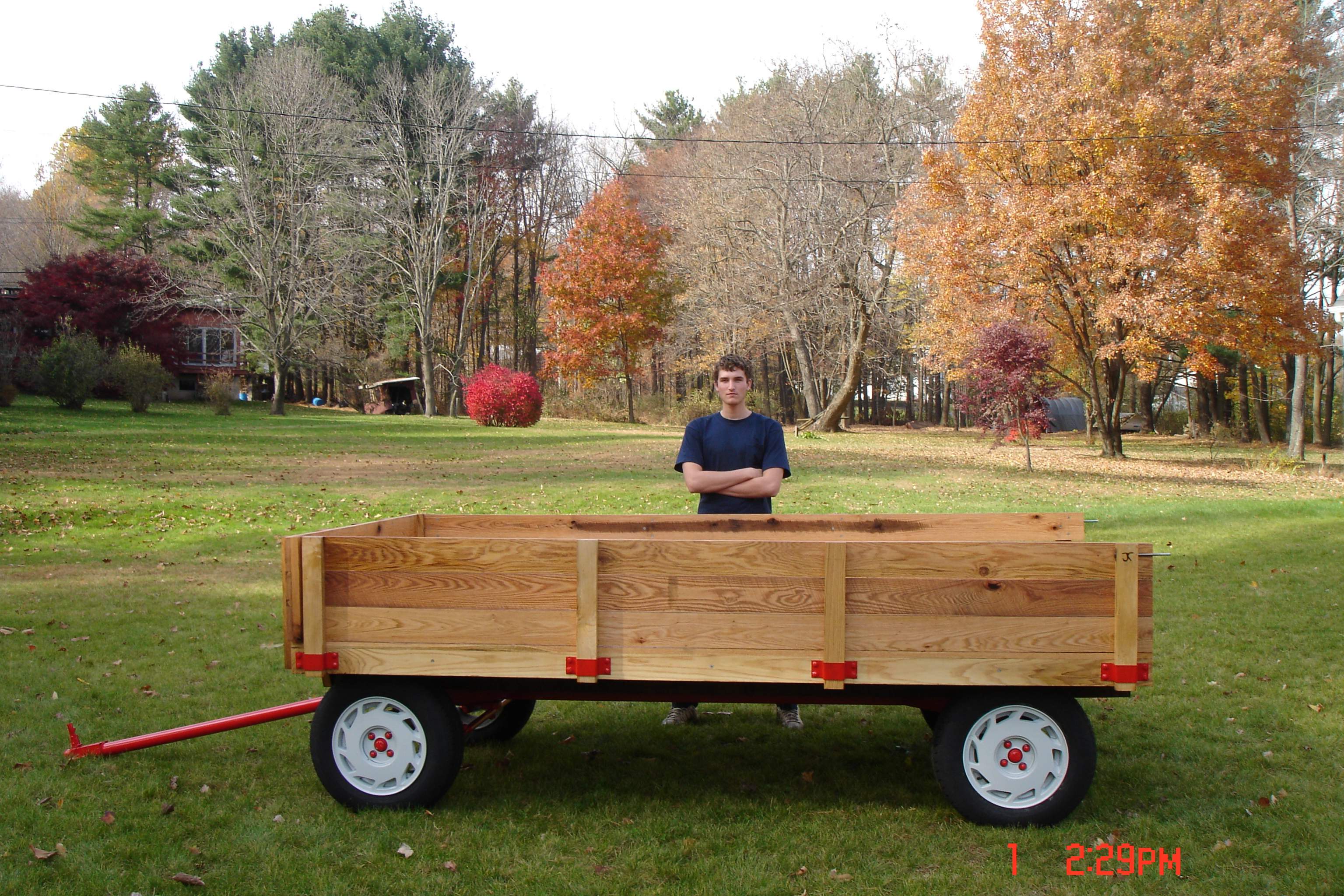

I made this wagon about two years ago. It is made of rough sawn oak and lots of VW and Audi parts. I the frame is 2x4x.125 tubing. I don't need it, but I wanted one. I use it to pull kids around at parties. {thats my son in the back ground} DSC02142.jpg

I made this wagon about two years ago. It is made of rough sawn oak and lots of VW and Audi parts. I the frame is 2x4x.125 tubing. I don't need it, but I wanted one. I use it to pull kids around at parties. {thats my son in the back ground}View attachment 176695
Cool looking wagon. Looks perfect for hay rides!
