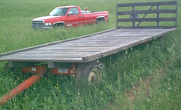

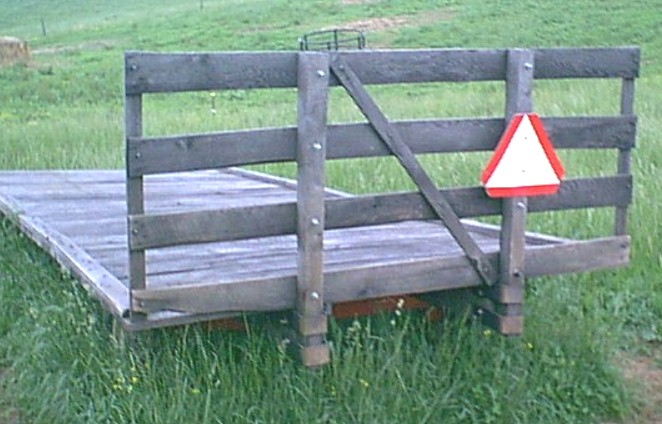

Yet another approach. I've seen a few commercially built wagons made this way, so I thought I'd try it on one of mine. It costs less because there are no 4x4 cross members and 2x6's cost less per foot in shorter lengths than 16 foot lengths. I don't see why it wouldn't be just as strong. Now I have 32 2x6's supporting the outside edge instead of 5 or 6 4x4's. Time will tell.hay wagon.jpghay wagon 004.jpghay wagon 005.jpg

Should work, plus it's a little lower to the ground that way!

Looks good. I've replaced 3 4x4's and one main runner on my h&s basket like yours a few years ago so hopefully a full rebuild is a long ways away.

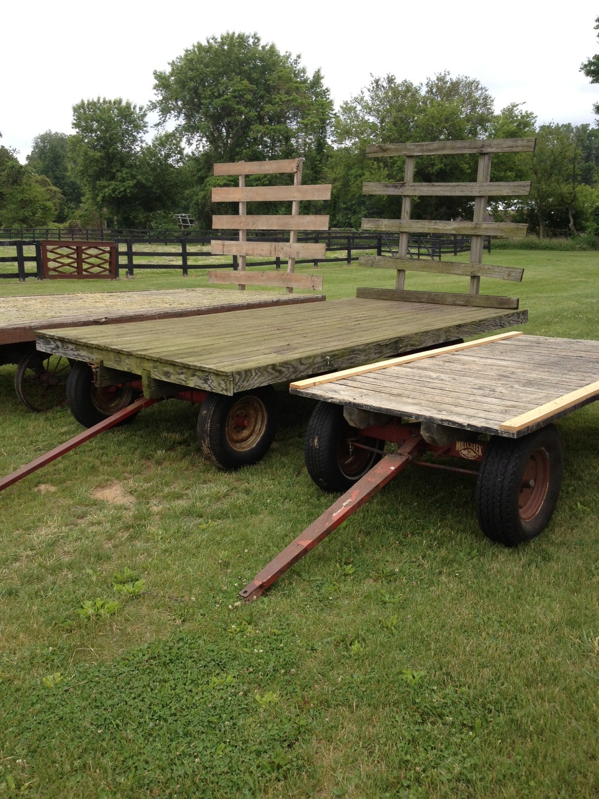

Here is our squadron. Some old, none new, some borrowed, none blue.

Actually, it's no closer to the ground because I had to use 2x10's for the stringers to be able to clear the tires.

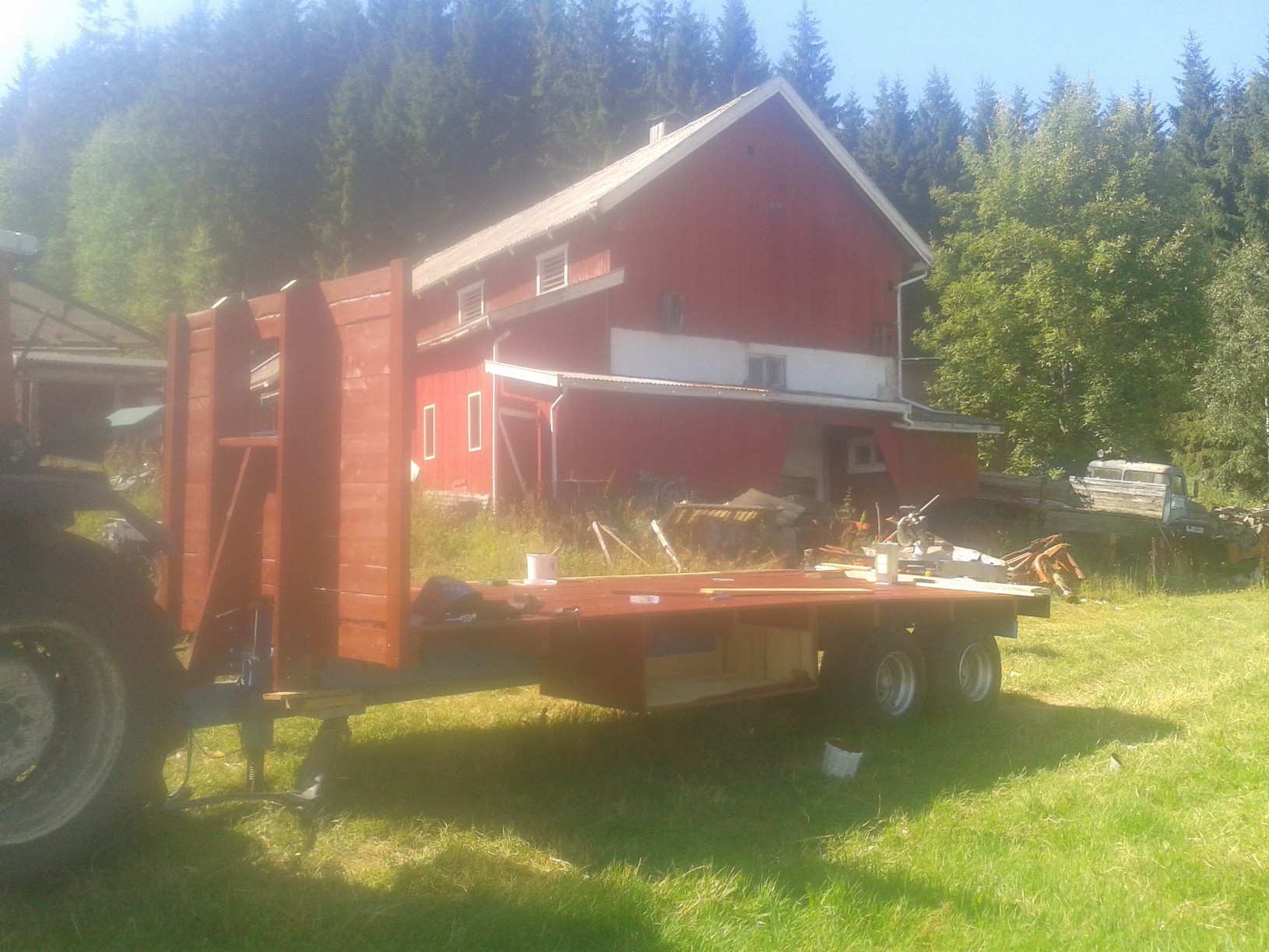

Pretty heavy duty Tor! What will go in the box along the underside of the deck?

Storage for straps to tie down the load. Frame is built for 14 metric tons
