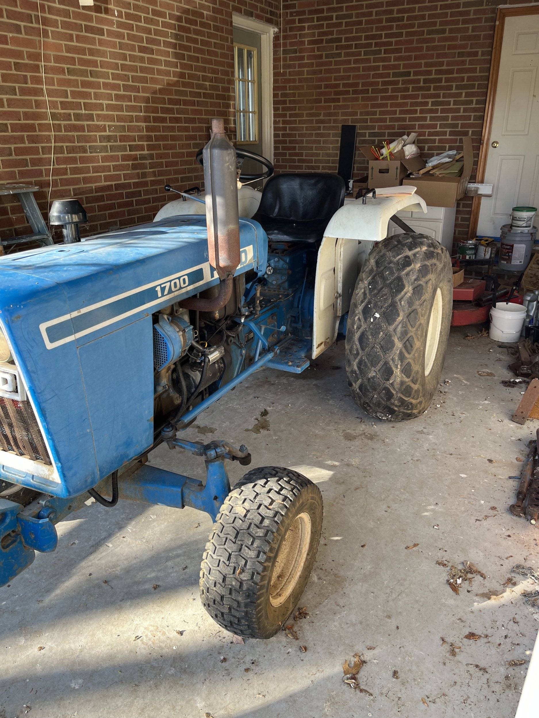

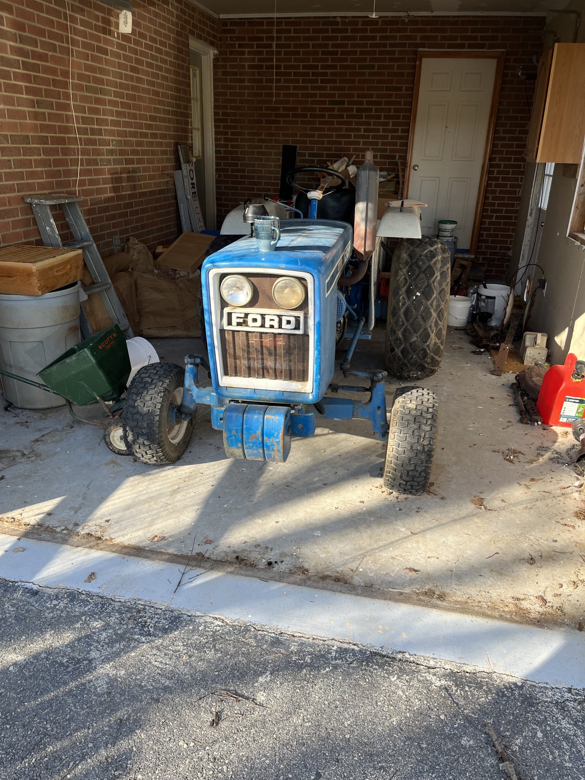

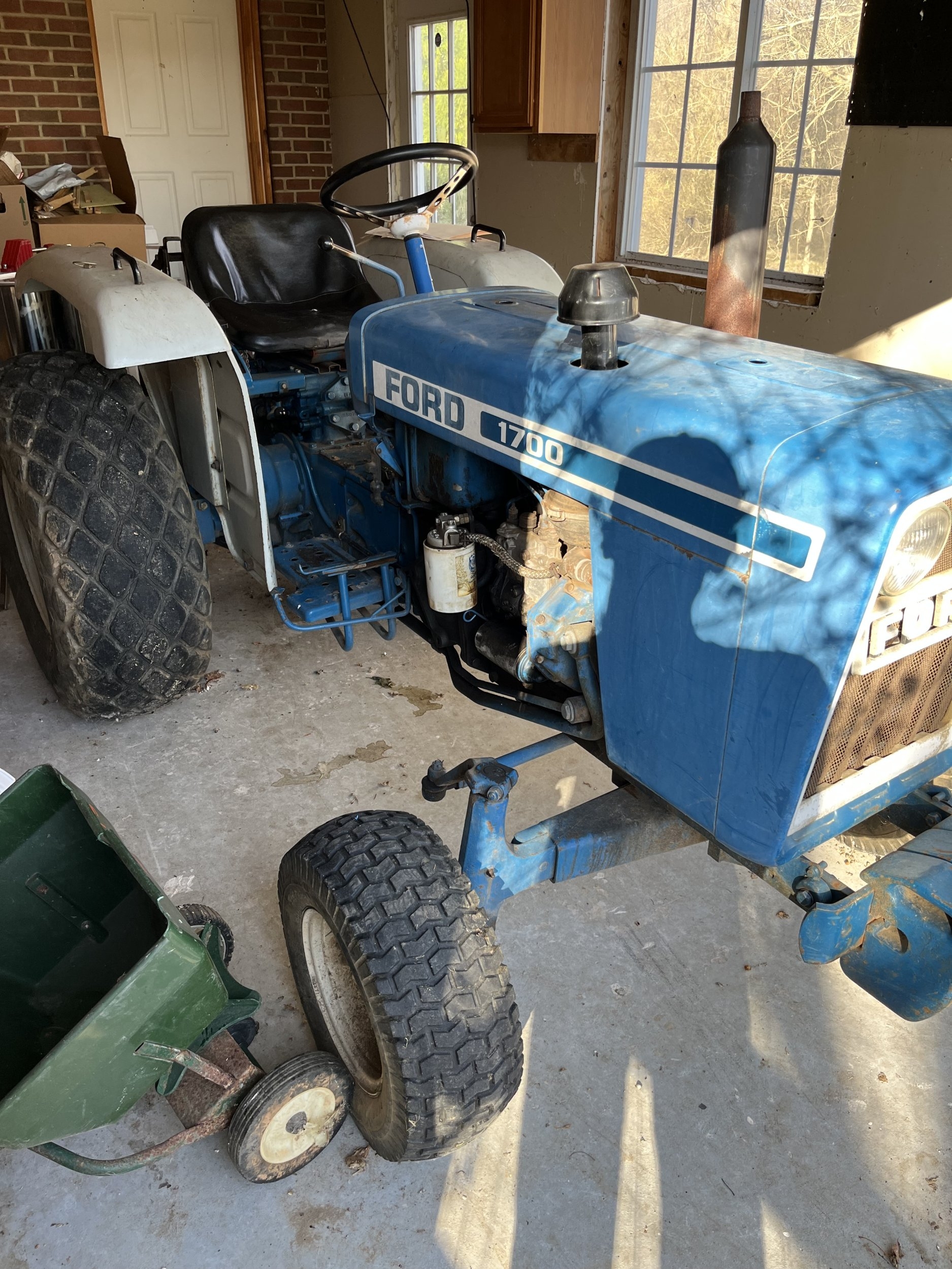

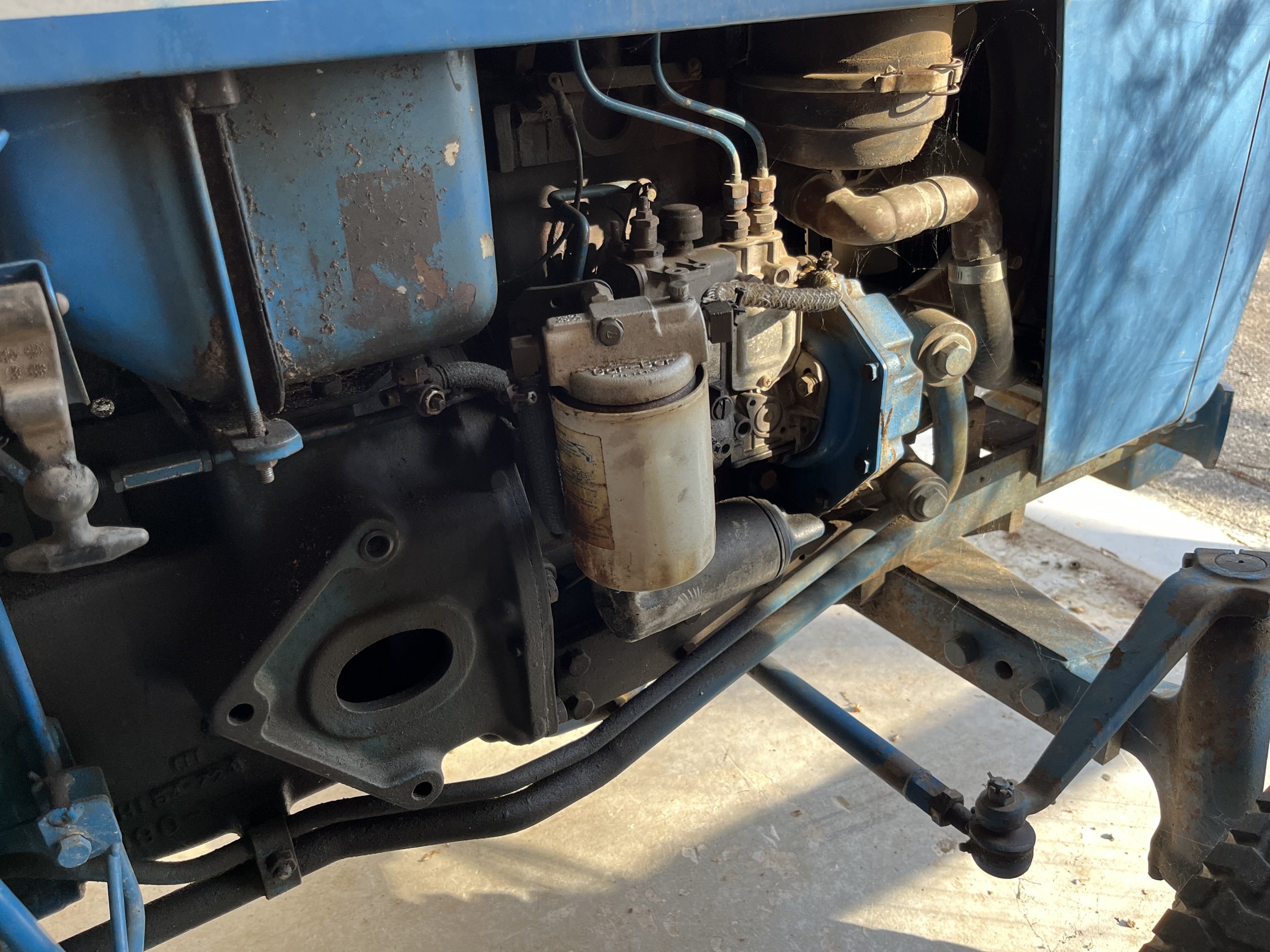

I know it has been awhile since I posted but I just went over to check out this tractor for the second time. We jumped it and got it started. It has just been sitting in his garage now.
So I looked the tractor over as best as I could and tried to be as vigilant as possible and noticed some things. I know anything this old is going to have some stuff going on with it.
1.) There is a leak somewhere at the rear of the tractor on the three point. It looks like it has on of those adjustable cylinders installed on the rear and that looks like a good culprit. There is also a wet oily residue on the engine too. We only ran it a short time and the lighting was not great.
2.) I noticed that the coolant in the radiator was not near the top but it was wet.
3.) While it was running I took off the oil cap and there is definitely a steady stream of air coming out. It was not strong at all, I could definitely hold my hand over it and no noticeable smoke coming out.
Anyway it is still a meh situation because we are both unsure. Like I said I mow his grass for him and said I am not sure how much longer I am going to be in the business. He said he would then use the tractor to mow his property. He said to be honest he would like to get closer to $4,000 for it and all the implements too. He said he would think about it and let me know something. The oil is also basically black which I think is normal for diesel engines?

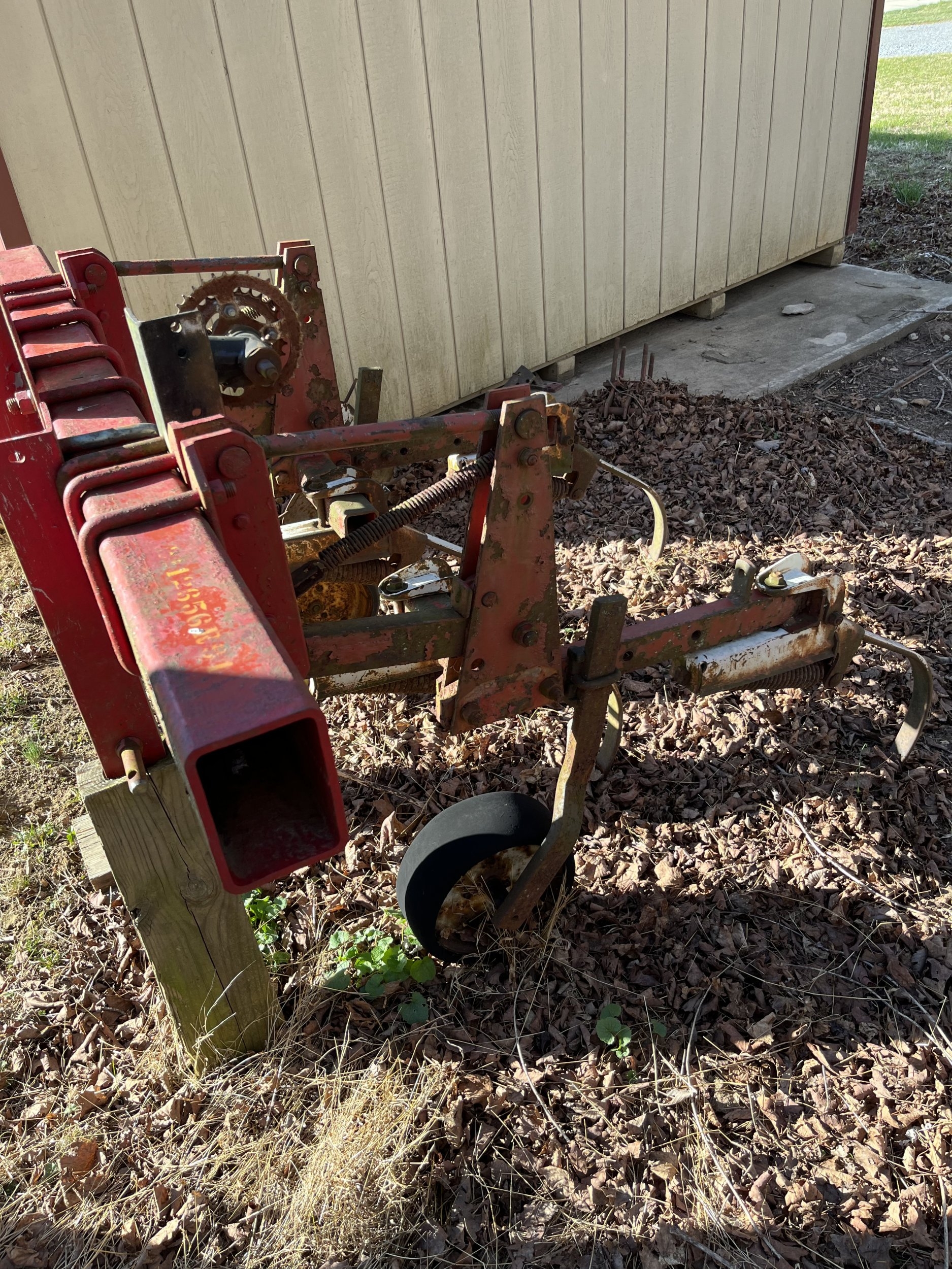

If the tiller & RFM work it's barely worth $ 4k but it probably is for a first learner tractor.

It looks to me like you would be buying a lot of work for yourself - it will probably take lot of time to check out & overhaul all of that!

Pass.. I have a pump off and 1800 that is no longer supported and no hard parts available.. I had to circle the globe 2 x to find the seals..
Some blow-by wouldn’t concern me, not at that age. Realistically, do you see yourself putting it into 40 hr per week usage? If you need a full time unit, this ain’t it. Some blow-by at idle could show no appreciable increase over the next few hundred hours.
All my diesels, even my 2018 Cummins purchased new, and new KIOTI, make the oil nasty black very quickly. It’a the nature of the beast and a design factor in the diesel specific oil additive package.

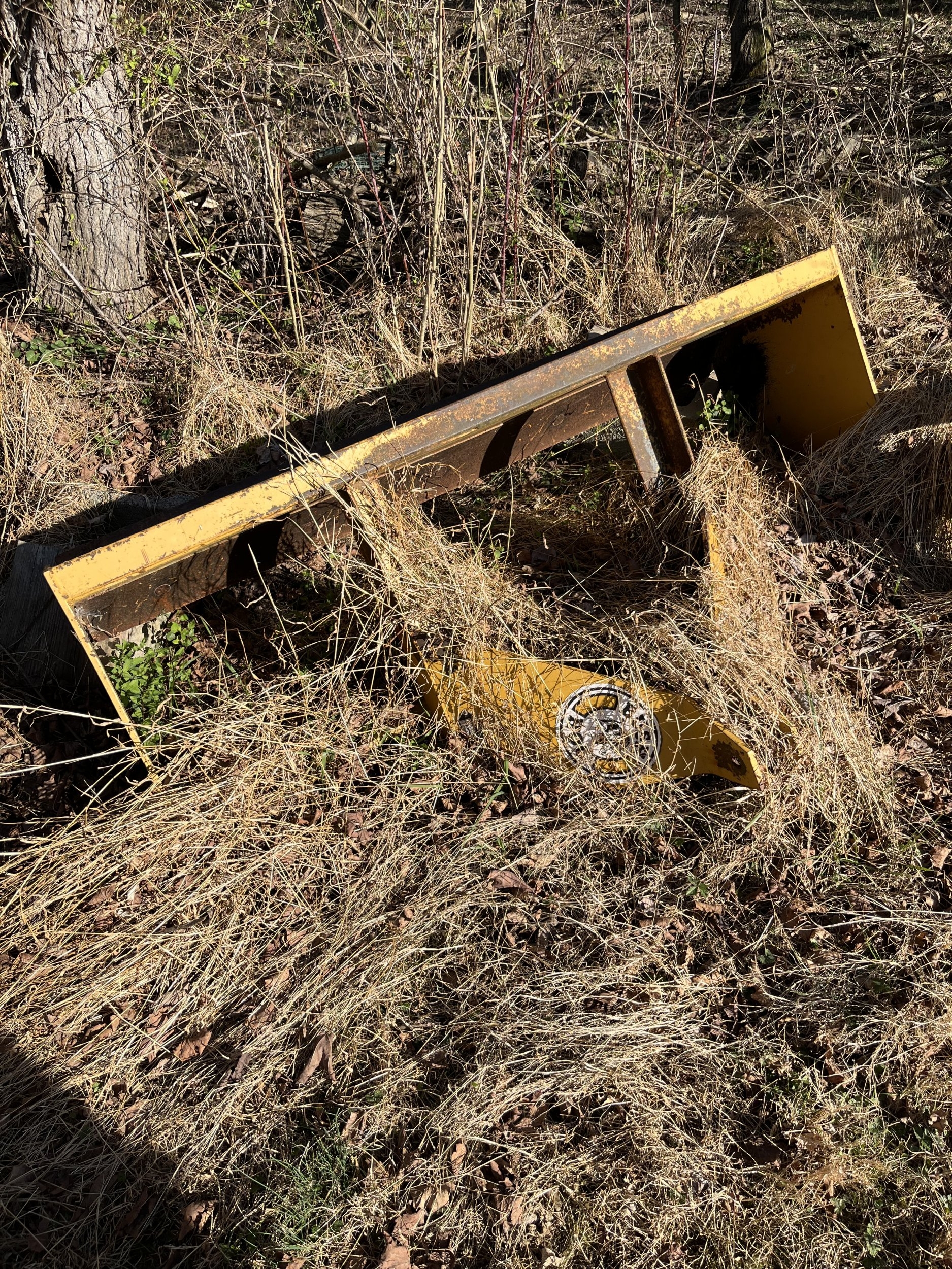

Hey guys,
So I did create a post about this before. At that time I did not have all information. So there is a neighbor that lives nearby that said he may be interested in selling his Ford 1700. So the tractor has about 2,300 hours on it and he has about ten implements with it. It is also not 4WD and I think you guys would agree that if it does not need new tires now it will soon. As you can see right now it is safe and sound in his garage but he never runs it and to my knowledge hasn't since he inherited it a couple years ago.
A major reason I did not want to purchase it at the time is I did not and still do not have an indoor shelter to store it. So I hate the idea of purchasing a tractor and immediately storing it outside under a tarp. However, it not being ran and just sitting may be even more of a problem. I am no diesel or tractor expert but the first time I saw it he started it and it sounded pretty good. I did not check blow-by or anything. Having that said, he tried starting it again for me earlier this year and it would not start. Very confident that is the battery.
There is a whole lot going on where I live and there is definitely some opportunity. For instance, my other neighbor has this snow plow and post hole digger (not pictured) that he said I can have if I can move it. It is not as easy as it sounds because it is on a hill going down to the river and there is no easy access. It may already be gone because it is halfway onto the neighbors lawn and I know they both wanted it gone. I also have been wanting something to help me with some small tasks around the house but to be honest I would be purchasing this tractor for no reason in particular right now. I mow a lot as a side business and would like something that could brush hog but I don't even think my trailer could hold this tractor. I would like to reclaim my garden, eventually put up some new fence so it may be nice to not let this opportunity pass by. To be clear, there are many more implements I would be getting.

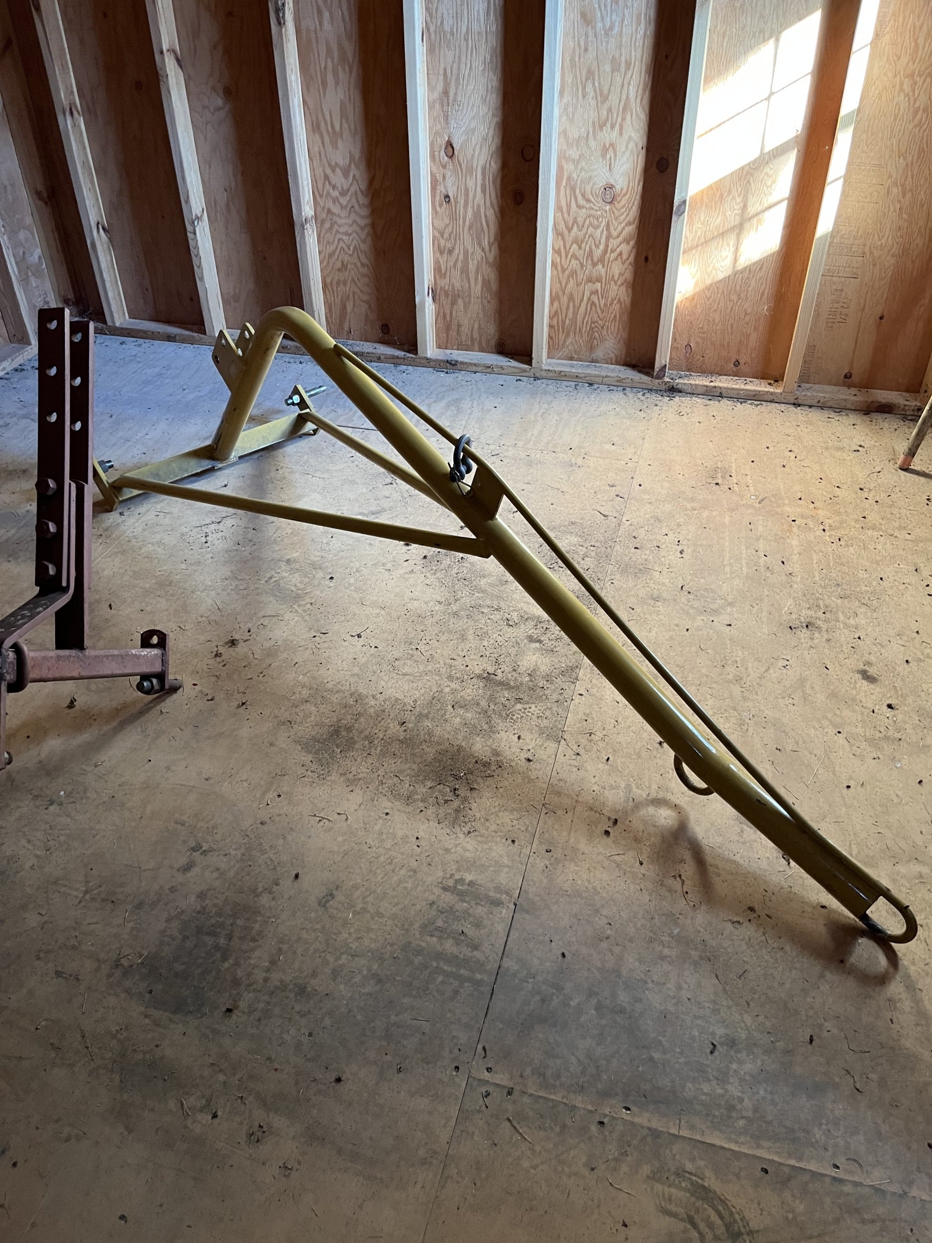

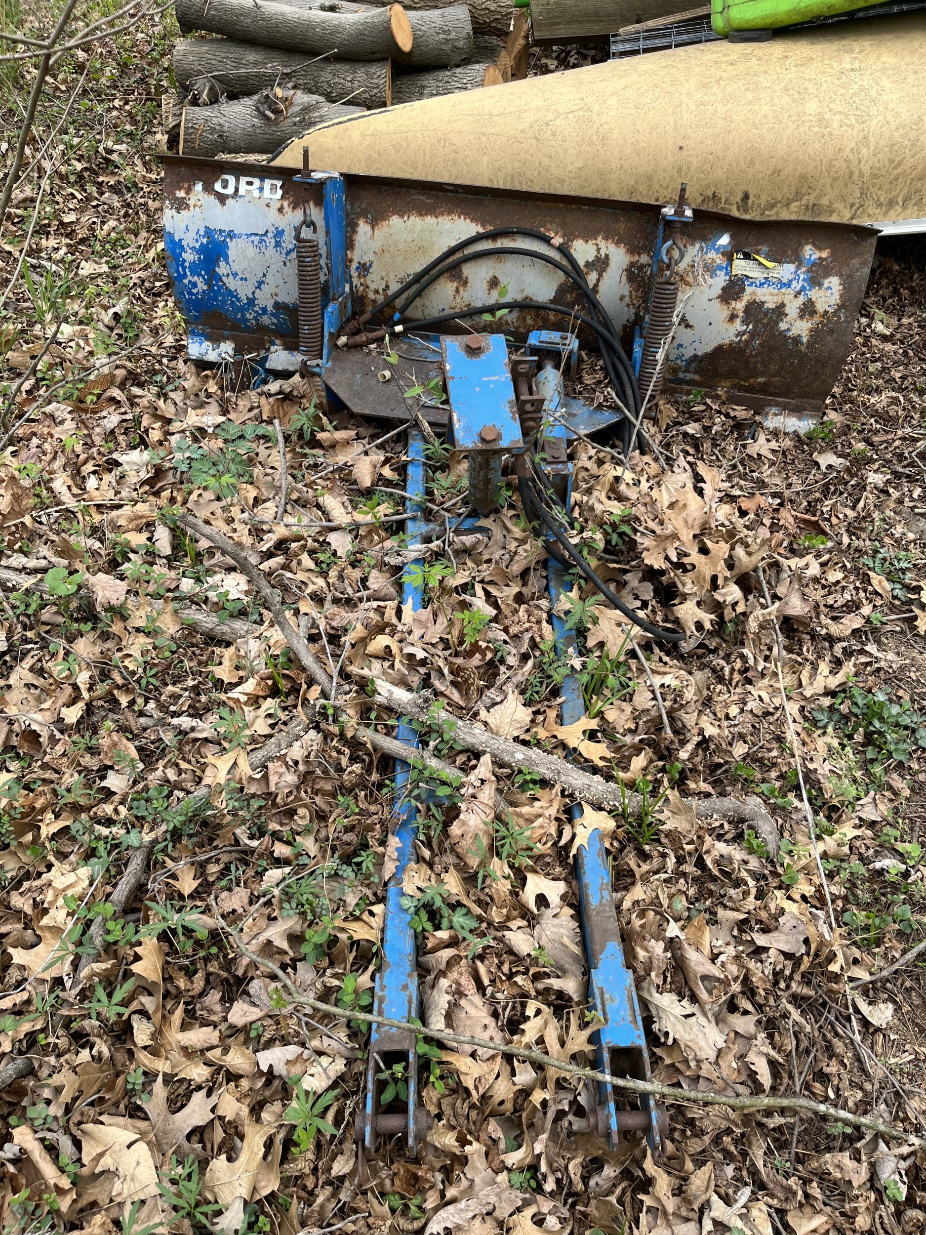

So this blade/snow plow is independent from front end loader arms correct? As in it may be fully functional on the Ford 1700? I'm sure some of you remember me getting rid of the Ford 1210 that belonged to the neighbor. He said he thought that plow would work with his tractor but it was for a larger machine. So I was just thinking it may be perfect for the 1700. Again he said he would seriously consider selling it to me if I wanted it and he said he thinks we would be around $3,200 but he made it clear that he was uncertain until he did more research and we spoke more. We both just kind of stopped talking about it and left it alone. So before this becomes a literal novel I will leave it like this. I think if I put any money into it, I would change the fluids/filters out, possibly new tires soon after getting it and maybe even pallet forks and rear scoop for the 3 point. I think someone one here told me to forget about a FEL because if these tractors had a weak point it would be the front axle. So I was thinking after all said and done I could have a very capable little tractor for around $5,000 with lots and lots of implements. Thoughts?
I agree on forget the FEL.....several reasons that's a bad idea. I have a 3 pt scoop and a 3 pt boom that I used in lieu of a FEL when I first started trying to learn how to farm. Once I expanded my "herd" the FELs solved both problems on different tractors than your 1700.
On sitting, a few years ago I bought a 50 hp Ford 3910 at an estate sale about 3 years ago. It was obvious that the old gent hadn't run it in quite awhile. I got it home and first thing was I changed the oil and filter. Fired it up ran it for a few minutes and checked the oil level.
The level was OK but the oil was already turning black. Oil pan sludge is the first thing that came to mind. I drained the oil into a clean container and ran my finger into the drain hole and found about 1/4" of sludge on the bottom of the pan.
Oil capacity was 6 quarts for a reference and I dumped a 16 OZ can of Sea Foam into the crankcase and cranked it up to 1k RPM and let it run for half an hour.
Drained the oil and in checking the bottom of the pan, no more sludge. New oil and filter and oil now stays clean. Dirt can't stay suspended in detergent oil (15W-40 C rated in this case) indefinitely.
On my used purchases and that has been the norm for me since 1978, fluid changes are at the top of the list first thing to do.
On sitting outside under a tarp, to me, a lot better than just sitting out in the weather.
A grease gun is your friend as is an operator's manual and service manual.....ebay for one, is an excellent source for such publications
If it smokes after you change the oil the last time initially, with that few hours on it, warm it up and hook it to a good loading implement....5' weighted disc harrow for that tractor to name one and take it out and work it for a couple of hours getting it good and hot....not over temp but up to running temp and hold it there for awhile to clean out all the critters in the fuel system, hydraulics and things like stuck rings and sludged up valve train. Per the can of Sea Foam instructions, a dose of SF in the oil would help to clean up any stuck/carboned up rings eluding to your smoking.....if that is a problem.

$3k with the implements, hmmm. I would check the rear lift capacity. Tractordata.com says 3813 so that might be enough to move your firewood totes if you buy or build a set of forks for the 3pt hitch.
As far as hills, 2wd isn't the best but with a learning curve, some hills can be negotiating. Make sure the individual steering brakes are in good adjustment.
A FEL for that tractor will be hard to find and probably not a good idea.
Have you looked at the height and load capacity of a Ventrac FEL?
While I liked my Steiner 525, I never considered a FEL for it.

Hey David and Texasmark, thanks for the responses. Ventrac just released a brand new FEL that can be used with the dual wheels and has some other great features. It still has some drawbacks and people argue about what they will actually lift but the capacity for both FELs is 500lbs I think. So I obviously have no chance of lifting my totes with those.
The most recent visit which was the reason for my recent update he is asking a little more for it and still unsure if he wants to sell it. I think right now it is going to be a pass for me. I am trying to convince him to not let it sit but that is what it is doing now. Another part of it is that he plans to mow his lawn with it if I stop cutting for him which is understandable. It makes the situation even more uncertain.
