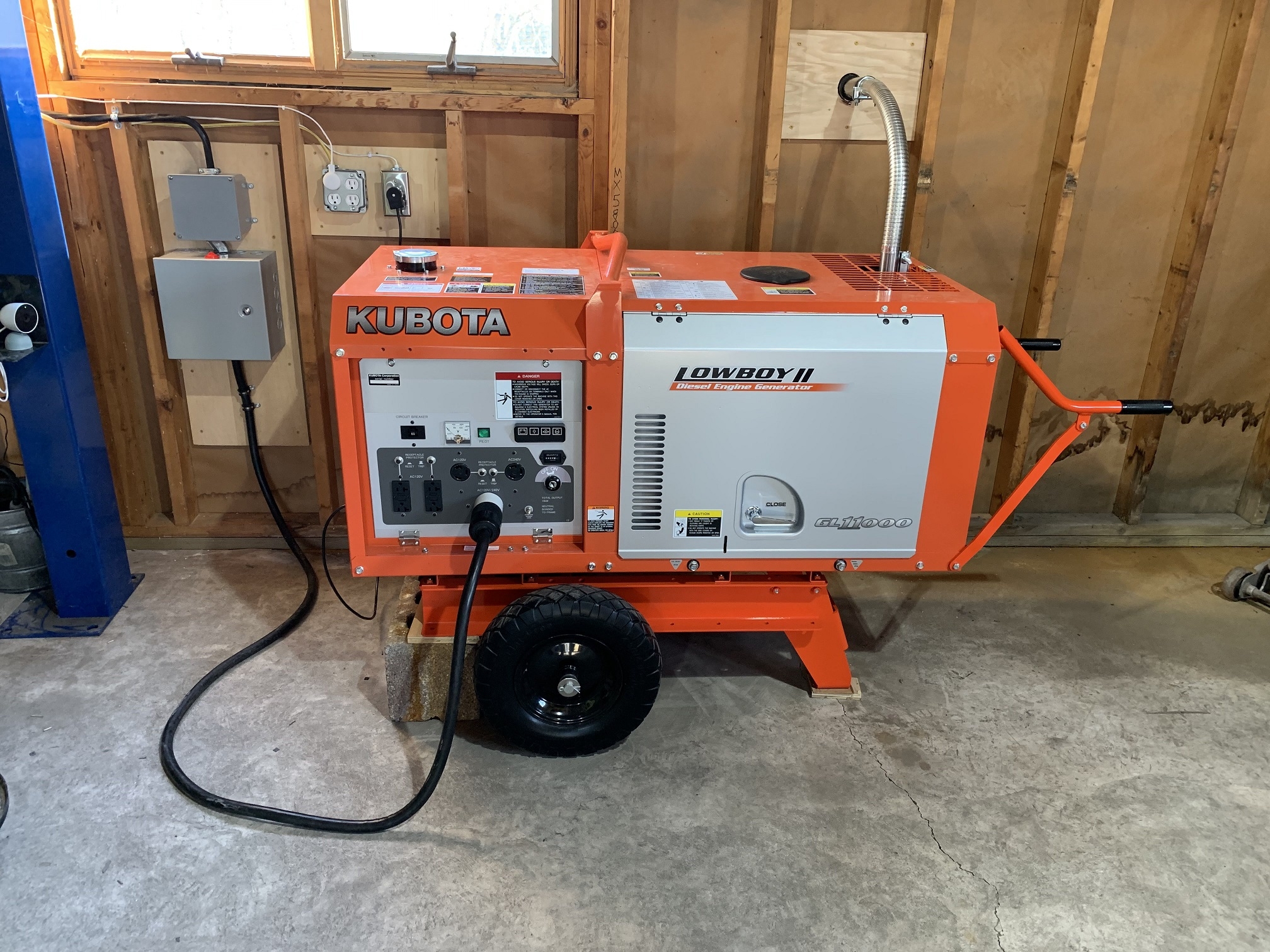

lol... I was leaning the other way, for a few reasons, in order of importance:If you heat with oil get a diesel, a real generator . Not a 3600 rpm pos...
1. Location of propane tank is more favorable than location of oil tank.
2. Concerns with oil performance in cold weather. It's often below 0F when we lose power.
3. The relative ubiquity of propane-fired generators. Face it, they're everywhere, and options abound.
I'll admit we could bury the oil line deep to manage freezing, although we'd be snaking thru a half-dozen other utilities in that area. But still, the last several feet and the generator itself are in the cold. With our oil tank being in our basement, it's totally un-treated for cold weather.
If diesel genny could be installed in basement, instead of outdoors, then there would be many advantages of going that route. But does anyone do that?
