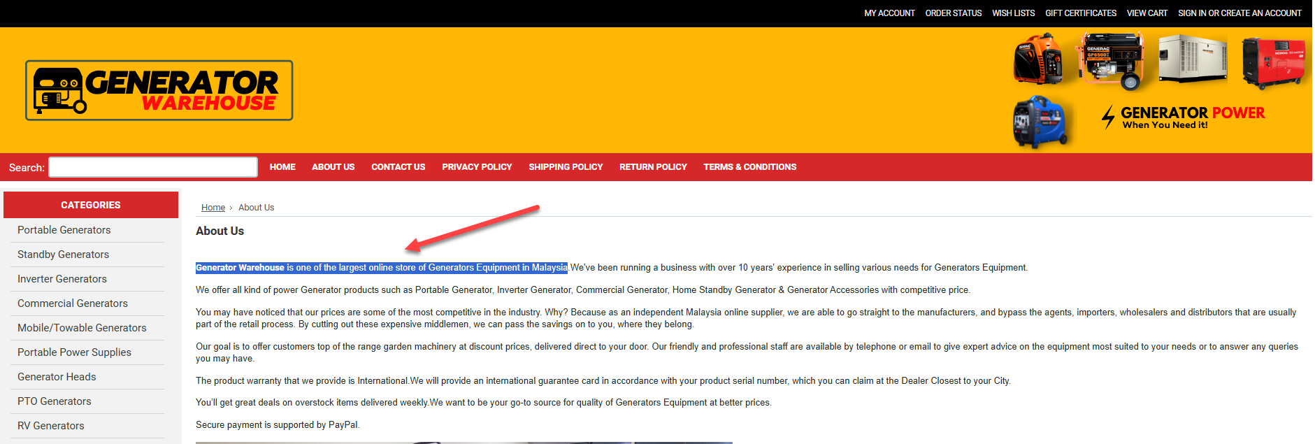

Ok, somethings fishy here….this is a $2,400 switch. Is this link a reliable site ir something is fishy. This site lists a generac 14 kw with a 200 amp switch for $1700. Ya right, thats like a $5-6 grand product.
Generator Warehouse is one of the largest online store of Generators Equipment in Malaysia. We've been running a business with over 10 years' experience in selling various needs for Generators Equipment.
/ Generator install - where to start
#38
Malaysia? Check your shipping costs and times. :ROFLMAO:
