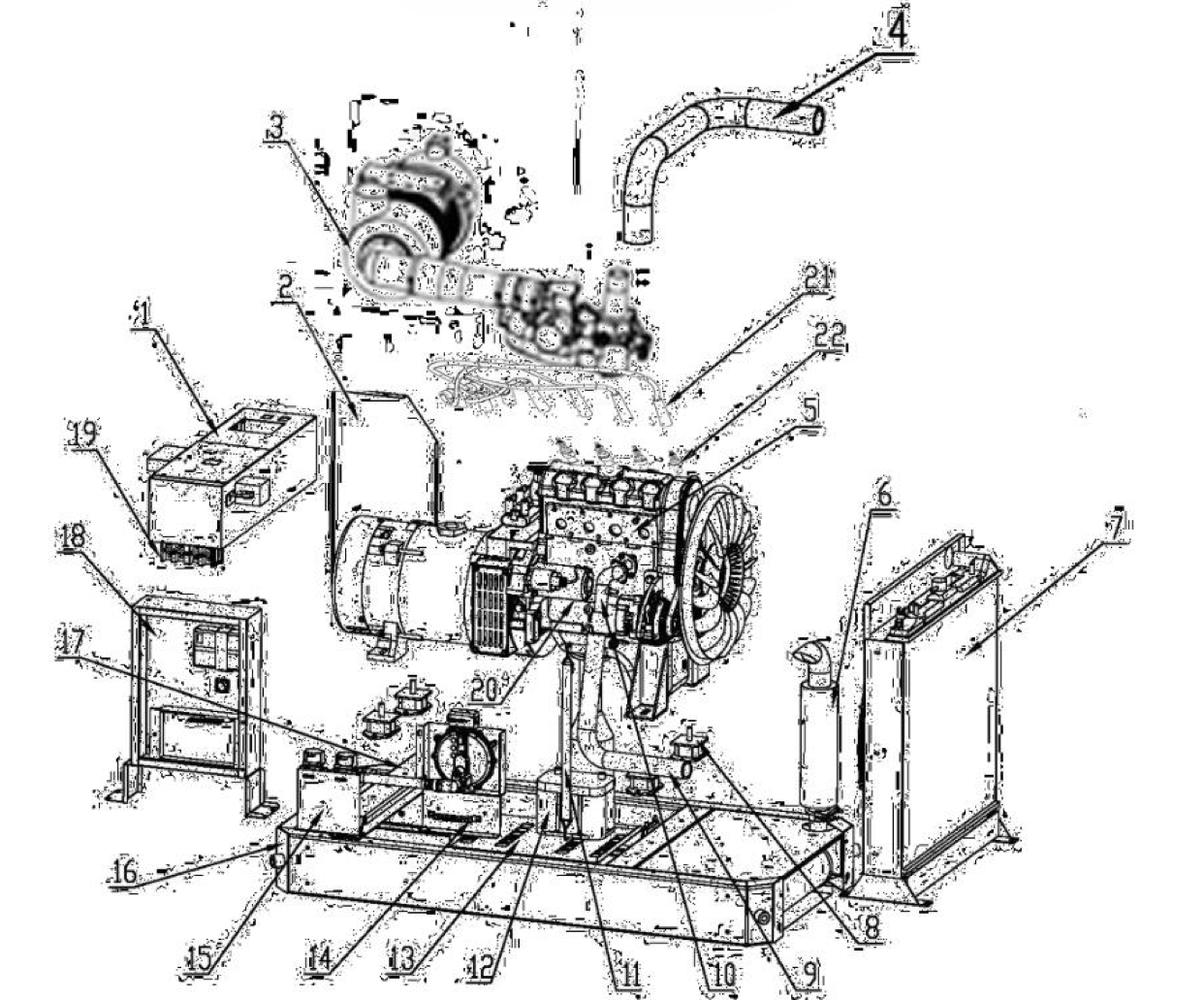

Well, they are both the same genset, made by Lifan, a large Chinese generator manufacturer. Trane/Lifan warrantees it for 2 years. On the plus side, it has a copper generator head, and there is an oil drain hose to make oil changes easier. On the minus side, it is a brushed head, and the installation manual refers to the "22kW" version as rated to 20kW, also with the typical Chinese manual/figures, e.g.
That sort of thing annoys me, easy to fix, and annoying for pretty much everyone downstream.
No idea of the engine manufacturer but it is probably Lifan nor do I know the quality for this engine. The Lifan engines that I have seen/worked with are smaller.
Is a backup generator important to you, or just a nice to have? How much work are you willing to do on it, and how much in the way of parts are you willing to stock? It doesn't have a dedicated user group that I know of.

No, dint know it was Chinese. Btw as far as I know all consumer alternators are of brush type. Thx
That's not always the case. One of four generators here is brushed, and it dates from 1960 something.
All the best, Peter
/ Generator install - where to start #89
Well, I know of Mecalte, Yanmar, Caterpillar, and Onan generators without brushes. They are fairly common, at least in my experience.
Most inverter generators are brushless as far as the output goes, though some use brushes for the excitation, with no real impact on output power quality.
Personally, I like an inverter or brushless version with AVR or digital AVR because the power quality is higher, and the THD tends to be lower. Typical setups look like this;
From Brushless Generator - All You Need To Know About Them
