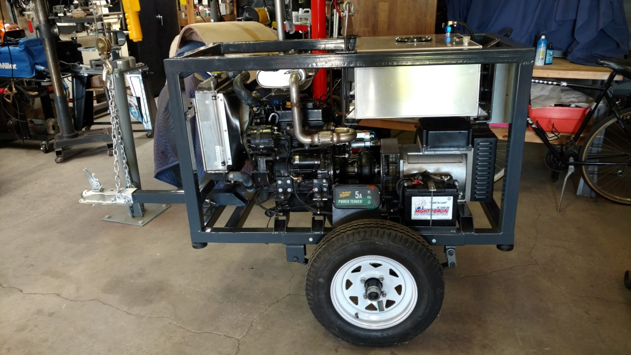

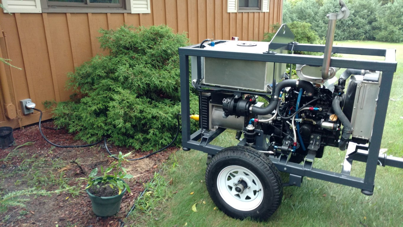

That's what I have too, 10KW powered by a 3 cylinder Yanmar, and I installed the receptacle on the house near the meter and the required interlock on the breaker box.
I got to use it a few weeks after I installed it when a storm knocked some power poles down. It powered the whole house, well pump, A/C and all with no problems.

Really clean looking genny and setup....
/ Generator/Electrical Question
#17
I really like the smoke stack and the anodized fittings.

O my goodness me, yes, this is about the cleanest looking engine and generator I've seen. Mine is crammed together and much of it is hidden as if being able to service it would be an embarrassment to the maker. And it's streamlined on the outside, as if people are going to race it. In reality, when it's running, having it rocketing away on its cheesy plastic casters would be on of the last things I'd want.
/ Generator/Electrical Question #19
Thanks, I built it from scratch over a 20 year period. Long story.
