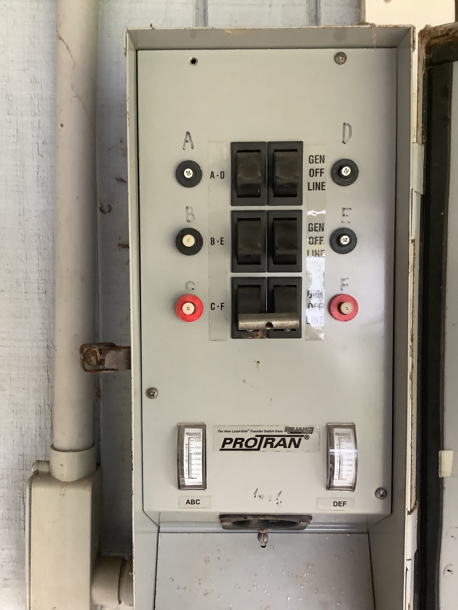

First of all, thanks for all the feedback. For me the opportunity to bounce an idea around is just as valuable as the right answer in the first place.
Attached photos show my situation. Just to clarify, I don't wish to disconnect the generator feed- I might need it. Also, I subconsciously have wondered about the risk of feeding juice back into the grid. The 4 square box to the right of the gen panel appears to be only a receptacle, not a switch. The instructions to the right imply that the transfer must be done manually--?? by switching off the feed from the main, and switching on the feed from the gen ??
In tracing wires between the panels and from the main panel out into the house, it appears that the electrician and/or homeowner just chose which circuits to include and which to leave out.
What I think I really want is an automatic transfer from the generator to the main panel w/o having any individual circuits connected between the two. If this is not possible I won't fight it, but I would like know why.
That type of isolated automatic system is not possible. How would the generator know when to turn itself on and make an automatic transfer if it was not able to constantly sensing the incoming power to be able to tell when it failed? And to do that it has to be connected to the main panel.
If you want completely isolated circuits what you want is a less expensive and less complicated manual transfer switch wired between the the incoming lines to your house and the main panel. Installing that will require an electrician and also an inspection. Then you can positively disconnect the main when it connects the generator.
What you have now looks like somebody's homebrew & dangerous system that can backfeed the grid. You could be liable if that happens. I'd either put in a transfer switch or isolate it completely.
I know that's not what you want to hear, but better that you know.

THink you need to call electrician (one who specializes in generators/transfer switches) and have them come take a look and explain to you what you have... And may any changes you require if you want to make system operate differently...
I went totally simple, manual transfer switch for well only (240V) because is you have water everything else is easy.... Just run 12 gauge extension cord from generator to fridge and computers and go into "camping mode".... Survived 8 days this way due to power outage from wildfire while local utilities work almost non stop to restore power...
After seeing the profusion of wire nuts in main panel, I don't think I would venture in there....
img_1621-jpg.771875
What I see here is a series of breakers that one set needs to be turned off, and another turned on to transfer power... WITH NO SAFETY INTERLOCK.... Call electrician....

The system that you currently have has just a few circuits on the generator power feed. Does the cover for the generator panel have an interlock device to prevent the 2 "main" breakers being on at the same time?
If it doesn't it does not meet code or general safety guidelines.
If you wish to have a whole house transfer switch in will need to be installed before your primary incoming panel.
It can be an auto or manual transfer switch. If auto it will sense the incoming voltage, and on fail start the generator then transfer from the utility to generator power.
If you wish to have a smaller standby generator to handle a few dedicated circuts you would need a panel similar to what you have now but with a built in manual transfer switch.
similar to this;
Your existing system could be upgraded with an inter lock so only the main or only the generator breaker could be on at any time.
similar to these,

I have a (side load) generator panel that has 6 circuits that I power with a 7500 watt dual fuel portable generator .each breaker has 3 positions
Line -from JNEC
Off- Off to work on circuit
Gen- Power from generator
This is wired into main breaker box so that no power will ever back feed. It’s a manual system you have to plug in generator and throw the switches for the circuits you want to power but at the time it was the best method for us.

You can add a manual interlock to the system in pictures, and you can use it as is. Leaving it without the interlock is very dangerous. If someone turns on the 2 pole 20 breaker attached to the twistlock generator supply outlet, you have a death trap (Open, exposed terminals)
there is no automatic transfer switch that works on manual start generator. Least, ive never seen one.
