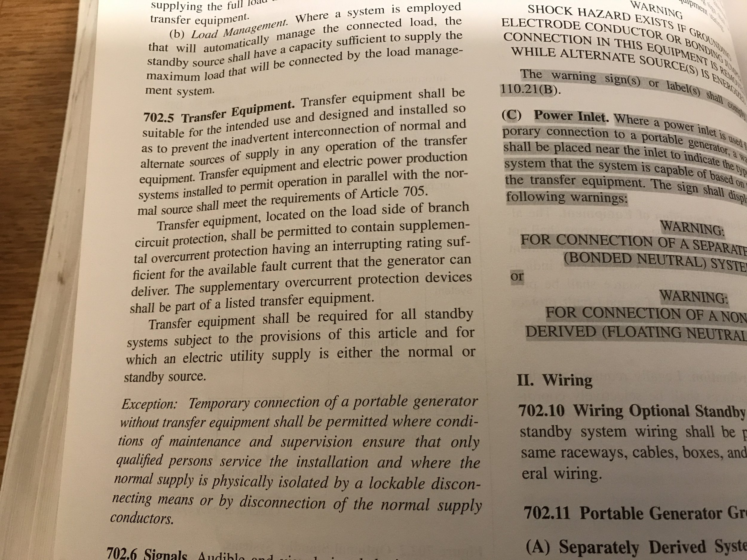

It falls under NEC 702. Its considered optional in that it allows authority having jurisdiction to have final say so, meaning different cities and utilities can have their own requirements. For instance where i live, the public and private utilities send out letters which state that your power can be cut off if they find your not using an interconnect or listed transfer switch.
For non essential uses like home backup, its far more lenient than for emergency backup, but essentially it falls back to authority having jurisdiction . Most utility companies require this, and in the 4 states where i worked as an electrician they required it. I have no idea what state you live in
, so cant comment on your situation.

Uhhhh...thanks. Great info.
(What stare I live in?)
Thanks for affirmation I'm connecting my generator correctly as per your code book.View attachment 772116

Are you? I have no idea whether or not your building dept or utility supplier would agree with this statement. Only your saying they would. Bet they would not.
id just love to see a utility supplier tell someone they dont need an interconnect. Talk about opening themselves up to a lawsuit.
