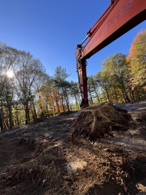

First we dug out the stumps - around 12 in total. All I was able to get was a 36" bucket so I ended up having to dig pretty huge holes; would be curious how different using a frost tooth or smaller bucket would've been. Many of the stumps were 2-3' in diameter and the biggest probably 4'. Holes got filled back in with screened fill in approx 6"-12"lifts and compacted with the bucket.

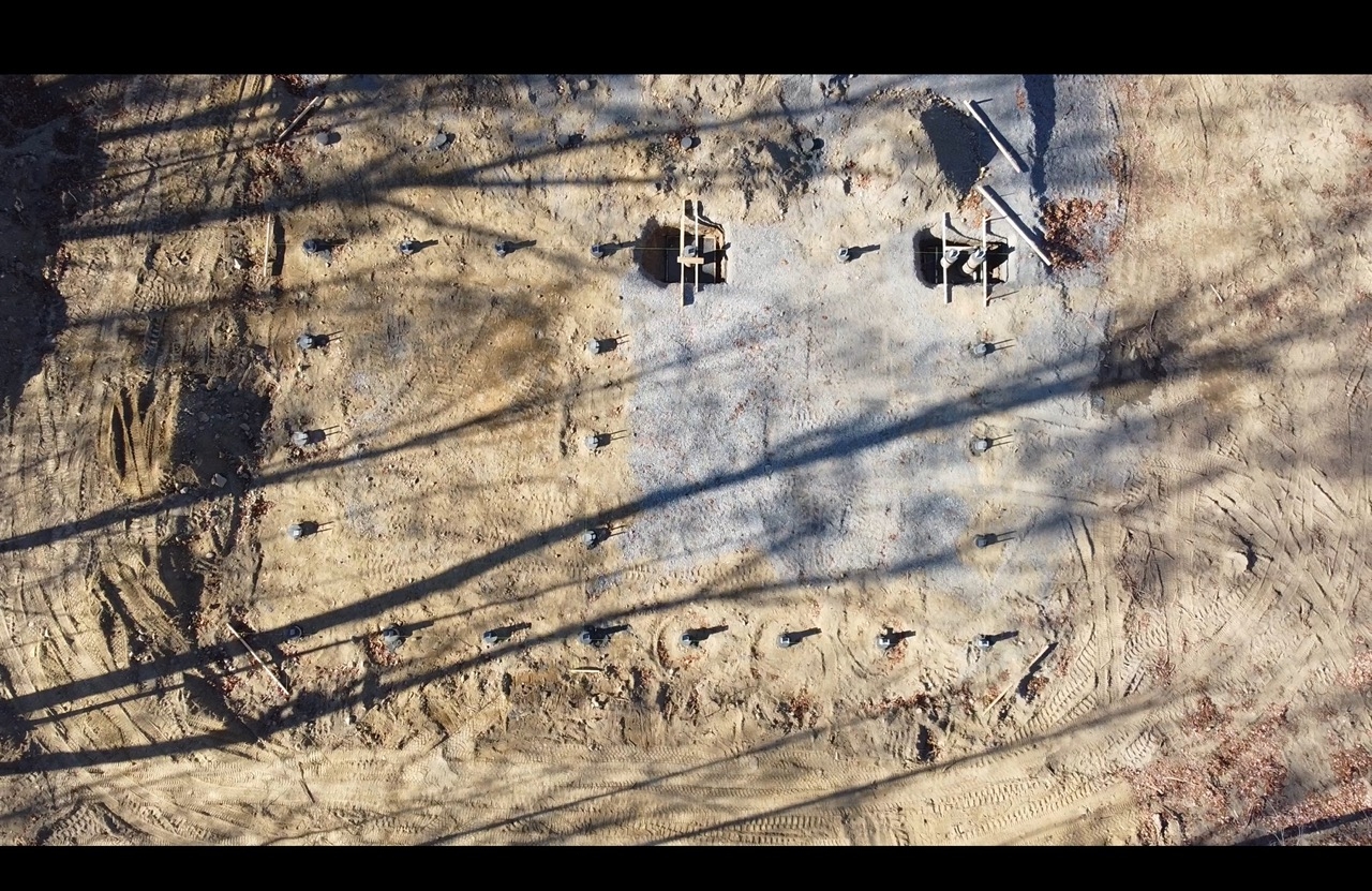

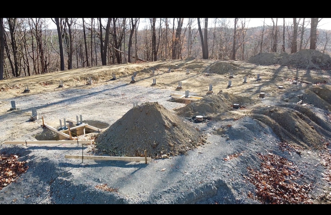

For anyone who's curious about how things turned out, we finished our foundation!
Sadly, the events leading up to that were not smooth. I was pretty convinced that drilling was still going to be an option, so I rented a CAT 3000# skidsteer + auger attachment and bits. I needed a 24" and 36" bit for 24" and 36" Bigfoot respectively; unfortunately I called around and all the 36" bits were rented out, so I settled on a 30", hoping I would be able to widen the holes.
Right after the machine arrived and we connected the auger, we noticed that one of the hydraulic hoses was leaking. We lost half the day for them to come out to service it. This combination of machine and attachments performed much better than the previous one. It wasn't easy drilling, but the machine wasn't stalling out at the slightest resistance. The 24" holes went fairly smoothly, but we weren't able to get 36" holes with the 30" bit, which in retrospect should have been obvious. It wasn't too hard to widen the holes at the top by angling the bits, but the bottoms were too narrow.
After we drilled all the holes, that's when reality hit. We pulled the string-lines back and started placing Bigfoot/sonotubes and realized a lot of the holes were not in the right spot. This was probably a combination of operator error but mostly the bit coming off the mark when hitting rocks. In retrospect, other builders I'd seen on YT were drilling in 1) sandier soil with less rocks, and 2) using larger sonotubes (without Bigfoots), so their margin for error was more. Our engineer specified 10" and 12" sonotubes, which made accuracy much more important.
In the end, I ended up re-digging all of the 36" holes with a mini excavator, and probably 25% of the 24" holes. After that, rebar cages went in all the holes. During all this, I talked to two contractors and they said they would recommend using an excavator to dig these. So the lesson learned was to find out what the locals are doing! That being said, most people I talked to were shocked when I told them we were using 36" Bigfoots.
Either way, glad to have made it to this milestone, and here's some photos.
