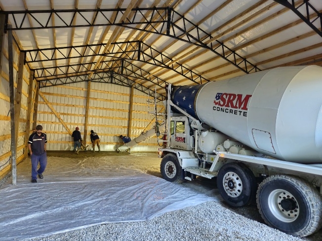

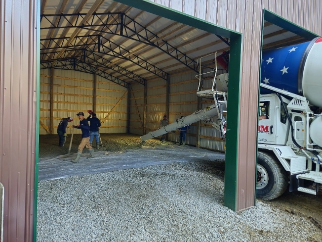

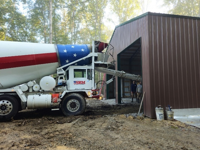

Fiesta Concrete is in the shop....
The doorway was 12' 4" and the truck was 13' 2", so... they dug a hole in front of the 12' opening....
This is not what I envisioned storing inside the shop, but..... it does give a good point of reference for the overhead clearance.
Took two trucks (20 yards) of fiber reinforced cement, with just enough overspill to leave a 2x10 "ramp" at the left door opening. There's hardly any gravel under it, so that's probably just going to be broken up later this afternoon for the gravel....

Why didn't you use rebar?
   / Help Me Design/ Build a Shop #224
It's fiber reinforced concrete, which the builder says doesn't need rebar on a 4" slab. Heaviest moving load will be the F250 and the Kubota.
   / Help Me Design/ Build a Shop #225
I'm sorry to hear that you builder said that. All concrete needs rebar. Fiber helps to a small degree, but it does not replace rebar.
   / Help Me Design/ Build a Shop #226
Well... that's how they pour house slabs here as well -- rebar in the footers, but the slab itself is just fiber concrete. We also don't have expansive soil or deep freezes here, which might be a mitigating difference.
