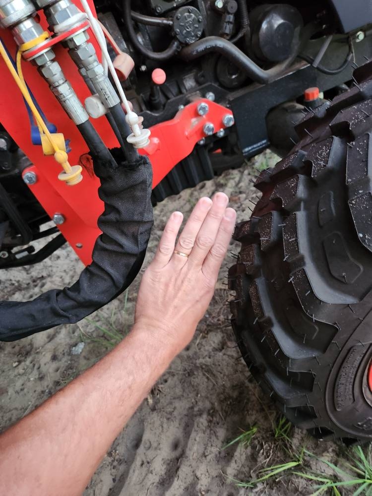

Good to hear you're happy! Do you mind snapping a picture of where your soft hydraulic lines are hanging? I'm wondering if it's the area I'm thinking of.
Your tires sound like they're getting uncomfortably close.
Here is a picture, showing distance from back of front right tire to the hydralic lines. Whne you cut the wheel all the way, the outside edge of that tire gets probably within a 1/2" of the line wrap fabric .

I can't imagine it's much if any different from how it sits on my 2610, but I'll take a look. Maybe I just never noticed how close the wheel cuts.

Here is a picture, showing distance from back of front right tire to the hydralic lines. Whne you cut the wheel all the way, the outside edge of that tire gets probably within a 1/2" of the line wrap fabric .View attachment 819846
Given the position of the connectors and the bracket that holds them to the frame, I'm not seeing many options to increase the clearance. However, if those lines were to droop much more or the tire were to kick up a piece of log, that could be a problem.
Looks like maybe the installer or manufacturer skipped 45 degree elbows and used hoses longer than needed!

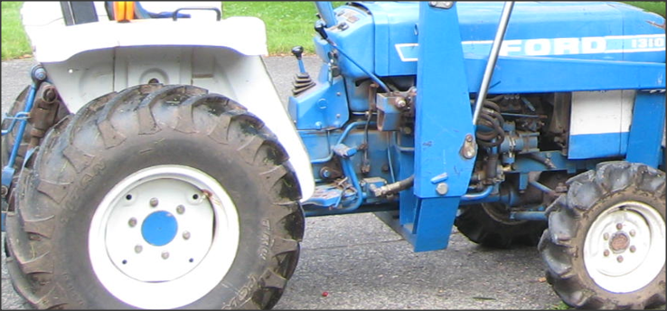

It's too bad Ford sold their tractor business long time ago - they had very good designers, but I suppose their accountants run the business and saw the writing on the wall?

Maybe find an angle adapter at Surplus Center and reposition those hoses?
