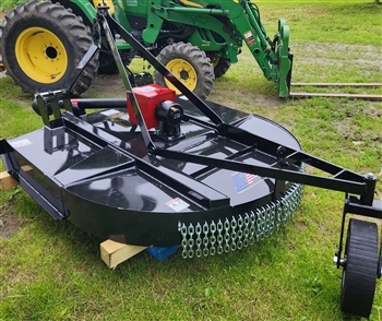

I would question the wisdom of the thin little straps on the back of a bush hog preventing a rear roll over.
I am pretty sure you can have a small child bend the rear braces by hand as 1/4"x2" has very little compression strength. The upright mast is just held on by a single bolt on each side, creating a pivot point.

Not trying to be a jerk. But the photo with the thin little straps is from this link.
I still stand by my point that the thin braces on the bush hog have little stopping power on a rearwards roll.
I mentioned the possibility of a torque wheelie on a hillside. It is a valid point that the trailing wheel will largely remove the weight of the implement from the tractor. And the implement itself will provide some overall stability.
The bars to the top link would generally be designed for tension. A 3 point hitch will tend to float up a little if tension is released with the implement on the ground.
It is definitely not designed as wheelie bar on a dragster, but it may take a little force. An A-Frame design is always good.
