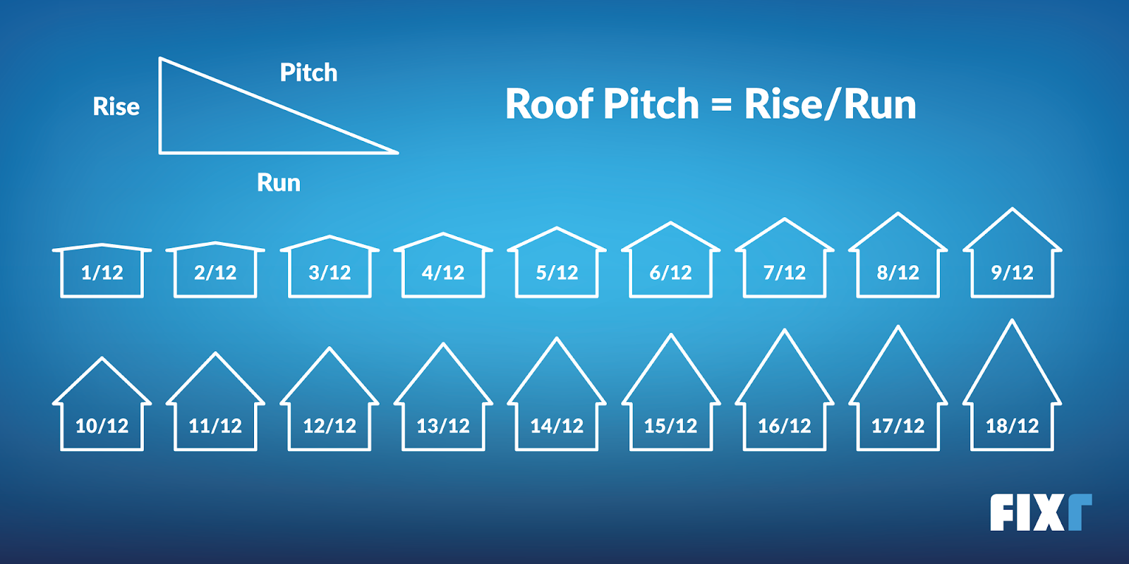

45* is the same as a 12/12 pitch roof.. Highly doubt that anyone is driving on that in any direction.

The general rule of thumb for ground based logging equipment is 40% slope maximum.
And 45 degrees = 100% slope...
Degrees and Percent are not the same. 40% slope is about 22 degrees, which is the same as a 5/12 pitch roof in the pic.
Correct

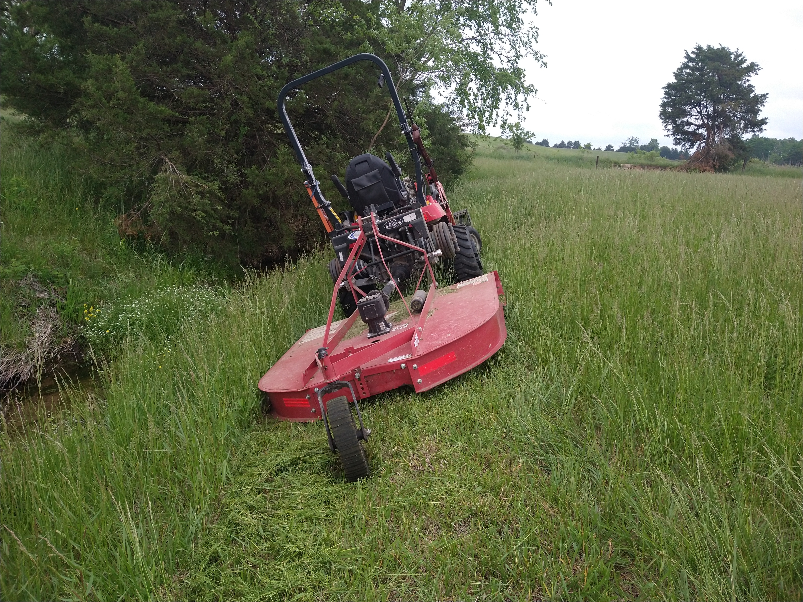

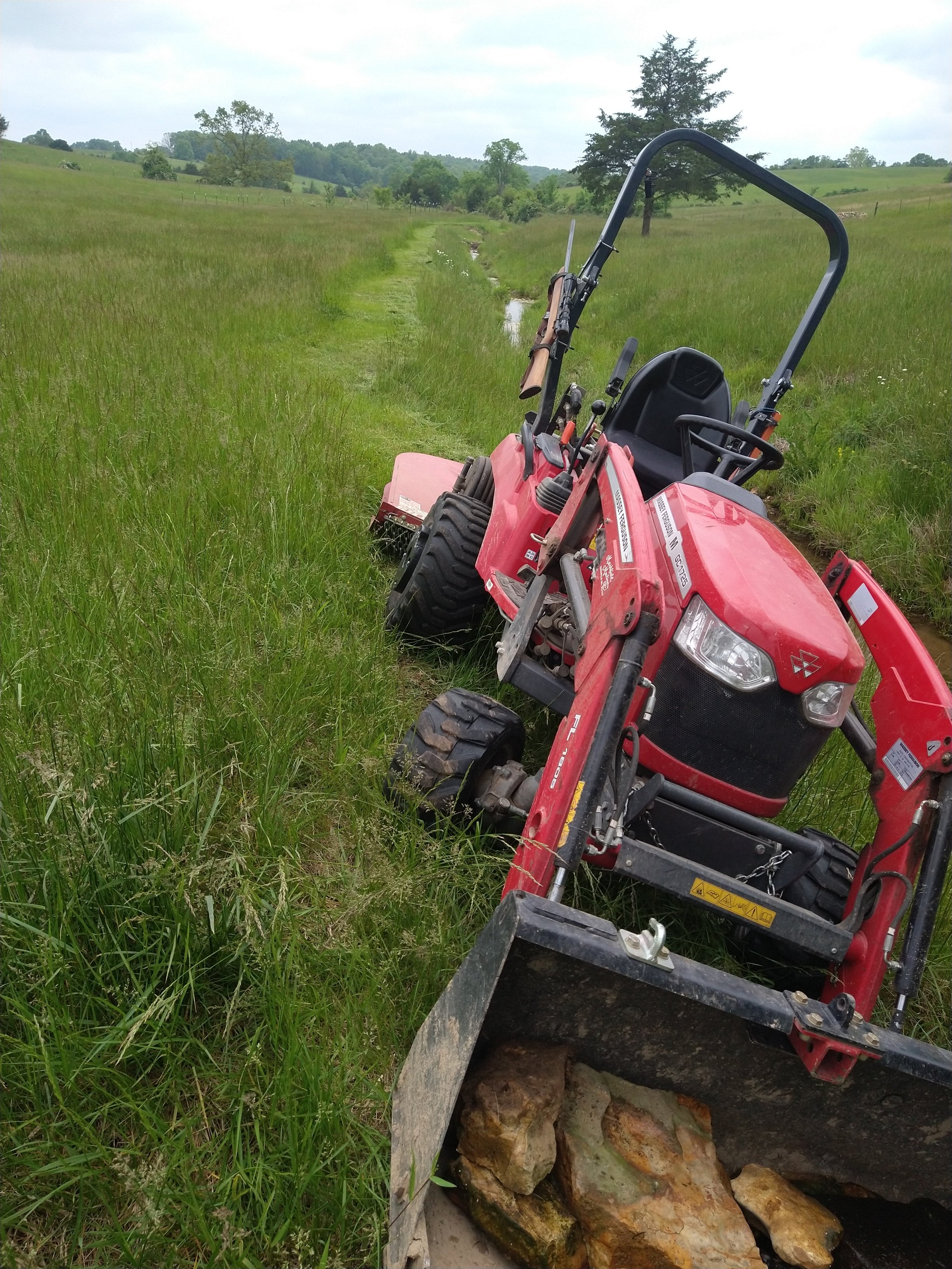

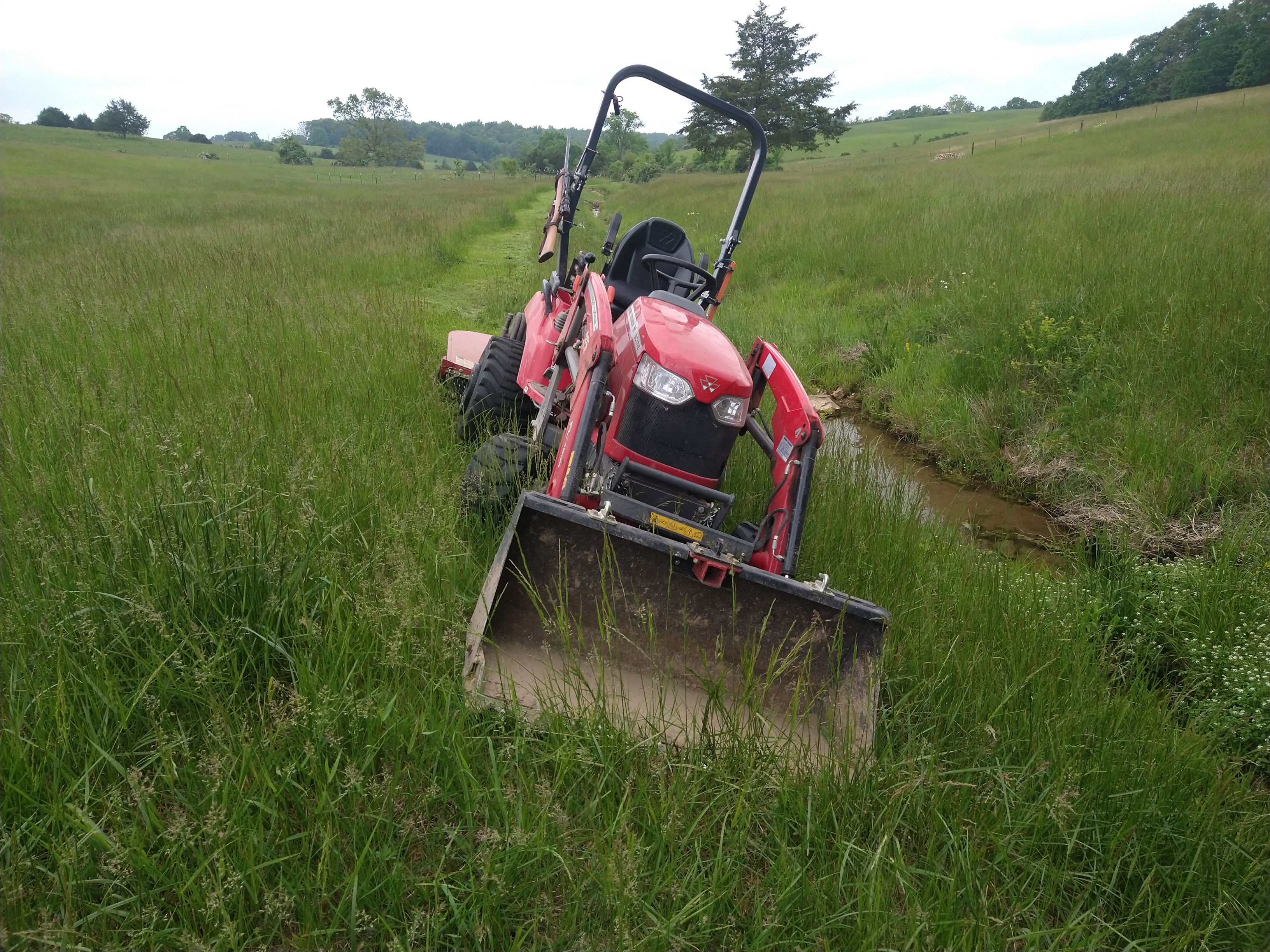

I've thought of buying an Inclinometers for my tractor just for the curiosity factory ...
I know there is a vast difference in how slopes are measured ... Angle, degree, percent ... This is about as steep as my "Butt-O-Meter" would let me go ... And when I got off, I tried ... And couldn't even budge it!!!
The picture isn't quite level, it's a tad steeper ... The Trees are vertical ...

It’s stable until a wheel drops into a hole.
