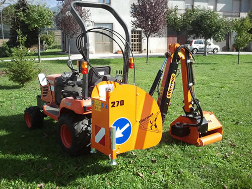

Just recently, driving through Town of Pomona Park, I saw their couple public works guys had a boom mower mounted on a Kubota L2501. It caught my eye, as I haven't seen one mounted on anything below 75hp below. With that, its Small, and although I see the dam backslooe is Steep, how long is it maintenance berm to toe of slope?
Looking online, just quickly, it looks like there are boom mowers that gk as low as only requiring 3968 lbs of tractor weight.
Actually, as i scroll down, they have ones that get even lighter
