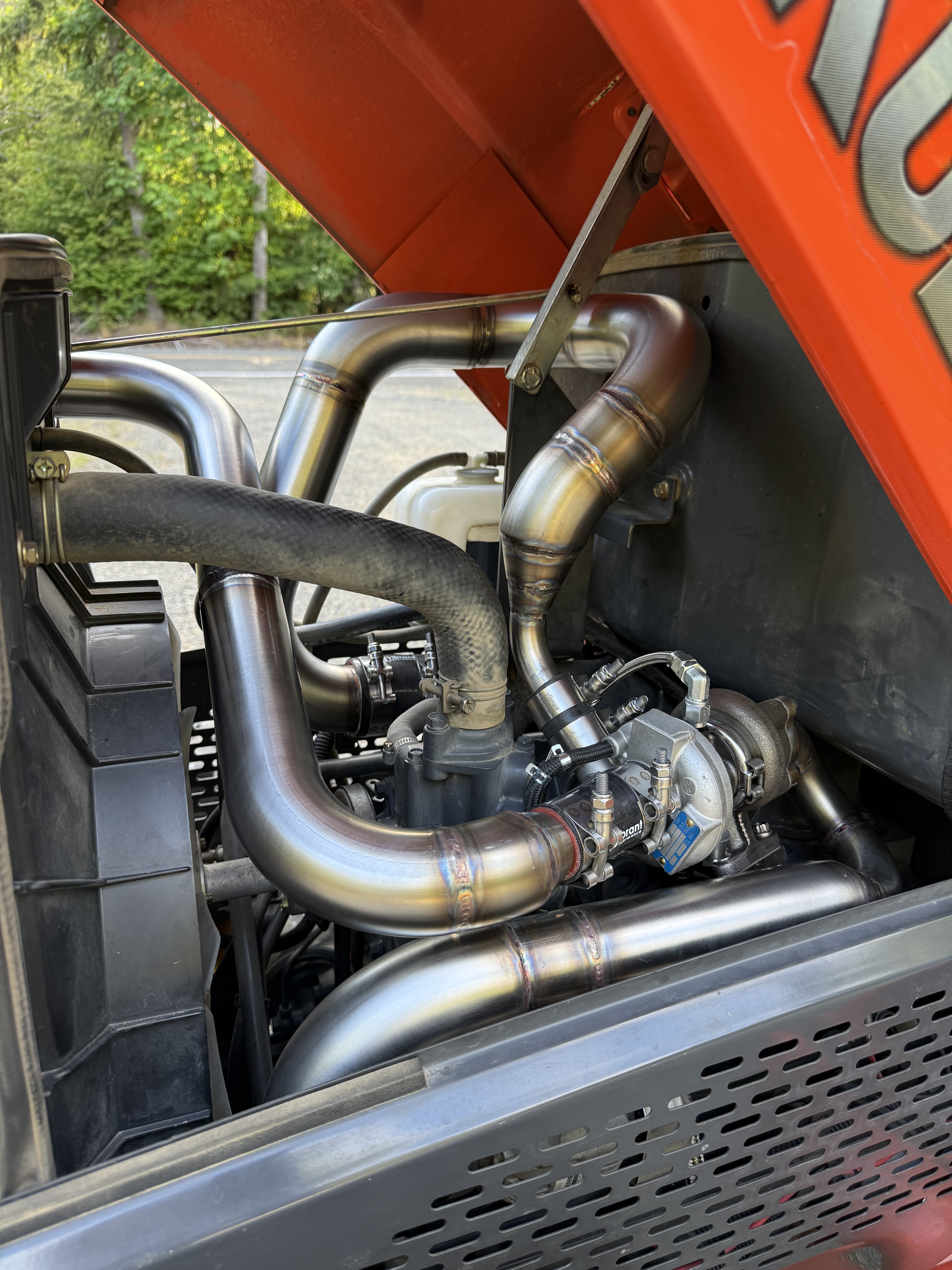

I would agree. Full figured 25HP tractors do struggle especially with a Cab and Backhoe attached. Case in point, the Kubota Grand L Series L3240.
Luckily, alternative options to increase power do exist!
With a Turbo Kit both these tractors are now producing 45HP and 35PTO.

I hope the rest of the tractor, like transmission, differential gears & bearings, PTO etc. can handle that kind of power increase in the long run...
I doubt the designers oversized all of it that much, after all Kubota is in business to make a profit.
Oh well, each to his own.

The same model of the tractor is often offered in various HP variants. In this size of tractors, usually from 25HP up to 50HP, with the only changes being the engine/engine tune. This is the case for pretty much all manufacturers.
My tractor, at one point, was offered in 25HP, 30HP, 35HP, 40HP and 45HP, being the 2 later ones being a 3 cylinder 1.7L turbocharged engine. Now, they reduced it to 25HP, 35HP and 50Hp, while the later one gets a bigger and 4 cylinder 2.3L naturally aspired engine. Same transmission, same frame, same chassis, everything. I believe they only adjusted the gearing in the range gears for the 25HP variant.

The Kubota L-40 line ran from 32 to 57 horsepower, the Kioti CK-10/20 line goes from 25 to 40, the machines can handle it so long as you're reasonably responsible.

Agreed.
And the Kubota Standard L Series goes from 25-39 with a virtually identical PTO train. These tractors without a doubt can handle the power assuming no abuse, proper maintenance and some EGT monitoring due diligence.
There are nearly one hundred Turbocharged Kubota L2501’s operating now and have combined for thousands of hours logged without incident and factory reliability.
