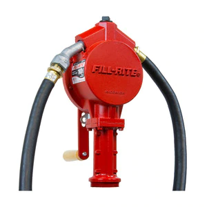

I've used one of the old school hand pumps (mine happens to be from the 50's) and installed a filter on the outlet side of it. Snowing like crazy now so I don't have a picture but pretty much the same as the picture below. Easy, no power needed, fairly fast. Uncomplicated.

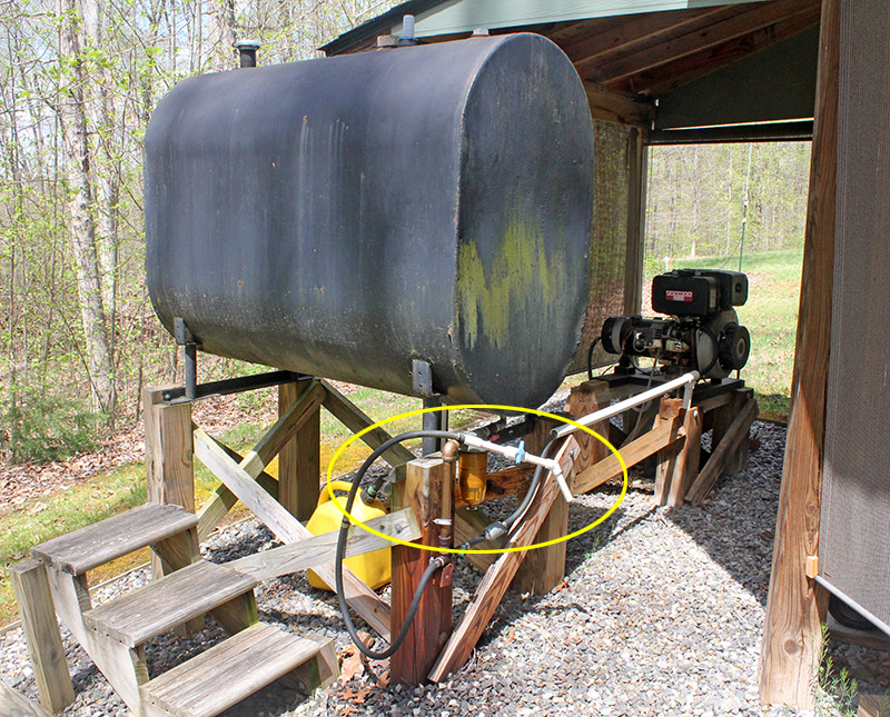

I went whole-hog and bought a used 275-gallon fuel-oil tank. I plumbed it directly to our 6KW diesel generator (emergency backup to the solar power system), and added a hose and nozzle made from PVC pipe and a valve to fill the tractor. Photo is attached.
The generator and the tank live behind our octagonal tractor shed. Here's a link if anyone is interested in that: Octagonal tractor shed

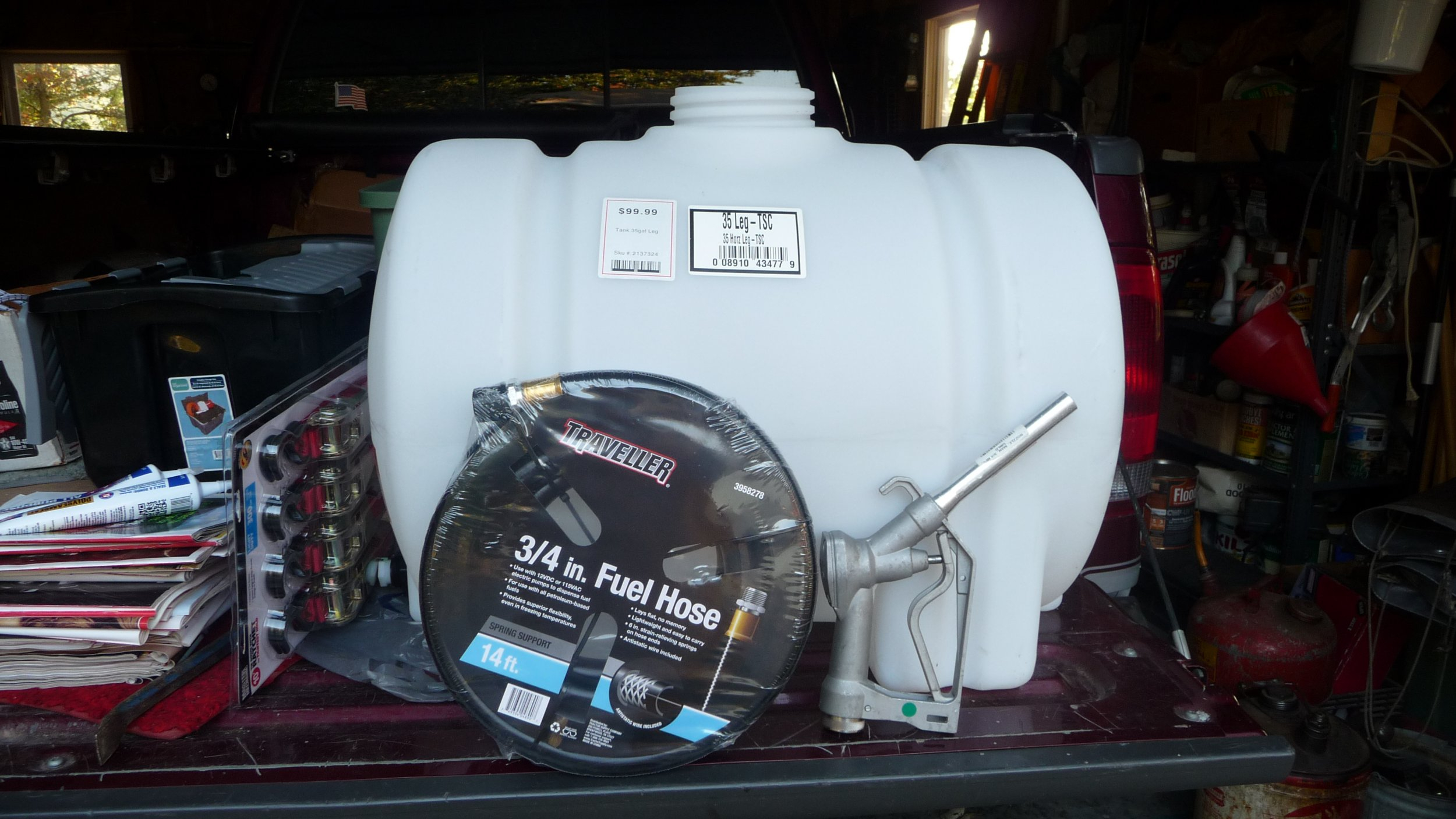

I use one of these 35 gal tanks intended for insecticide and farm chemicals. You do need to replace the gaskets at the outlet with fuel tolerant ones. I find the 35 gal size to be just right for my rate of utilization.

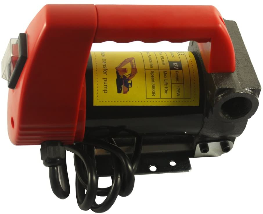

This was all from Tractor Supply. Works fine using gravity feed out of pickup truck or however you move it around. Actually I have an old junker Subaru wagon at the farm and this fits in the back of the Subaru nicely. Use a large heavy plastic pan under it for spills. Then I got tired of waiting on the slow gravity feed and the nuisance of finding high and low ground adjacent, etc. ... so I bought a 12v pump via Amazon Amazon.com: New 12V 175W Biodiesel Kerosene Pump Cast Fuel Oil Diesel Transfer Pump 45L/Min: Automotive which is so much handier and quicker. It pumps 12 gal per minute. I attached some transparent hose so I can watch the fuel flow. Also I drive the pump typically with a battery charger so I can plug it in the wall of the garage but it is nice to be able to use 12v when needed too.
