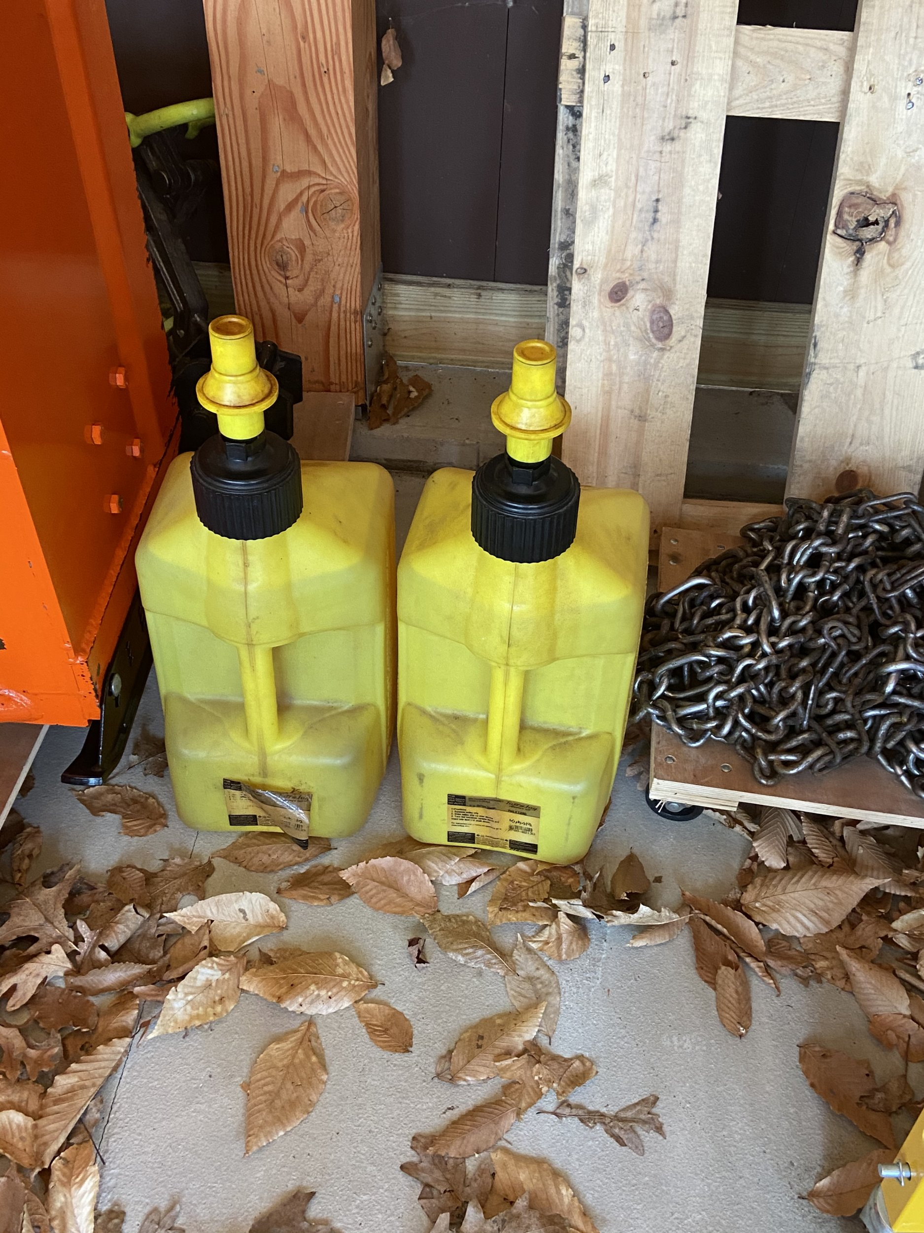

Here is what I use for my L3560 (~10 gallon tank). The 25 gallon rolling carboy has an integrated hand rotary pump and grounding wire for use in fueling and I also use that for when I refill the tank laying down in the back of my pickup (i ground to truck frame and keep diesel nozzle in full contact of container when filling). The downside is that I need to use my shop gantry to lift the filled carboy up out of the pickup truck bed, drive off and then lower in upright position onto shed floor. I have a ramp to the truck bed but the filled carboy is way to heavy to use the ramp. I also use the pictured 5 gallon cans as they work really well with my L3560 Kubota and are useful when I need 5 gallons when away from shop. The locking collar and air relief actually work well and sometimes with no drips at all and the cans drain completely. The yellow rolling carboy/pump set up came from Northern Tools. I got the cans from my local Kubota dealer.
