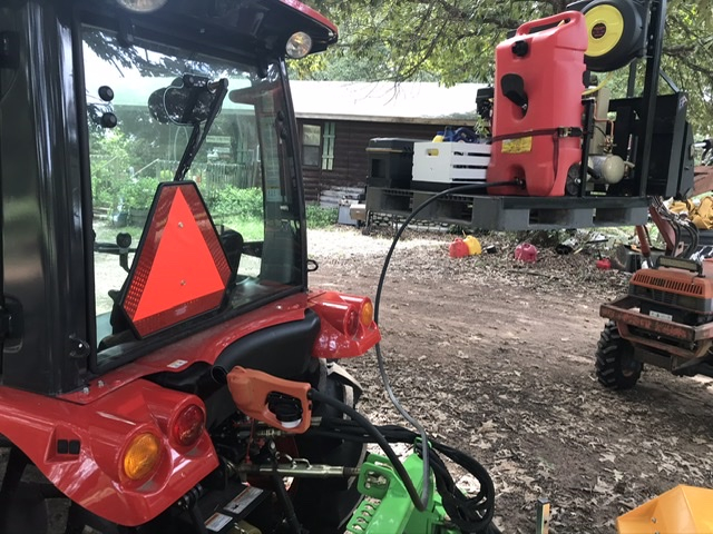

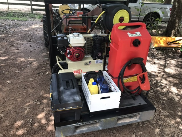

   / Fueling tractor #4
Here is what I did.
28CEC923-3AF6-4EB2-9111-C41B016055C1.jpeg DD769D43-6826-4FAB-AAC1-5840606933D8.jpeg
