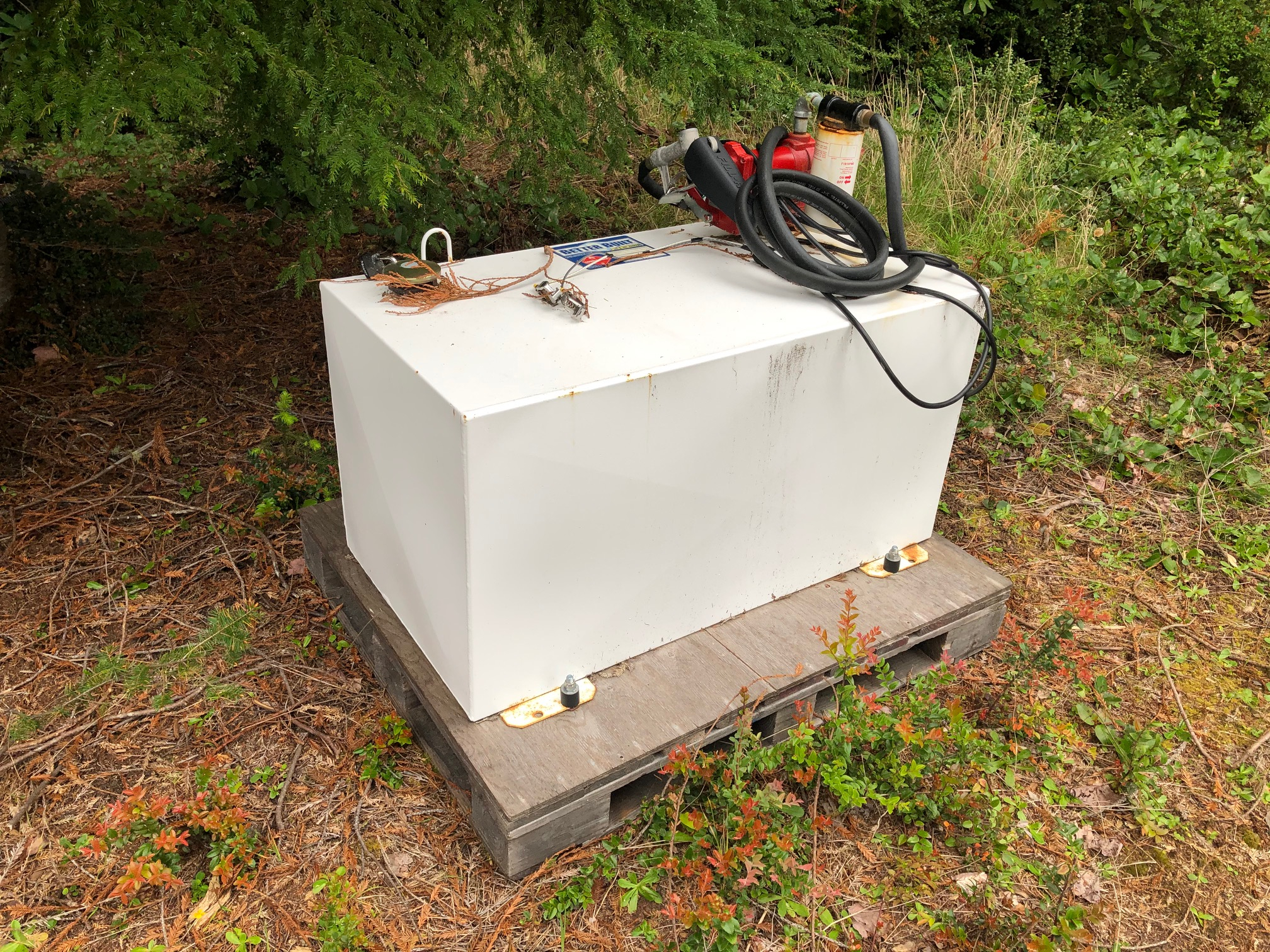

I got tired of 5 gal cans so got this 100 gal transfer tank and put it on a pallet. The pallet is reinforced with plywood for stiffness. The tank is mounted on rubber bumpers that allow the pallet to flex without stressing the tank. To avoid cracks.
I put it in back of the truck to take to the gas station, and then put it wherever it is out of the way when not in use. The fill-rite pump runs off the tractor battery. Works fine.
I have a round 150 gallon tank gravity system set on a 6' high platform that I used for 10 years without trouble. The only stinker was to lift it off empty and it back on the platform full using tractor forks. I hate to drop tanks and to get a tractor with more capacity doesn't seem logical just for lifting fuel tanks. We don't have delivery and I am done toting 5 gallon cans.
To make it better for in an emergency my wife could load it on the back of the truck I made a set-up almost like yours only with a 55 gallon tank with a Fill-rite 13? gallon/min flow. Uses DC which I mounted a tractor battery on the platform to run the pump. Fill up twice a year.
