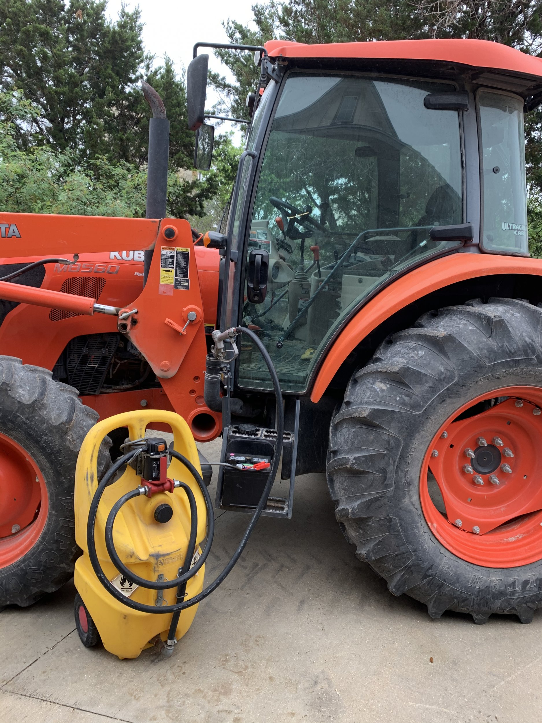

I use a 15 gallon EmilCaddy. Often I fill the tractor next to the truck so that I don’t have to lift the tank out of the truck full.
