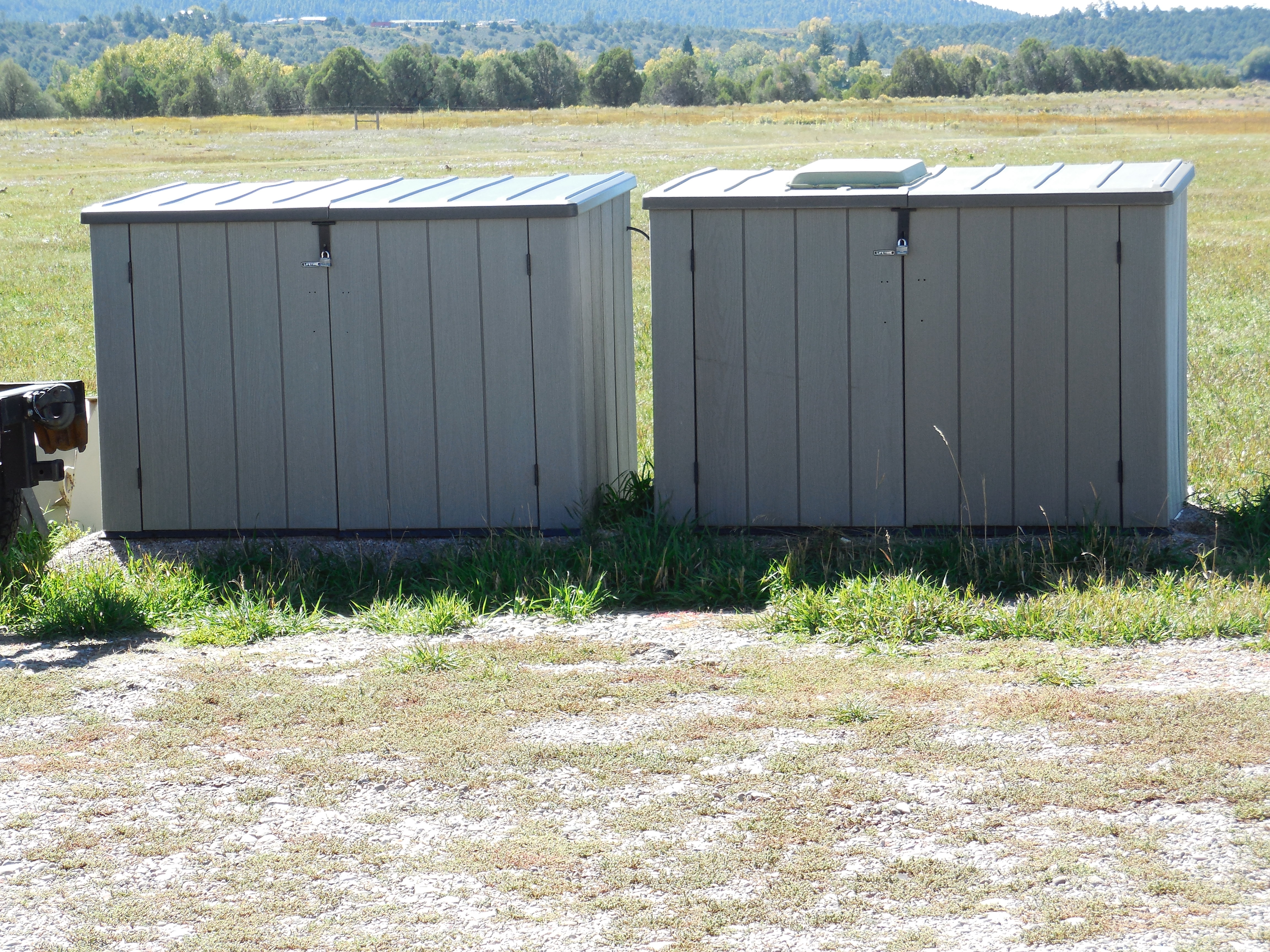

Please do your local firefighters a favor and label the "sheds" with a hazard placard so they know what is inside them. The placards are numbered so no one knows what you have inside except a trained first responder.
I think they'd appreciate it even more if i placarded the two covered trailers with up to 800 gallons of diesel in plastic totes that sit fairly close to the house, and with more combustibles nearby.
Of course, those trailers would be moved away if there's a fire heading our way - if I'm home, which is generally the case.

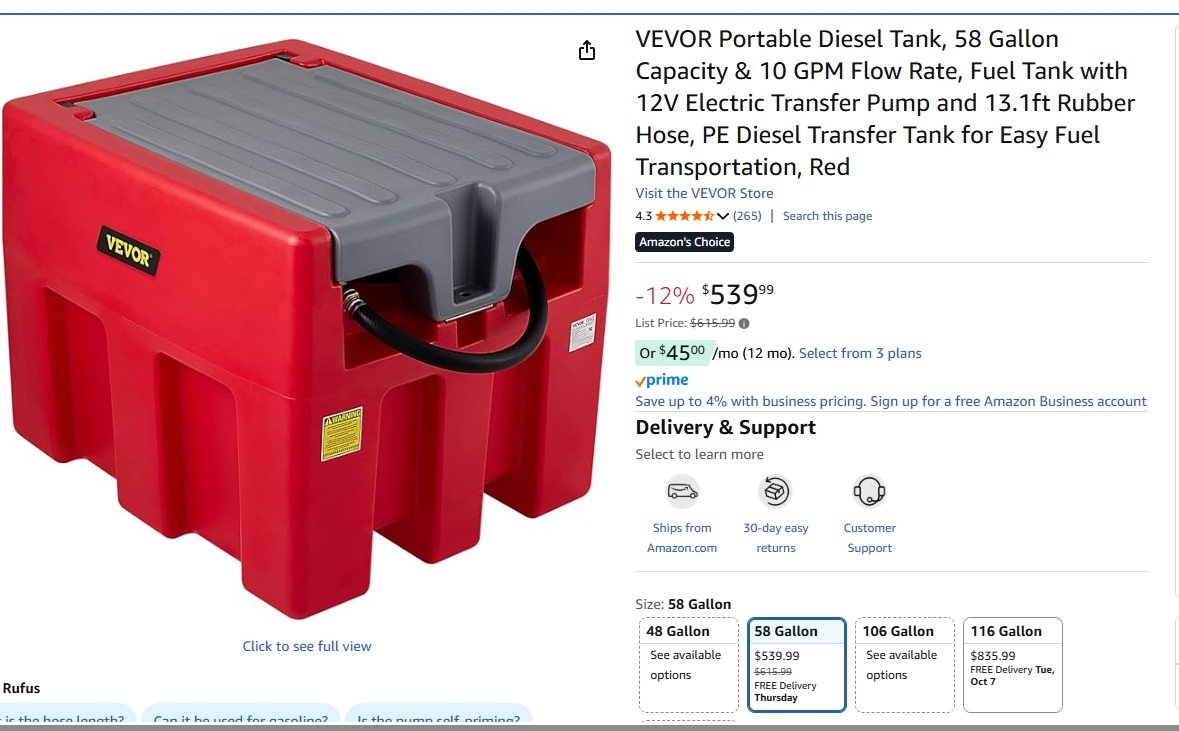

I recently bought one of these ---> https://www.amazon.com/dp/B0BL794Z6V?ref=ppx_yo2ov_dt_b_fed_asin_title&th=1.
I have it on a pallet I load into my pickup and fill it up whenever the prices drop.
They also have a 75 gallon one.
A stationary take has a lot of environmental policies you have to follow and normally a minimum amount before a truck will come and fill you up.

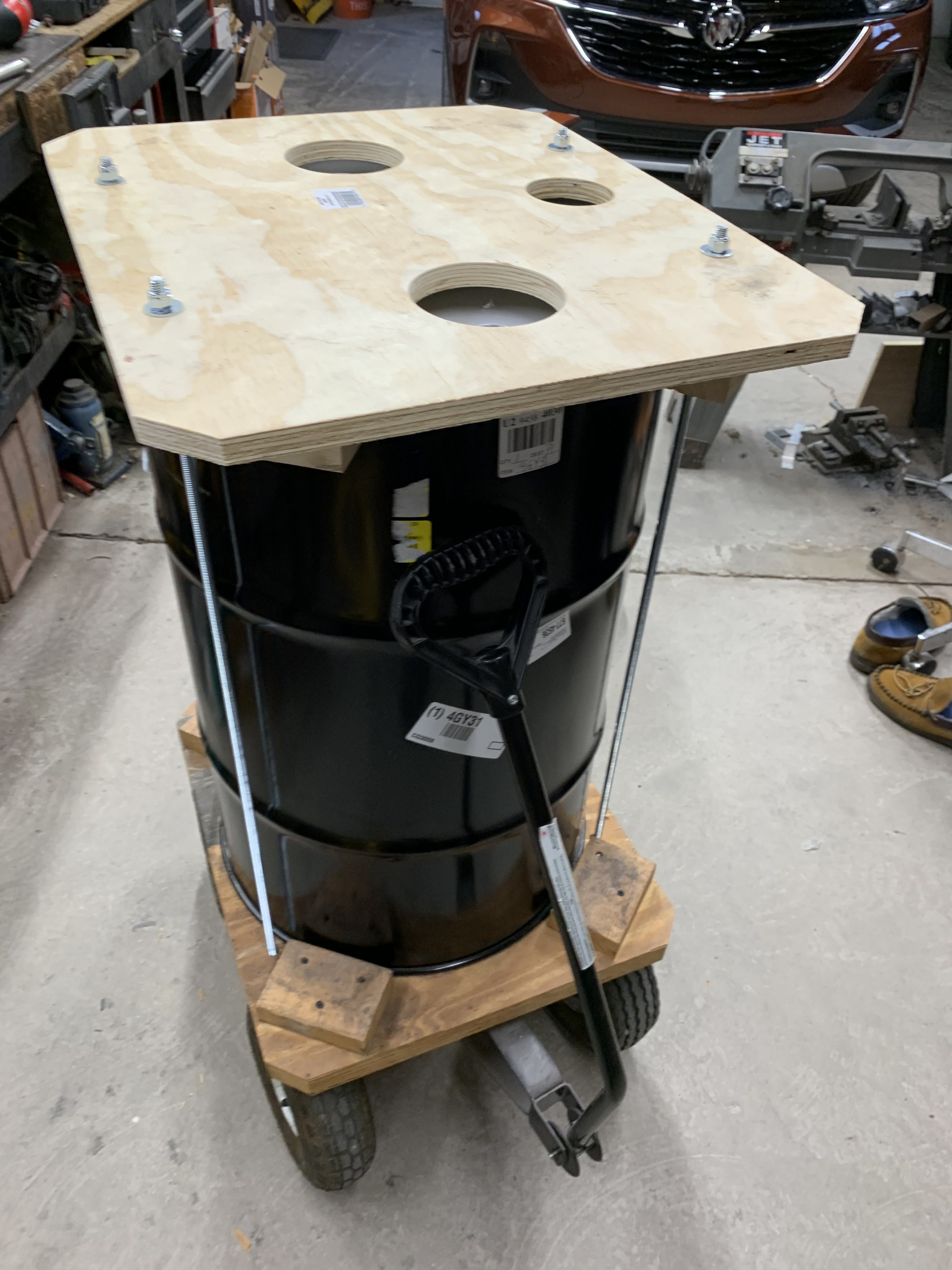

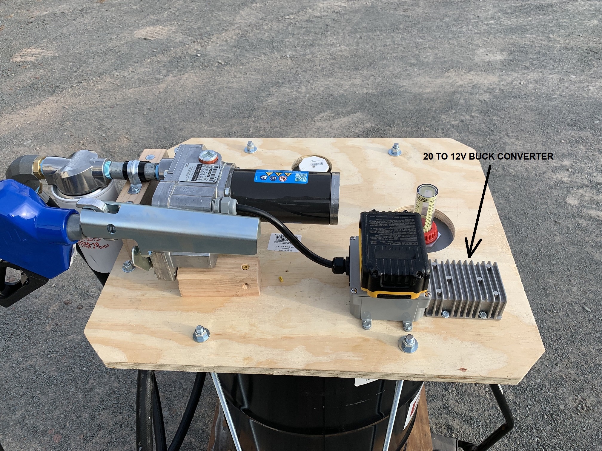

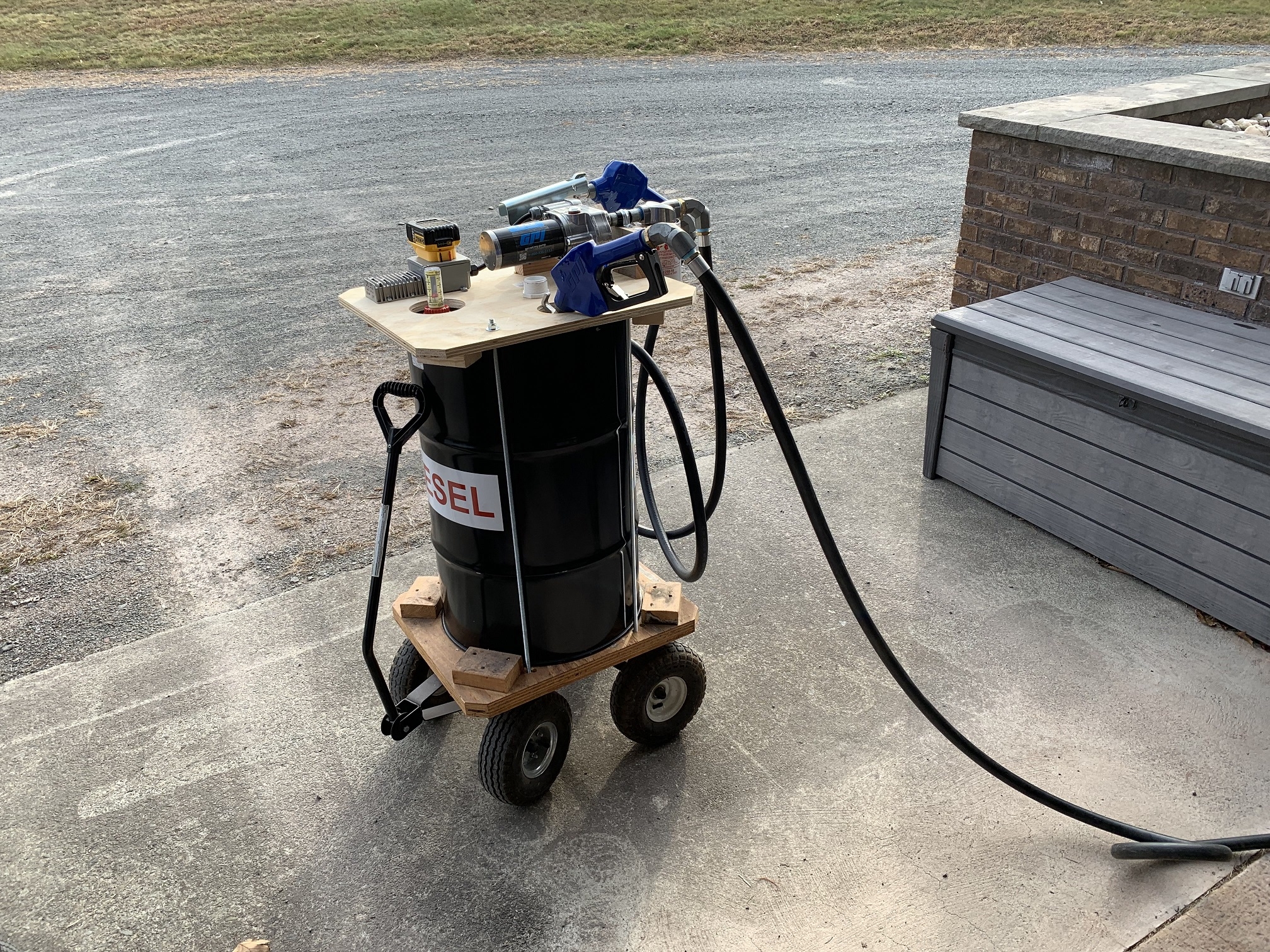

I have around 5 acres and cut 4 ish with tractor and riding mower and I also mow 2 ish miles of shoulders and whatever snow removal for our development.

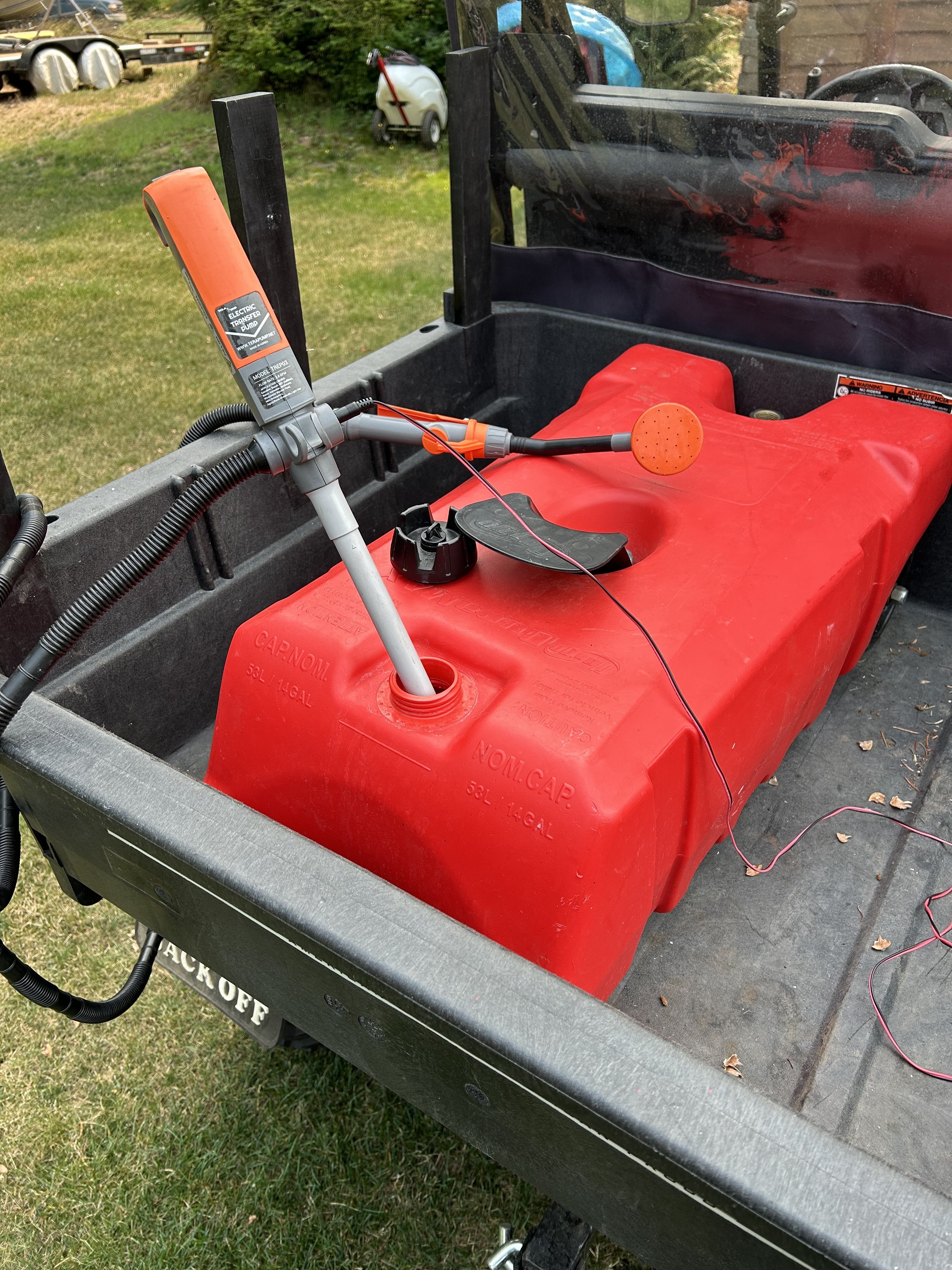

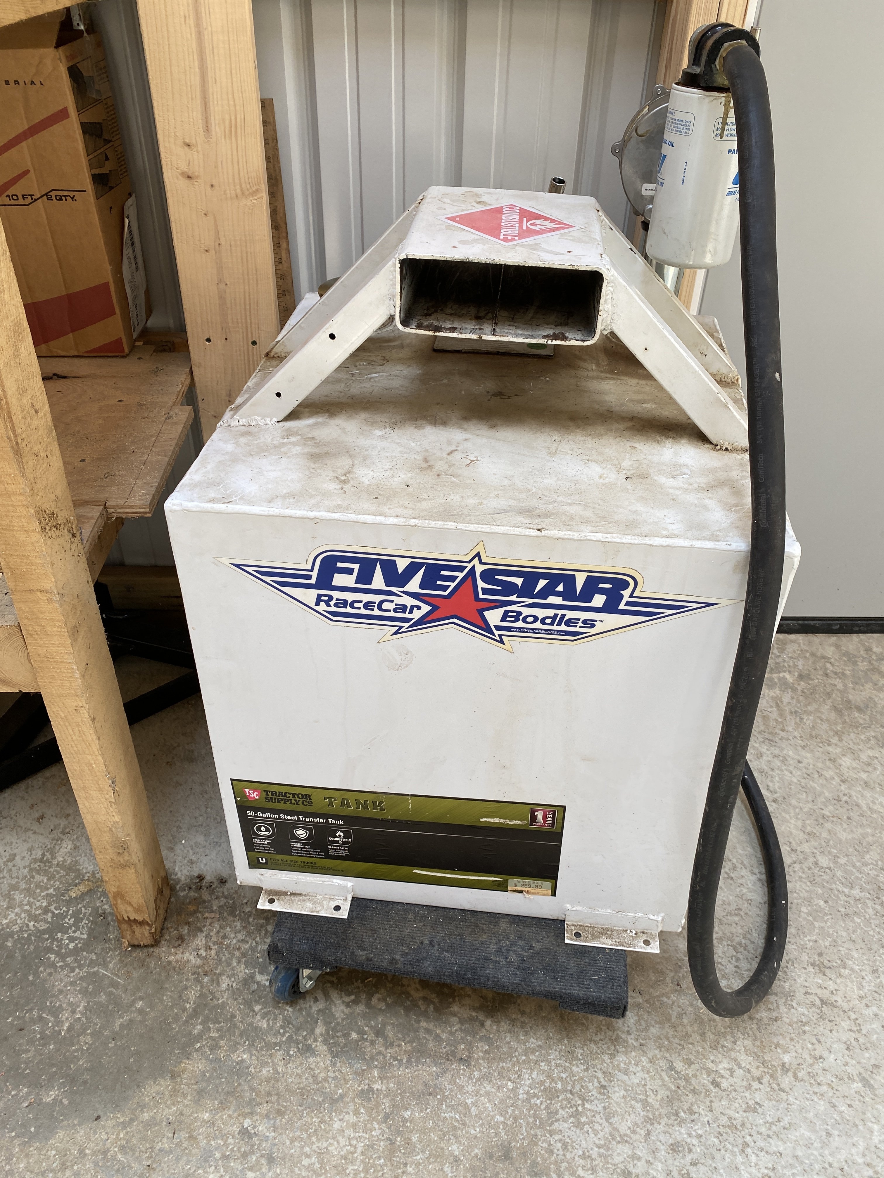

I gave up on 5 gal jugs a few years ago and went to 4-14 gal tanks, 2 for gas and 2 for diesel. I use StaBil "storage" year round in the gas tanks as I don't know how much fuel I'll use from one year to the next. They have wheels so the wife and I can still move them around and I can still take them down from the pu when full or, a few years from now, I can use the tractor to do it.

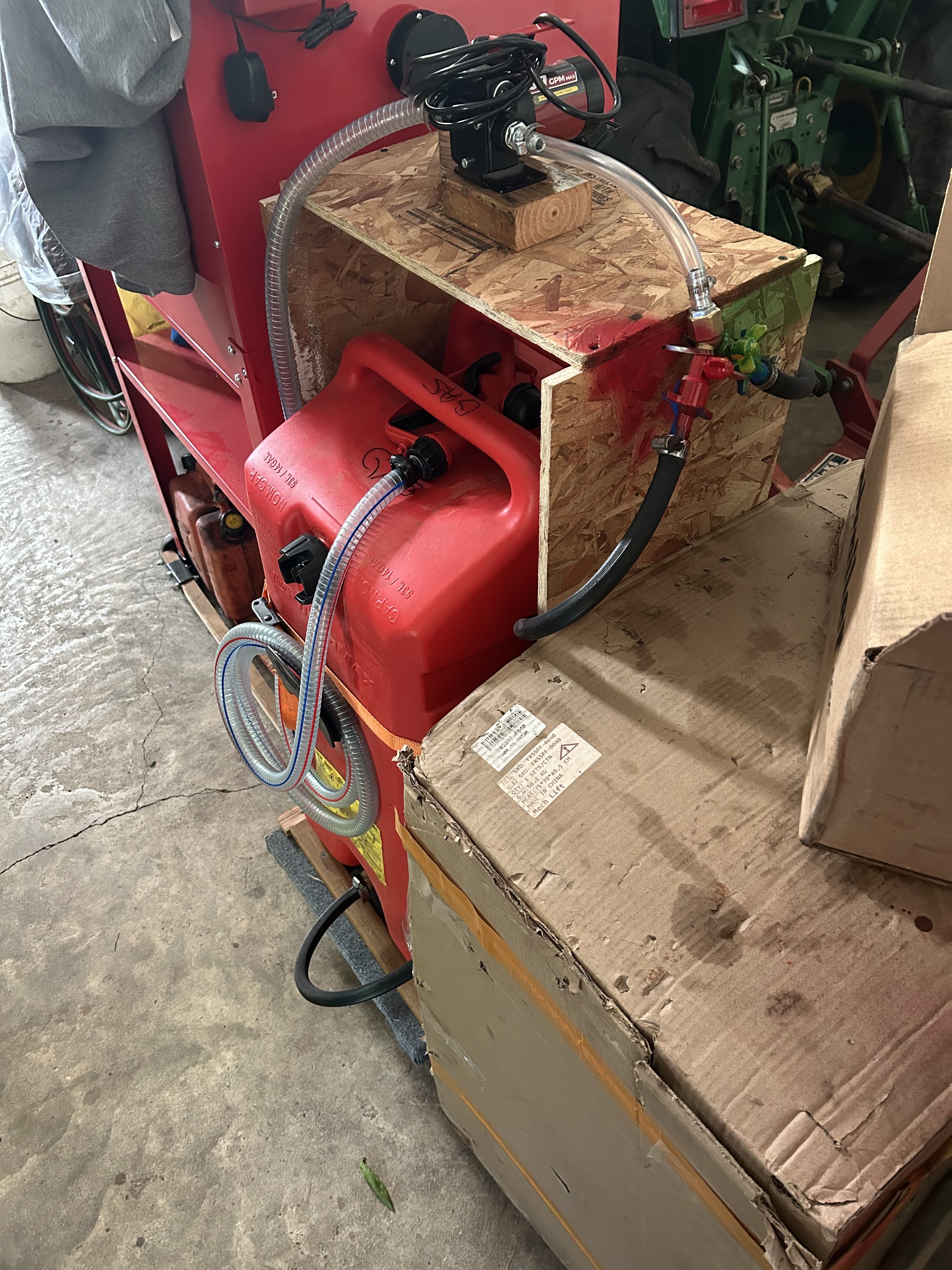

I used to lay it down, like the one in the sxs for the wife for watering her outdoor plants, when using them with a 12v/120v stick pump but they only lasted around a year or so, so I made my own fuel station. It has a reversible 120v gas/diesel compatible pump. A work in progress but I can use diesel and gas at one time. I run a 3 way valve to split the diesel and gas and make sure to drain the hose after each fill up. It's on a HF dolly.
I kept the "stick pump" for the emergency "ran out of gas" situations as it also has clips for a battery hook up. I did keep a 2 gal jug for the pressure washers and stuff with the smaller tanks for the shed so I don't have to drag them up to the shop where the tanks are.
