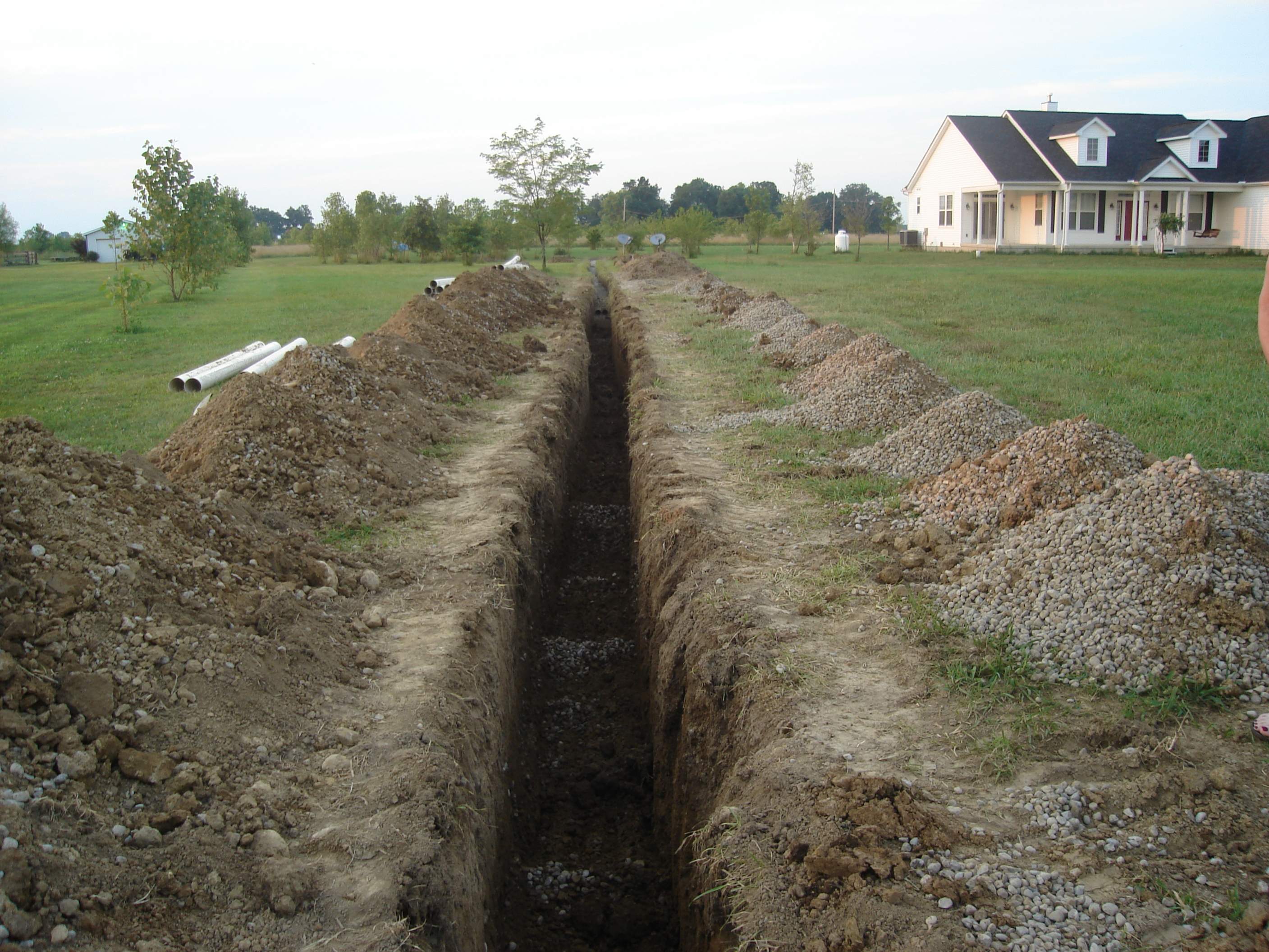

The bottom of the trench needs to be real smooth, rounded to cup the tile. If you put a plastic tile on a flat bottom trench, throw dirt on top, it will deform the tile into a D shape with the weight of dirt and the air spaces on the bottom - over time this could collapse the tile as things settle. with the tile in it's cuped trench, put loose small soil on top of the tile, so no rocks or big hard lumps of dirt are on it - they tend to collapse the tile. Then you can use your loader to fill in the trench with the rest of the dirt.
You can make a little 1/2 moon piece of metal blade to bolt or weld to your backhoe bucket to form that 1/2 moon shape of the bottom of the trench - or just get in there with a shovel and make a smooth 1/2 moon groove to cradle the tile. It is real real real important to have a very smooth, level trench bottom, no ups and downs. If there are ups and downs, the dirt in the water, over many years there is always a tiny little bit of dirt - will pack into the low spots of the tile and plug it up. Need a smooth bottom.

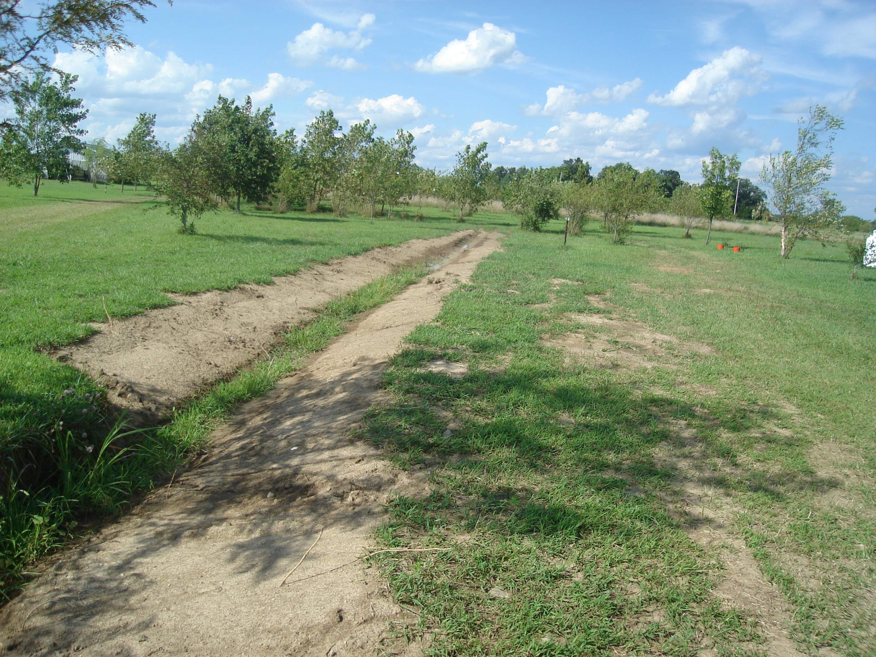

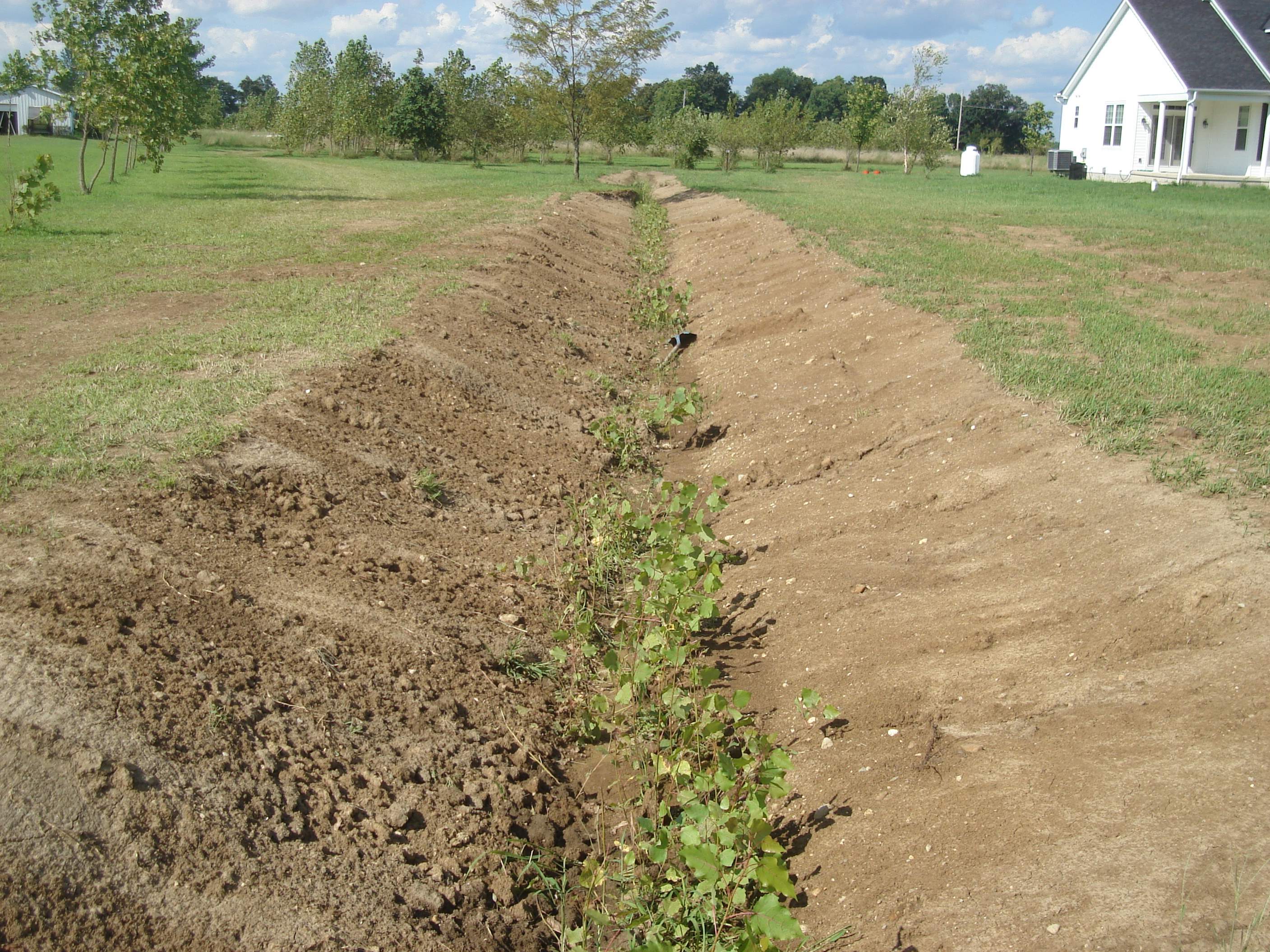

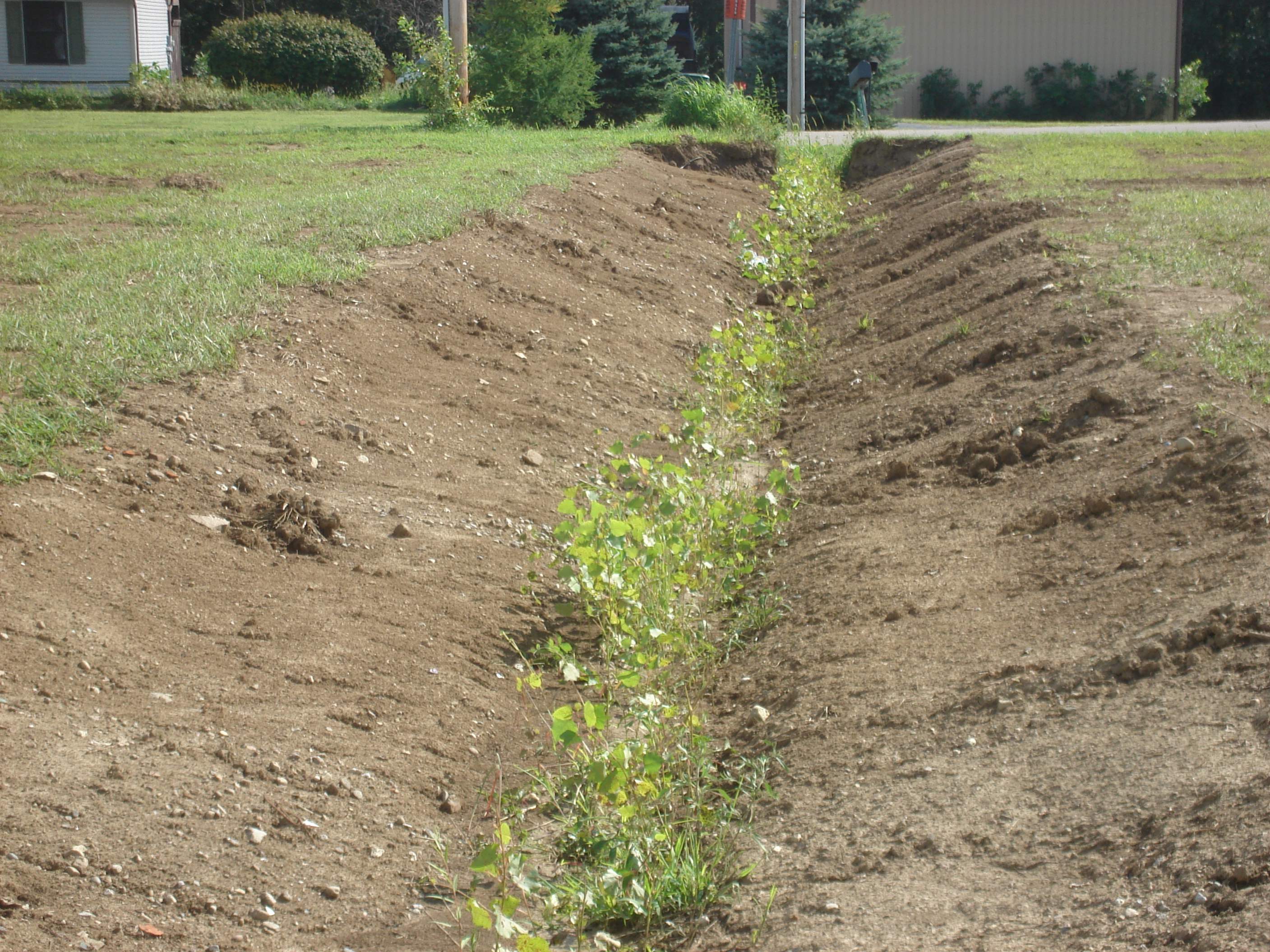

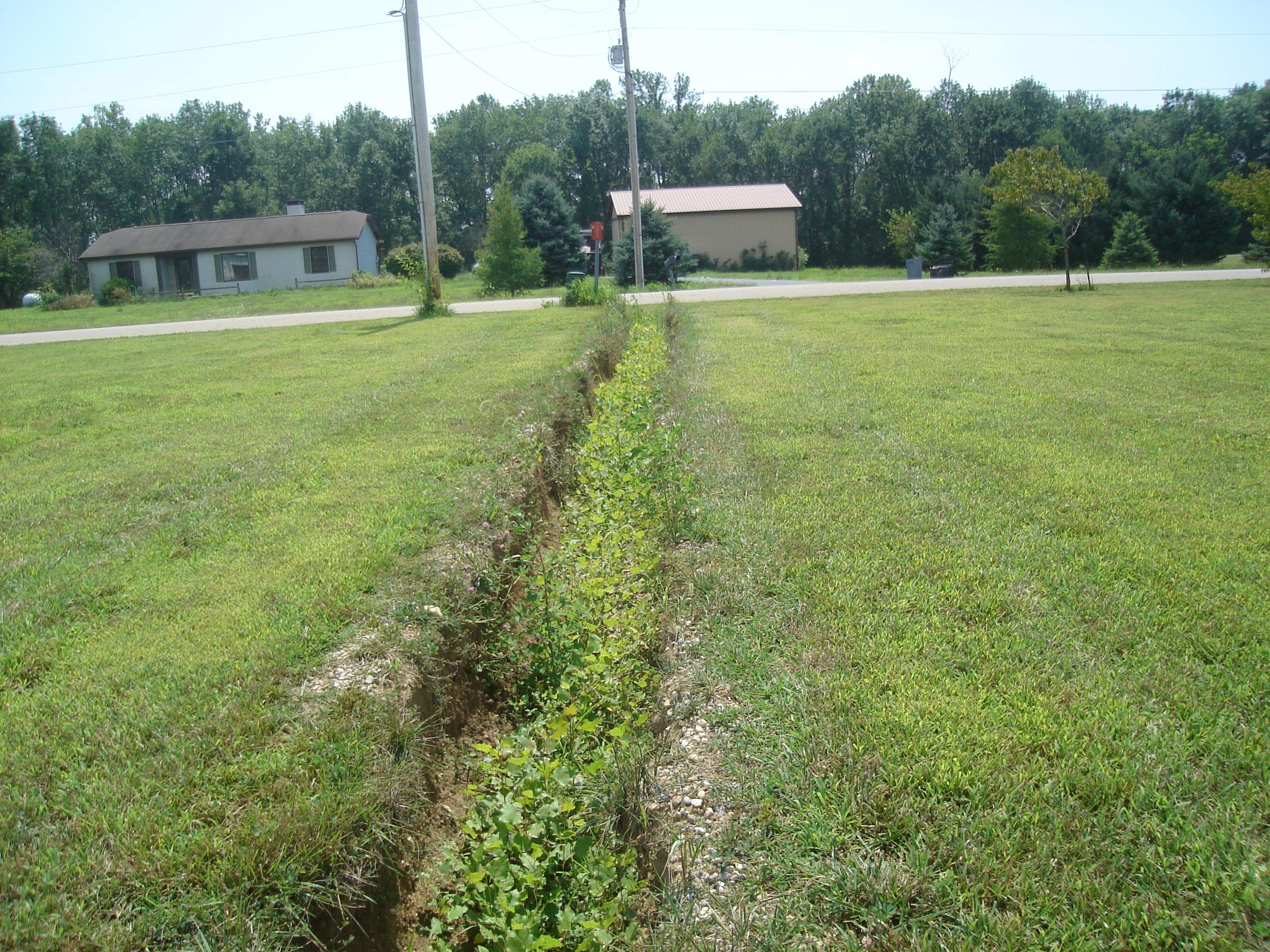

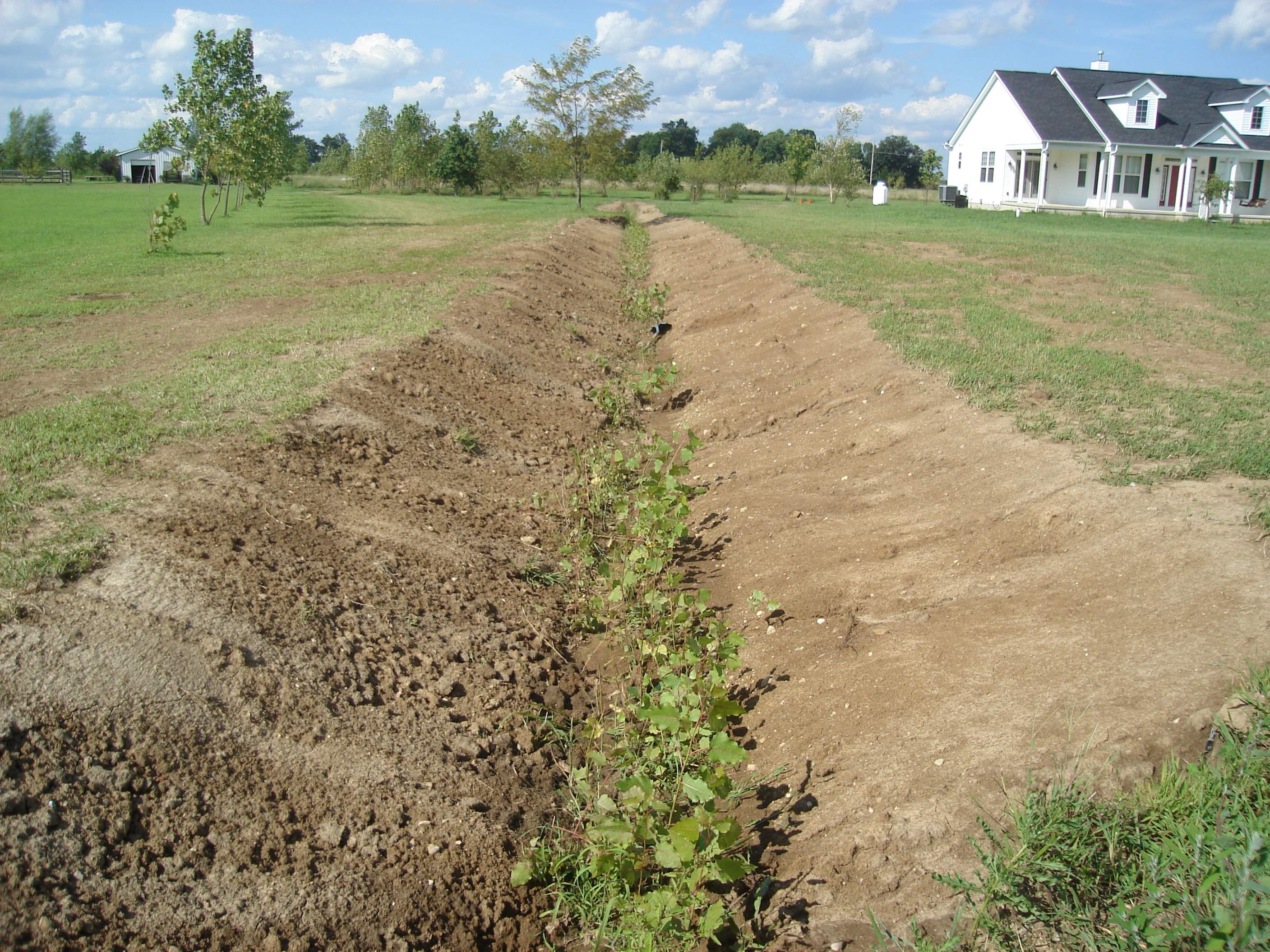

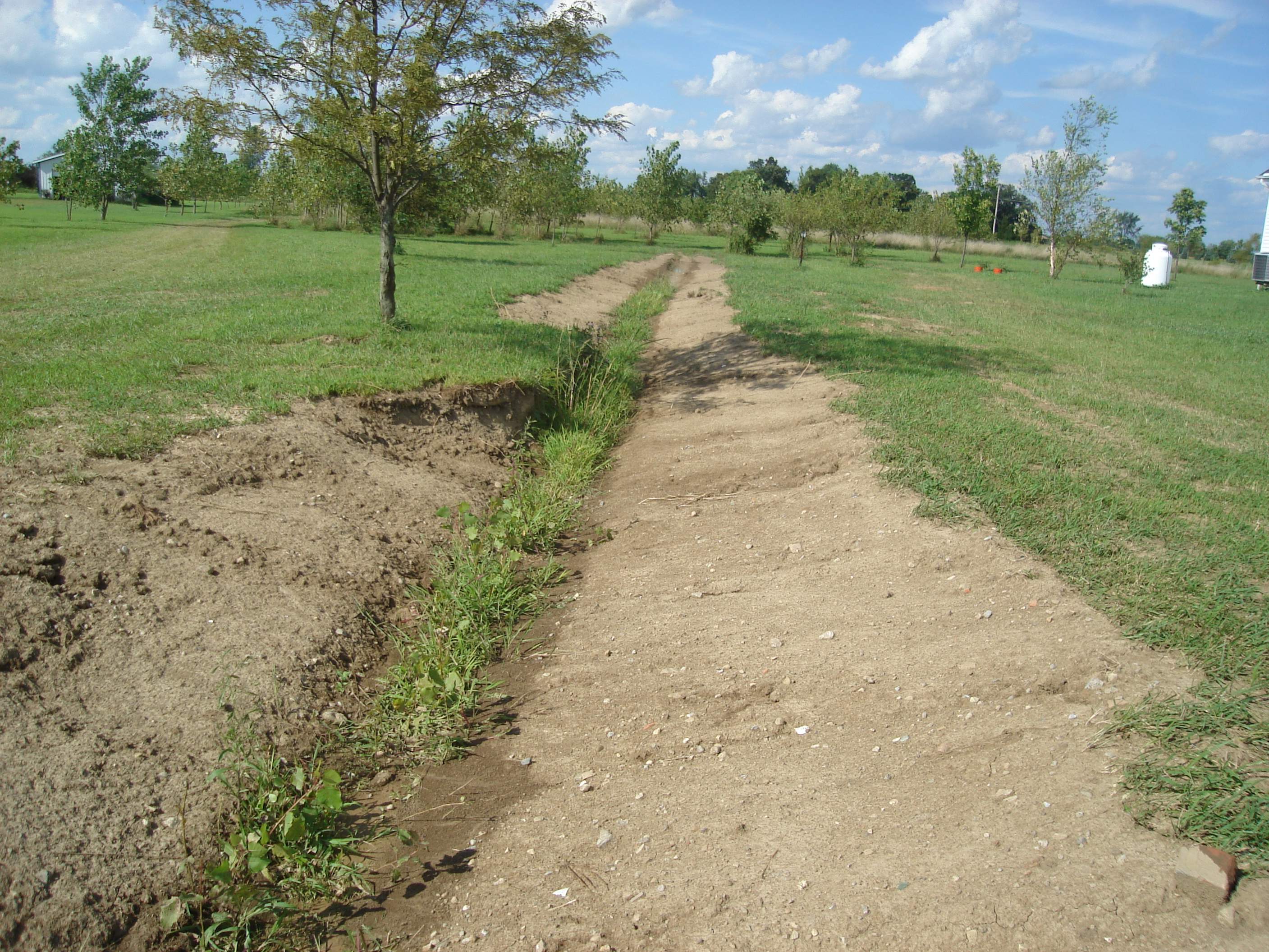

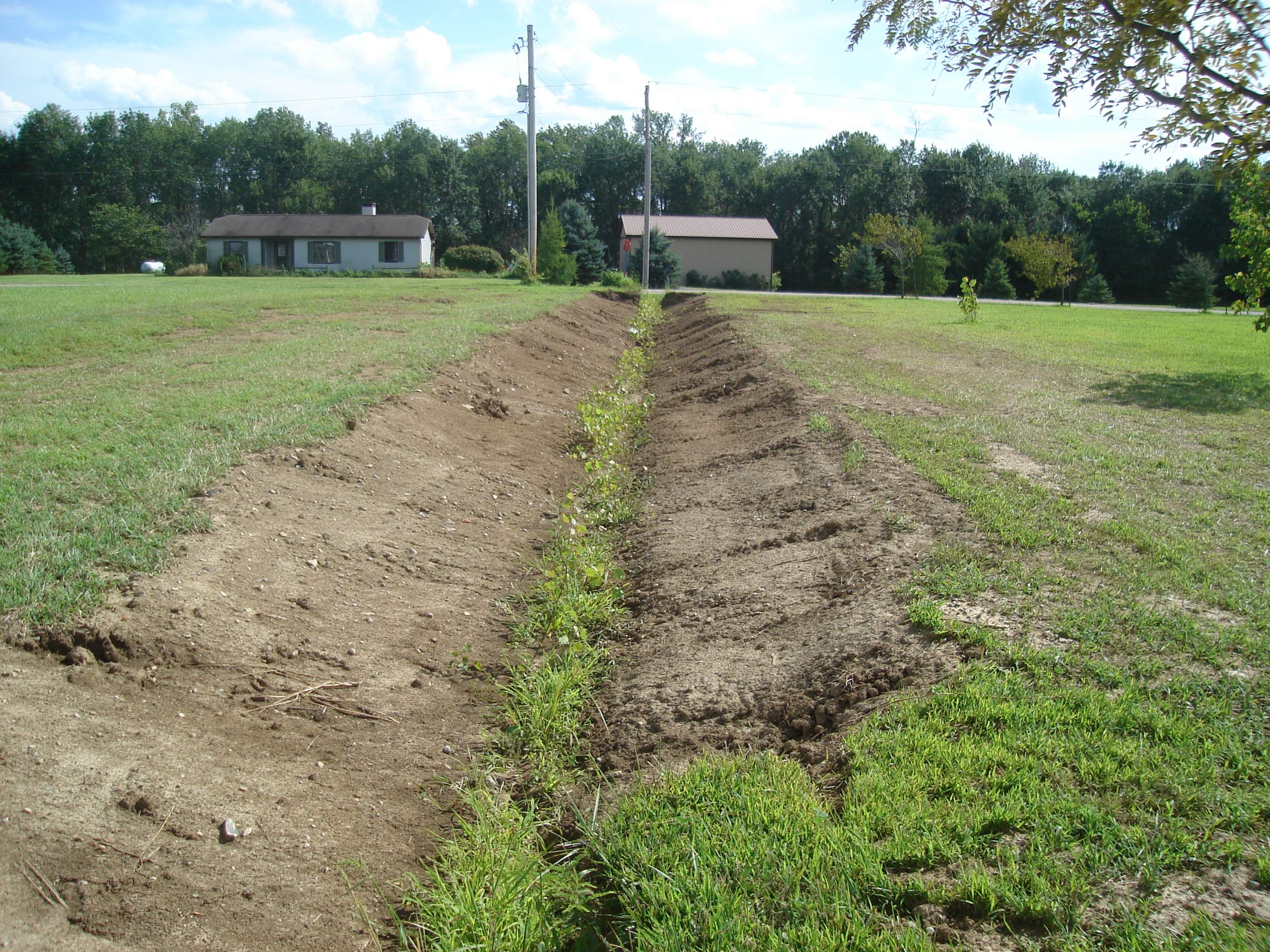

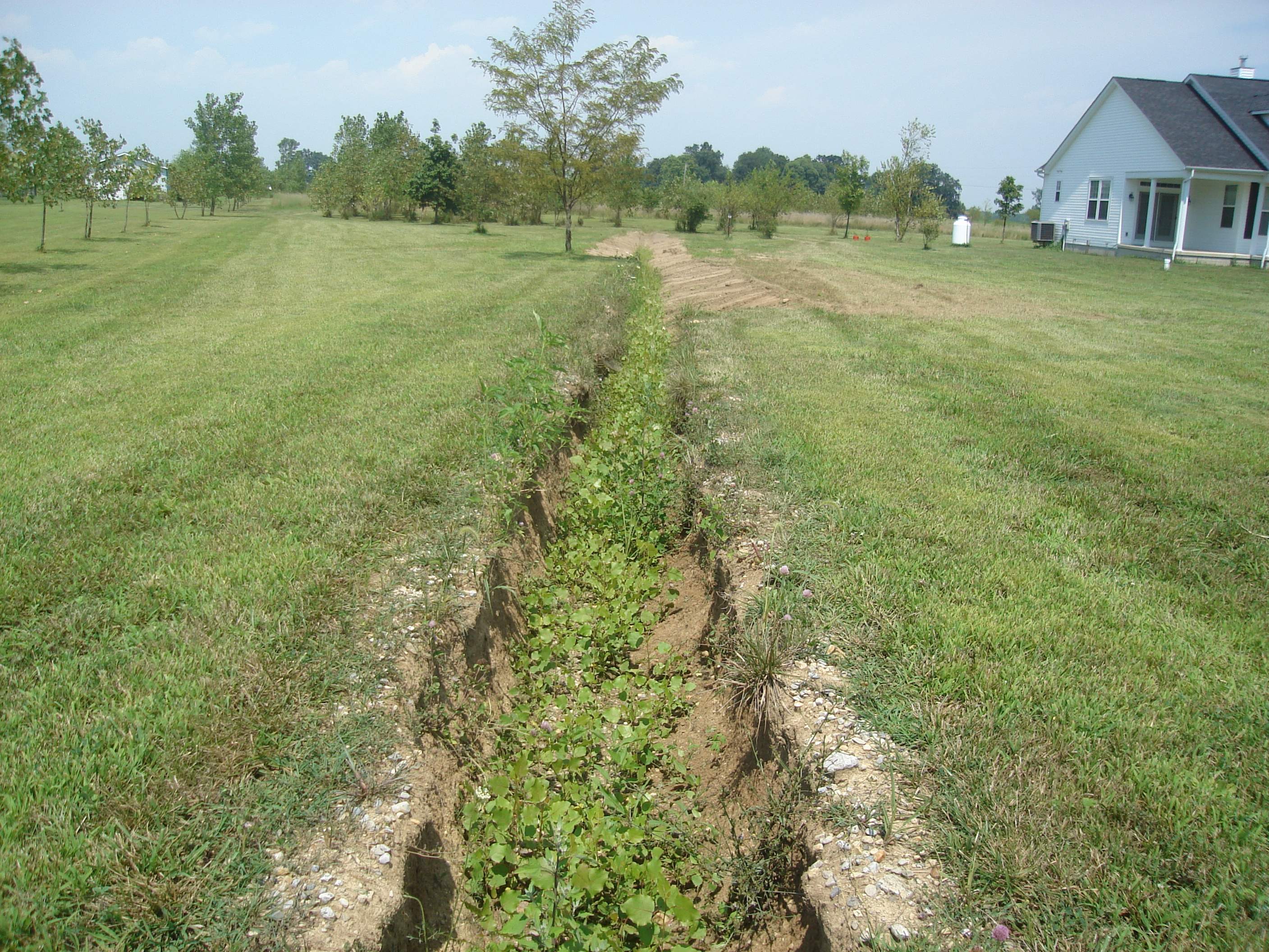

This whole thing is to drain heavy storm water flow which comes in from near by farm land (maybe some broken field tiles). It's not just a soppy area it's large amounts of water say 100' by 75' by 4" deep. I would like to get the water to run off as fast as it comes in it comes close to the house.
I made a swale then realized that I could put some 12" tile in about half of it because half of it is deep enough (make it easier to mow). The land grade goes up in the direction which I have to drain the water but then drops off into a ditch thats why only half of it is deep enough for tile.
Thanks for the reply. I'll look at making a cupping configuration under the tile before putting it in.
