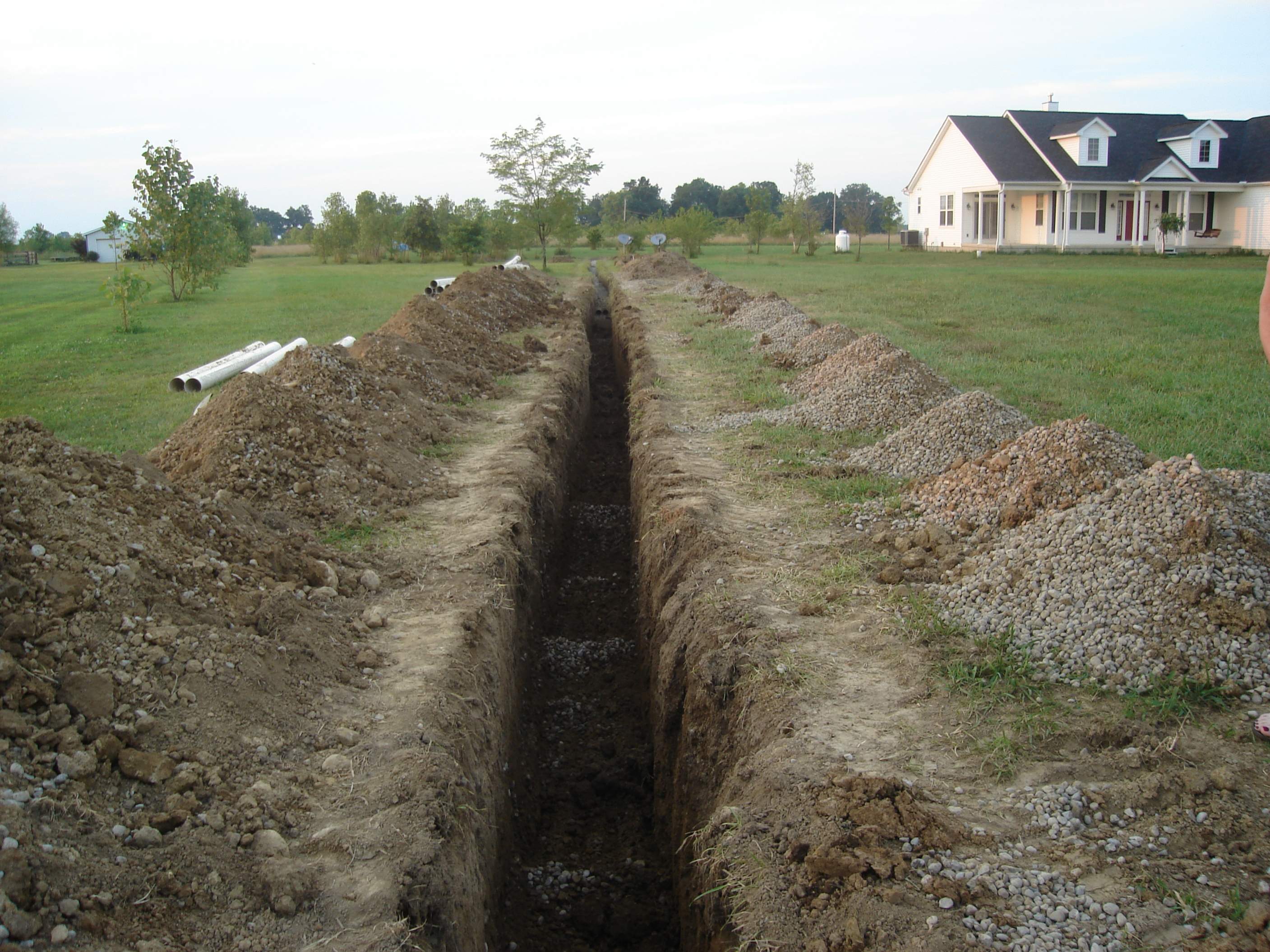

Here are some pics in various stages (I hope the pics post).
old pics I will get some new ones.

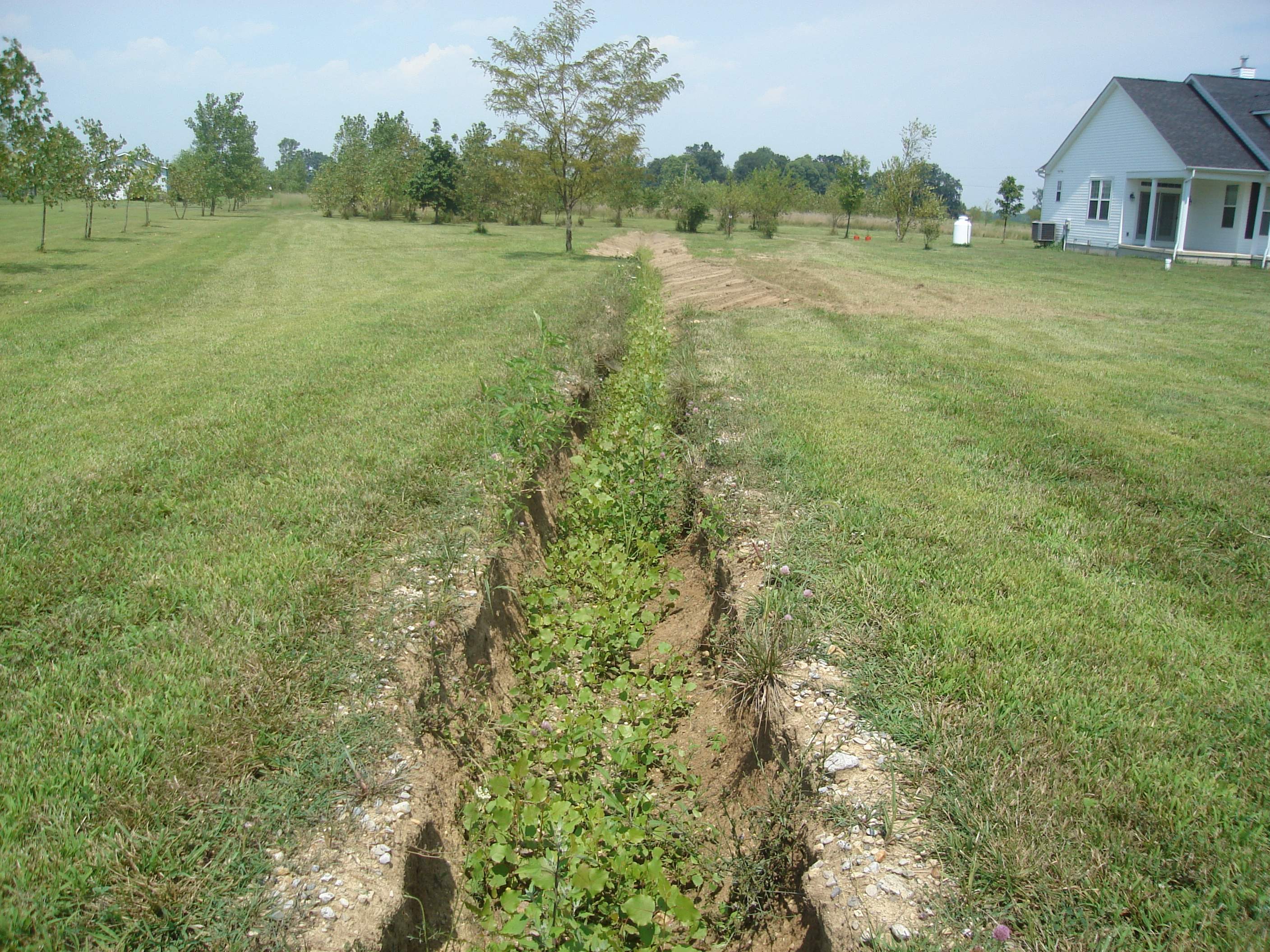

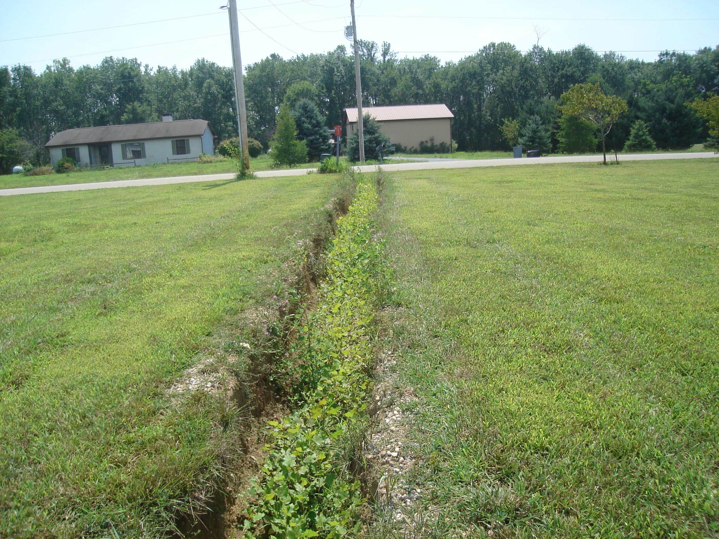

New pics.

thanks for the pictures
