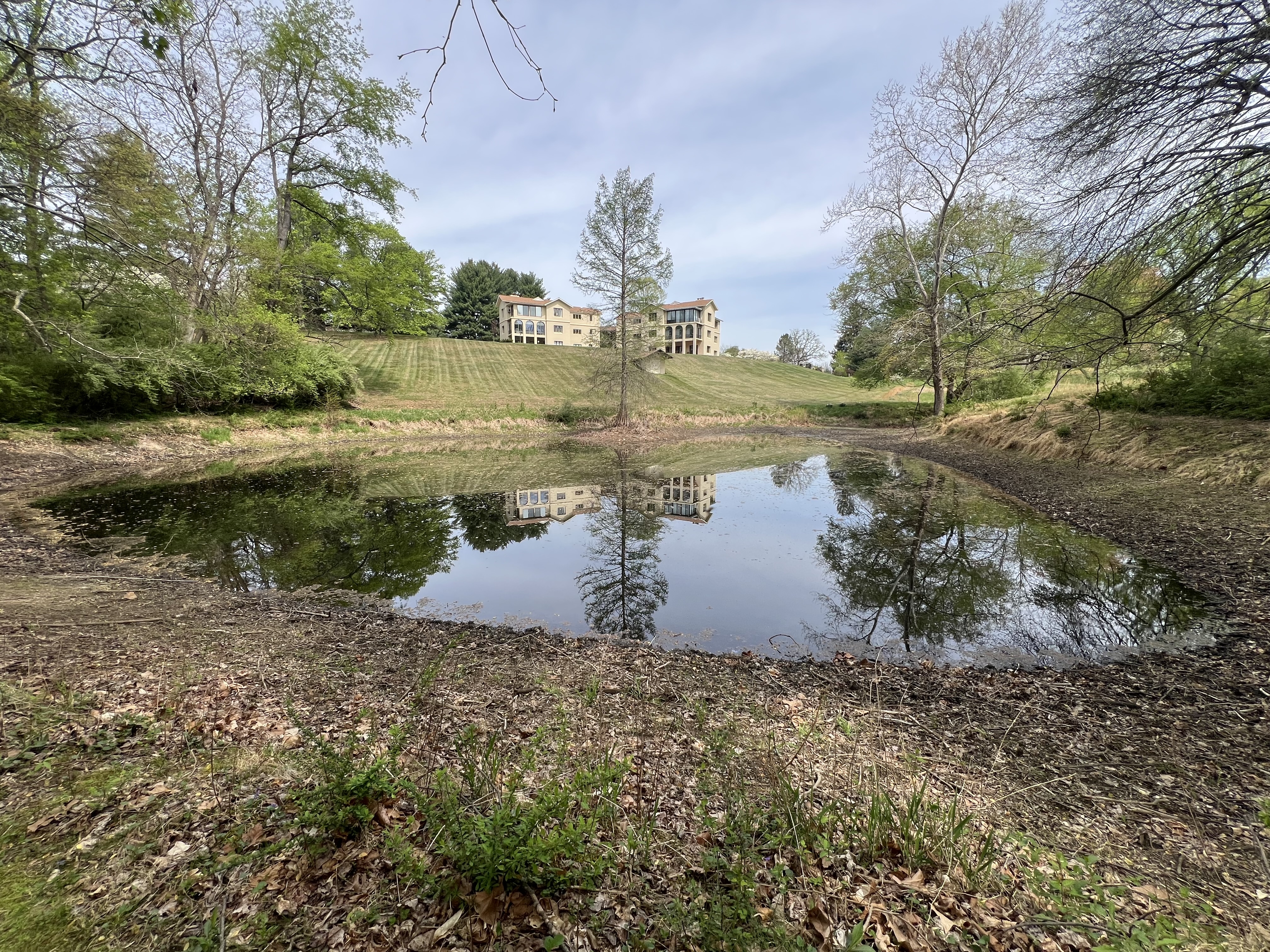

Have a long time customer. It's a large acreage HOA with several fields to be hayed and large grass areas to be mowed.
They also have 3 small ponds.
1 pond is spring fed. The spring has unexpectedly dried up. I dont know a lot about the life cycle of springs, so I don't know if they can also come back to life, but it's been on the decline for about a year.
The pond is down to 10-20% (best guess). Water is evaporating, so diminishing with each passing day. There is no other natural water source to replace it nearby. The property owners would like to keep the pond, but are not of unlimited wealth.
Here is the only 2 ways I can think of to replenish the pond:
1. Drill a well. But how much the well gives in GPH is anyone's guess. Very rough estimated cost is about $10,000.
2. The current building the owners live in is uphill from the pond, about 300-500' away in a PUD building of 6 condominium units. Only a small part of the building currently has gutters and downspouts. I was contemplating installing hundreds of feet of 5" gutter, with 3x4 down spouts on the building and running all the down spouts into a continuous rain water retention system. Rather than running the underground pipe into a typical large stone pit, instead run the water directly into the pond.
Realize there's no guarantee it'll rain enough to keep the pond full, but other than that, that's the only reasonable sources of water I can come up with. The roofs areas are pretty large. I suppose there's a roof water runoff calculator that can help calculate.
Another noteworthy point is the other ponds, about 1/4 mile away each, are also spring fed, but not low on water. So that tells me it's probably not a drought issue?
This is all in the "talking/ideas" phase. I have installed several rainwater retention systems, so this is nothing new for me from an installation perspective.
I just don't know if it's enough water?
Pond is triangular about 150' on each leg and averages about 4-5' deep.
Don't want to install something that won't work or lessen my reputation with customer. Another thing definitely worth mentioning is the customer also has some desire to have gutters and downspouts installed to get roof runoff away from the building, so there could be a 2-fer type of benefit in helping to keep water from damaging building foundations

Could you offer to install the gutters, and route the runoff into the pond, with full disclosure to the owners that it may not refill the pond? They want gutters anyway.
If it doesn't refill the pond, they you can discuss adding a well later.
I would suggest you do a little more research on the gutter option. Calculate the area of the roof, and your average yearly rainfall, and the area of the pond to get an estimate of how much water you could expect to get into the pond from the gutters.

I did a walk around assessment and don't see any damp areas at the "breast" of the pond. No signs of leakage, but definitely a dried-up supply.
Additionally, the pond has been there for about 50 years (mid 70's man made pond)

Tempted to suggest looking at historic google map images to see if there was development nearby that changed the path of the spring.
Not my field of expertise, but if a spring source stops flowing into a pond, can it then act as a drain?

In a perfect world you have a runoff area to a pond of at least 10 to 1. In other words if you have a 1 acre pond you have 10 acres of runoff. In your picture at least some ground runs into the pond but I can’t tell how much. The good part of diverting water runoff from the buildings is about 95% of that will be runoff. Some ground will only runoff 15%.

The spring that feeds the pond is about 300’ away from the pond. From where the spring originates, it runs downhill into the pond, so the spring is not in the confines of the pond, it is detached from the pond. Water used to flow pretty freely to the pond. now its down to barely a trickle.

Looks like a springhouse between the buildings at the top of the hill and the pond below. I think the first task would be to see if sediment is blocking the spring outlet.

I'd "poke around" with your new excavator at the spring and inspect the 300' waterway to the pond.
A fallen stick or accumulated weeds or leaves will easily divert slow moving water.

Seems like there's no downside to the gutter and underground drain system. I'm a little amazed that water and foundation problems haven't cropped up in all this time with these buildings having no overhead gutters. But I will admit brick/stone ground gutters with decent fall worked on a lot of old houses...
One reason they may not have had issues is that the builder may have put in a robust French drain system around the foundation. That may also be something you need to identify before digging to install your underground drain/runoff system for your gutter plan to keep from hitting it when you trench.
But assuming a price point for the owners and yourself is comfortable, those buildings really need gutters. It really wouldn't take too much trenching to get underground corrugated pipe to that pond either. Bottom line...couldn't hurt.
As for the spring, since you can identify the original source on open ground, a couple of hours with a backhoe or excavator should tell you if the flow is worth re-establishing to the pond. If that doesn't work, fill it in, spread some grass seed and straw and walk away...if you find a good flow, discuss with owners as to costs to impound and pipe to pond and go from there.
Here's a quick spring development overview from the USDA NRCS folks: https://www.nrcs.usda.gov/sites/default/files/2022-10/Spring_Development_574_Overview_9_2020.pdf
