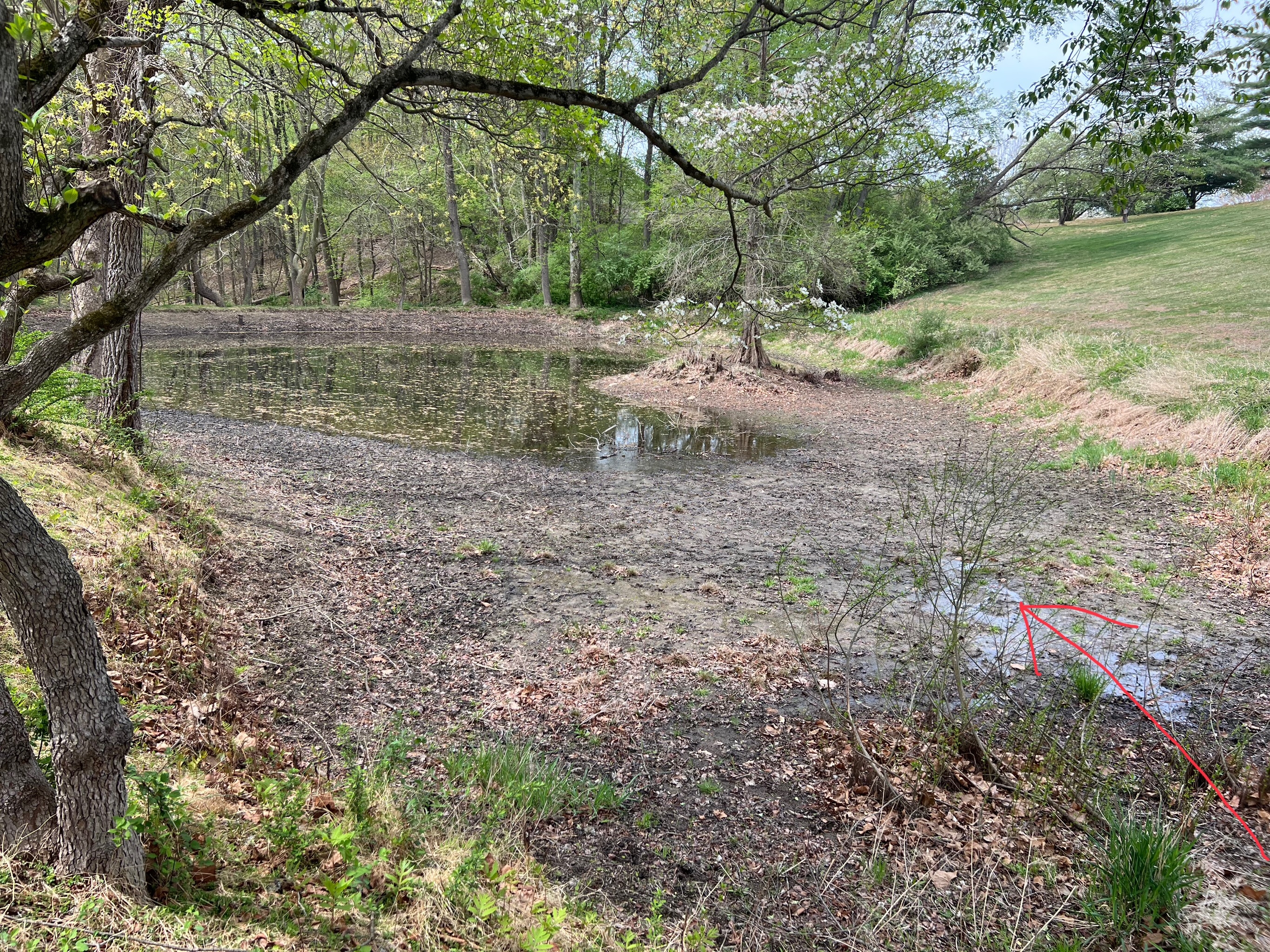

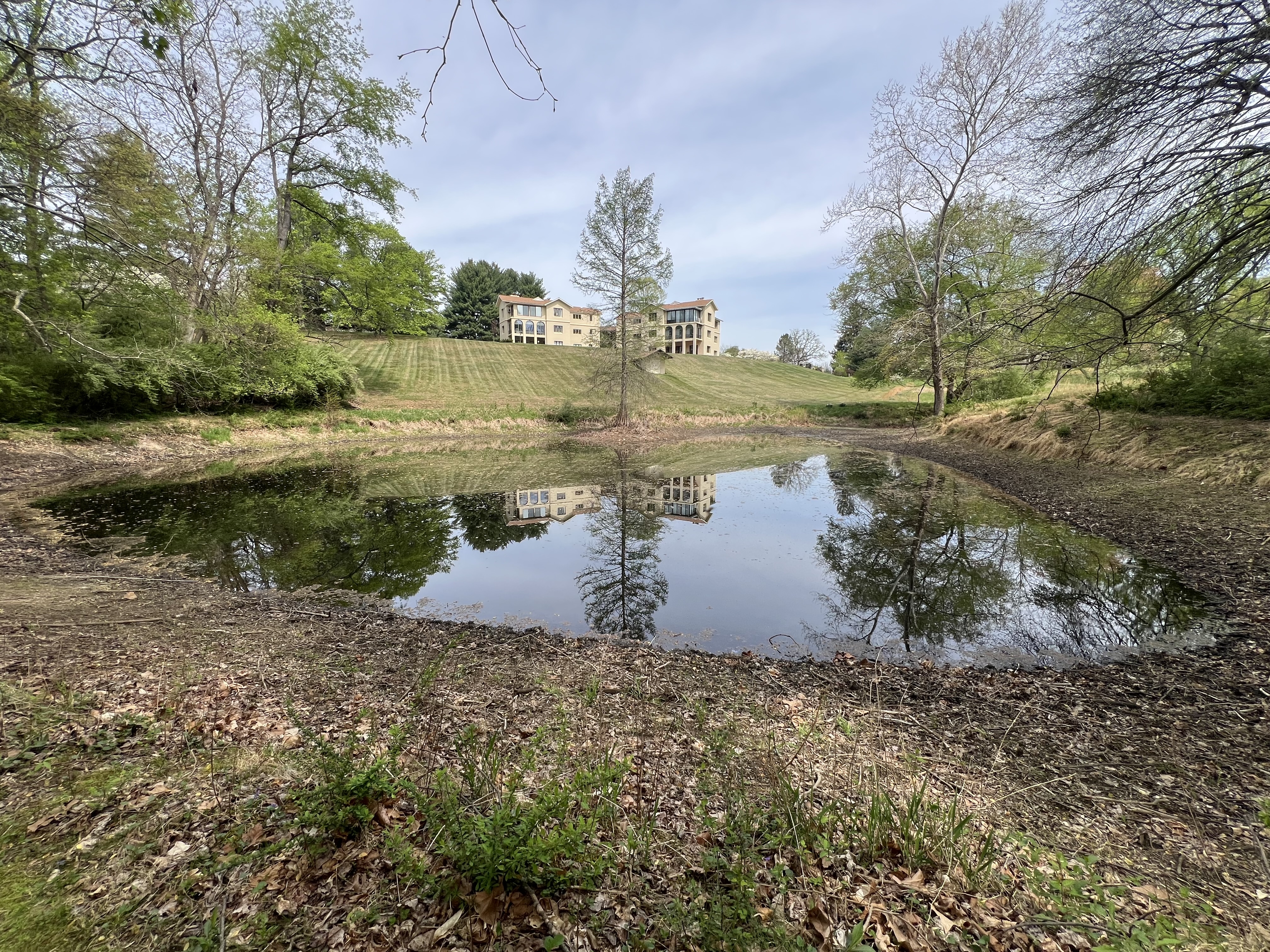

Have a long time customer. It's a large acreage HOA with several fields to be hayed and large grass areas to be mowed.
They also have 3 small ponds.
1 pond is spring fed. The spring has unexpectedly dried up. I dont know a lot about the life cycle of springs, so I don't know if they can also come back to life, but it's been on the decline for about a year.
The pond is down to 10-20% (best guess). Water is evaporating, so diminishing with each passing day. There is no other natural water source to replace it nearby. The property owners would like to keep the pond, but are not of unlimited wealth.
Here is the only 2 ways I can think of to replenish the pond:
1. Drill a well. But how much the well gives in GPH is anyone's guess. Very rough estimated cost is about $10,000.
2. The current building the owners live in is uphill from the pond, about 300-500' away in a PUD building of 6 condominium units. Only a small part of the building currently has gutters and downspouts. I was contemplating installing hundreds of feet of 5" gutter, with 3x4 down spouts on the building and running all the down spouts into a continuous rain water retention system. Rather than running the underground pipe into a typical large stone pit, instead run the water directly into the pond.
Realize there's no guarantee it'll rain enough to keep the pond full, but other than that, that's the only reasonable sources of water I can come up with. The roofs areas are pretty large. I suppose there's a roof water runoff calculator that can help calculate.
Another noteworthy point is the other ponds, about 1/4 mile away each, are also spring fed, but not low on water. So that tells me it's probably not a drought issue?
This is all in the "talking/ideas" phase. I have installed several rainwater retention systems, so this is nothing new for me from an installation perspective.
I just don't know if it's enough water?
Pond is triangular about 150' on each leg and averages about 4-5' deep.

Something to consider is how the spring feeds the pond. At my place, the spring is actually uphill of my pond about 30 feet vertically, but 50 yards away. The spring was tapped by cutting a trench into the spring seep, dropping in some small perf pipe and back filling with gravel. Then a collector pipe was run underground to a water trough about 1/2 way between the pond and spring. The outfall from the spring empties into the water trough providing year-round water to my horses. Just below the top of the trough is an outlet tap that then directs the excess water to the pond. I have had a couple of issues over time with the outlet at the pond getting clogged with sediment. I just use a source of compressed air to blow out the pipe between the trough and pond to restore flow.
I can see the flow coming from the spring. It varies with the season and how much rain/snow I get here in the Pacific Northwest. If the outfall line is clogged, the trough overflows because it can't drain the excess water. That tells me I need to clean out the line. It's worked for about 50 years.

If the square footage of roof foot print is equal to the square footage of the pond, then assuming it had vertical sides like a pool, in theory you could potentially add 43” (PA’s annual rainfall) to its height—over 1 year’s time. Those banks look pretty shallow, so I expect the actual water height increase would be much less.
Does the spring originate in the pond or above the pond? If in the pond you may be limited by hydraulic pressure and won’t see any improvement. Likewise, if there is a leak/drain somewhere.
You’ll have to play with the math based on roof area and slope of the pond.
From the house foundation point of view, 100 sq’ of roof foot print will collect 62.3 gallons of water per inch of rain—when it’s not coming down so fast it runs over the gutters. You need to move that somewhere else anyway.
It originates about 300’ above the pond.

After further thought, I think you have a bigger problem than spring drying up. In southern Ohio we have had a wet spring and ponds are full. This site appears to be leaking water, since the pond is very low. Tree root can create channels to drain pond. If pond is leaking the additional water will not be permanent fix

Well, if the spring dried up late last summer and the water level began falling shortly thereafter, one would think theres a correlation.
We do have to look at everything though.

We have a pond that never overflows but does drop own a couple of feet in summer. I wanted to get more water in it so I graded a shallow ditch across the hillside above it to collect water coming down the hill and direct it to the pond. It helped some in winter (heavy rains) but still not much in summer. Assuming it is springfed, I have to wonder if addng more water causes the spring to drain the extra water out?

Spoke with one of the owners and they seem to be leaning towards cleaning out the stream from the spring and the pond. This will entail a good amount of brush cutting and maybe some ditching with the excavator. (y)
Then we will see what the status of the spring is.
I bet that the stream, which is just a trickle, is obstructed to the point of water just not making it to the pond anymore.
