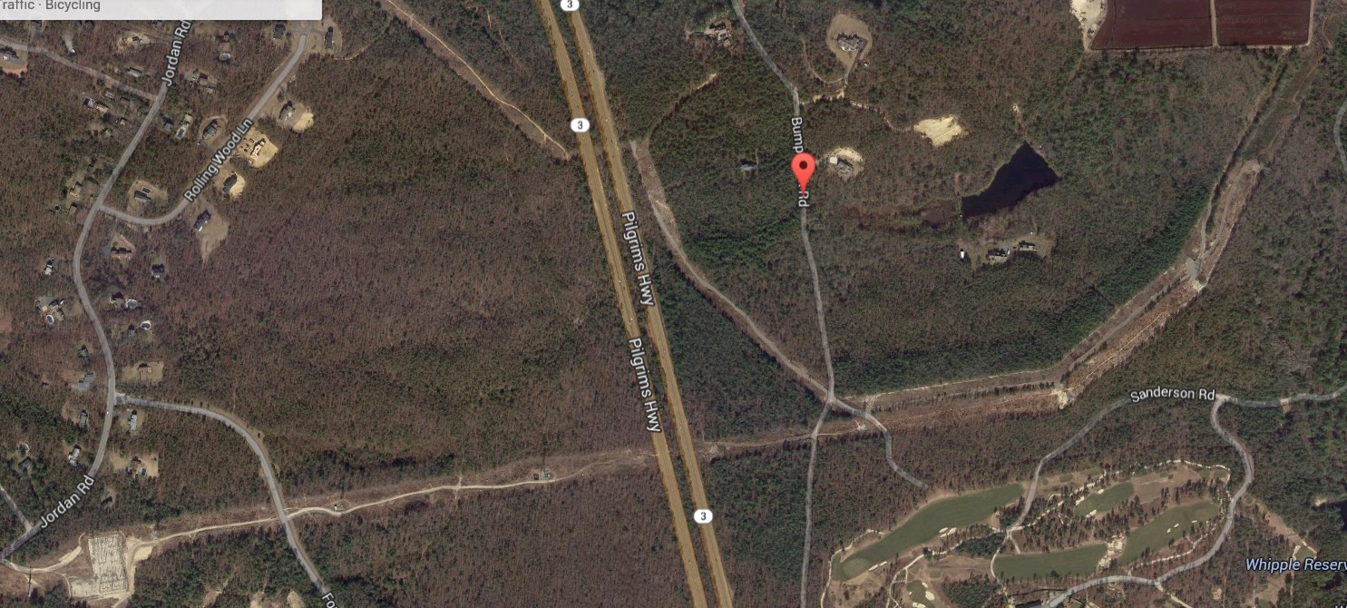

My bet is that you are close to transmission line or power generator or large substation that has bad ground leakage.
I believe that this is the problem. His house is about 1500 feet away from some high power transmission lines to the south and about 1/2 mile away from a big substation to the west-southwest. I would get the power company and the state involved to get this resolved as this is a major safety concern.
   / Free electricity ! #68
I looked it up on Google Earth. Follow the power line to the east. If I am not mistaken there is a power generator by the ocean. Then connect the substation on the west and the generator on the east by a line. Your neighbor's house is almost exactly on the line and yours is not too far south. The utility can put a clamp meter on the grounding wire(s) on the transformer at the power station and see what current is going through there. They can do the same at the substation.
You can also put a swimming pool in the ground so its long axis coincides with current flow. Make sure that it has good galvanic contact with surrounding soil (in example by stainless steel plates connected to extensive network of grounding rods put on each end). The current will keep it somewhat warmer extending your swimming season. You might need to wear special insulation suit so you don't get electrocuted while swimming.
