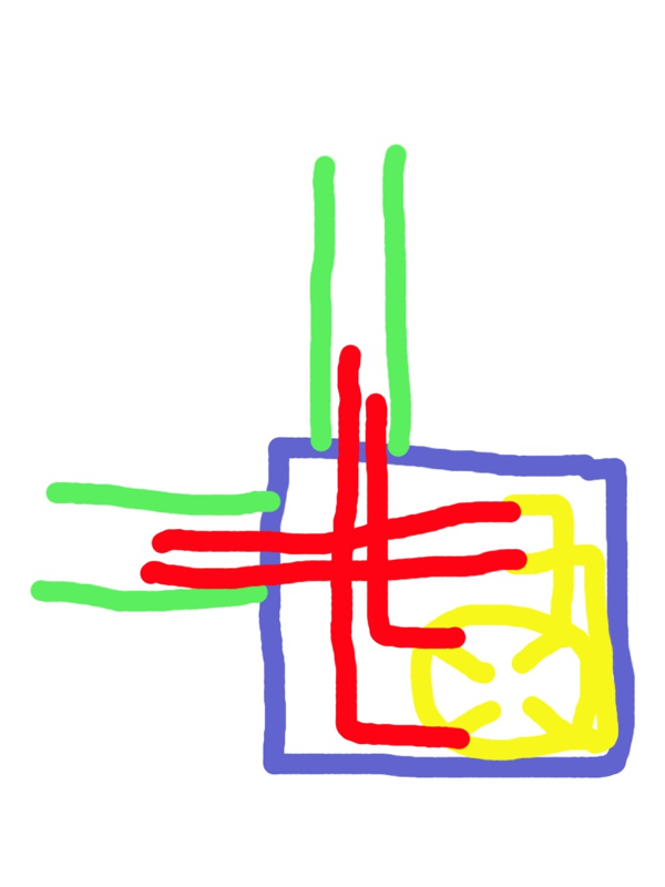

I am putting a new electrical entrance in a barn I had built last summer and had the inspection on it this afternoon. This is not the first time I've done electrical work or the first entrance I've put in so I wasn't really worried about it, first mistake. I have the conduit coming into the bottom left side of the meter box and also have conduit exiting through the left side but on the side not the bottom. The inspector tells me that this will be unacceptable to the power company because they do not like the line & load wires to cross inside the meter box. Now I'm stuck because there are holes in the metal siding where the conduit goes onto the panel inside and where the meter box is screwed in. I'm going to call the power company tomorrow and see if I can talk them into allowing it as is, but the way this company is I'm not holding my breath. The worst part is the inspector told me there is absolutely nothing wrong with it the way it is but they just don't like it that way. Just a little frustrated right now and venting.

i do not see why the line and load wires must cross inside the box, although I have never wired a meter box. Can't the line leads enter the box, turn right, go up, turn left, then down to the meter receptacle? Then the load wires exit down, turn left (but still above the incoming line leads), and exit out the left side?

This is a quick sketch I made up of how the wires come into the meter box. It looks like a crayon drawing but the best i could do quickly on my iPad.

The picture needs rotated 90* counter clockwise to make sense.
The blue is the box, green would be conduit, red is the wiring, and yellow is the meter lugs where the wire connects.

In my opinion, so don't take this to the bank, it is just an opinion.. but I think it is a bad idea to cross the wires.. a lightning strike could easily perforate the insulation of the crossed wires, and cause a connection between the wires. You could then pull the meter thinking you had de-energized the service to the house and it would not be the case. I would re-do it. I wonder if some of the actual electricians like Grsthegreat or Mace Canute would care to weigh in with their opinions.

Did you alter the divider that separates the utility wires from the load wires ???

Definitely check with power company and have them look it over. You aren't the first person for sure who ever had a situation where something was less than ideal for wiring up the meter. I agree service wires preferably are not crossed but if that is the only option that is available it can be done. Like others said a UL listed divider can be put between the service wires. Did you already wire up the load end of the meter? If there are just tails in it now and the utility company can route them as they wish there shouldn't be too much of an issue I wouldn't think.

They make a hole plug with gaskets for electrical boxes. Just put one in the unneeded hole and relocate it.

Can you move the conduit coming up to the left a foot or so? Or, put a couple 45's in to have it come up over there? I was thinking you might be able to unscrew the box and remount it to the left a bit - if the conduit could come up over there. Wires could straight up to their terminals. Then exit the box on the lower right of the box to the building, instead of out the lower left.
You'd still have the small screw holes from the old mounting location, but they'd be pretty small to caulk. And you'd be re-using the large hole through the wall.

In your case - instead of moving the box, creating new holes in building or flipping the box upside down, can't you take box off the building and put it on the bench. Flip the components right and left inside so the wires will not be crossed. I am not sure how much work you will have to do to flip the cover though due to the meter hole is on right and the hinges orientation on it. You might have to have a new cover made by a local metal shop.
