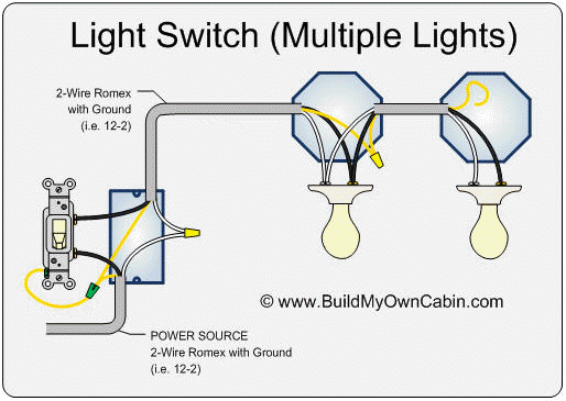

When wiring a light and switch I have always run the hot to the switch and then to the light fixture. On a current project of lighting a storage area, I could use a lot less wire if I brought the hot thru the lights first. I want to have four light fixtures off one switch...nothing fancy.
Will this work if I cut and attach the white at each light, and let the black run continuous to the switch? Then both white and black attach to the switch?
Seems simple enough but I googled the concept and the first find hooked a hot black to the light, and the white from the switch to the side of the light. Then the other black and white were wired together. And the white was marked black, and attached to the switch on bottom, where I would have assumed black would be connected.
Help!

Inserting the light into either the white or black wire only sounds like you get a series circuit. You want the lights in parallel--light across black and white.

I think this is what you are trying to do.
But I think it's easier to just run wires parallel like dave1949 states

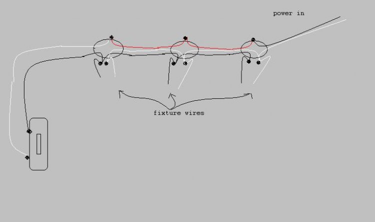

Found the following while researching the best method. I think I will just stick with power to switch and then to multiple lights. I know how to do that. The instructions below sound way to complicated, and why is 14/3 needed?
here is how it goes;
from power source 14/2 to ceiling box...... 14/3 to next box........14/3 to next box .........14/3to next box..........14/2 to single-pole switch and box.
black from power source wire nutted to black in all ceiling boxes and the 14/2 black to the switch.
white from power source wire nutted to white from light and to 14/3 white to next light then nutted to next light white and 14/3 to next light etc. This white stops at the last light white wire.
black light wire in first box is nutted to 14/3 red wire.. second light black wire nutted to the 2 red.....3rd light black nutted to red and the white from the 14/2 to the switch. this white wire should have black electrical tape on both ends to show it is being used as a black (hot) wire.
in switch box the black and the remarked white goes to the single pole switch screws.

I think your written description is the same thing as slvda00's sketch.
It is really worth it for safety's sake to switch the hot before the lights, it's probably code anyways. When the switch is off, there is no power at any light.
The third wire is passing the hot from the power source to the switch, just passing through each light box with no connection to a light fixture.

The wiring in the picture is correct for that situation. But I usually would use the red between lights (less confusing for the novice). But even less confusing would be to put the power into the left light and run to the right two switches. This would also eliminate the need for 3 wire cable.
in the wiring with 2 wire in all boxes, the white (marking it with a wrap of black tape) would be used to carry the power to the switch and the black would be used for the switch to light conductor.
