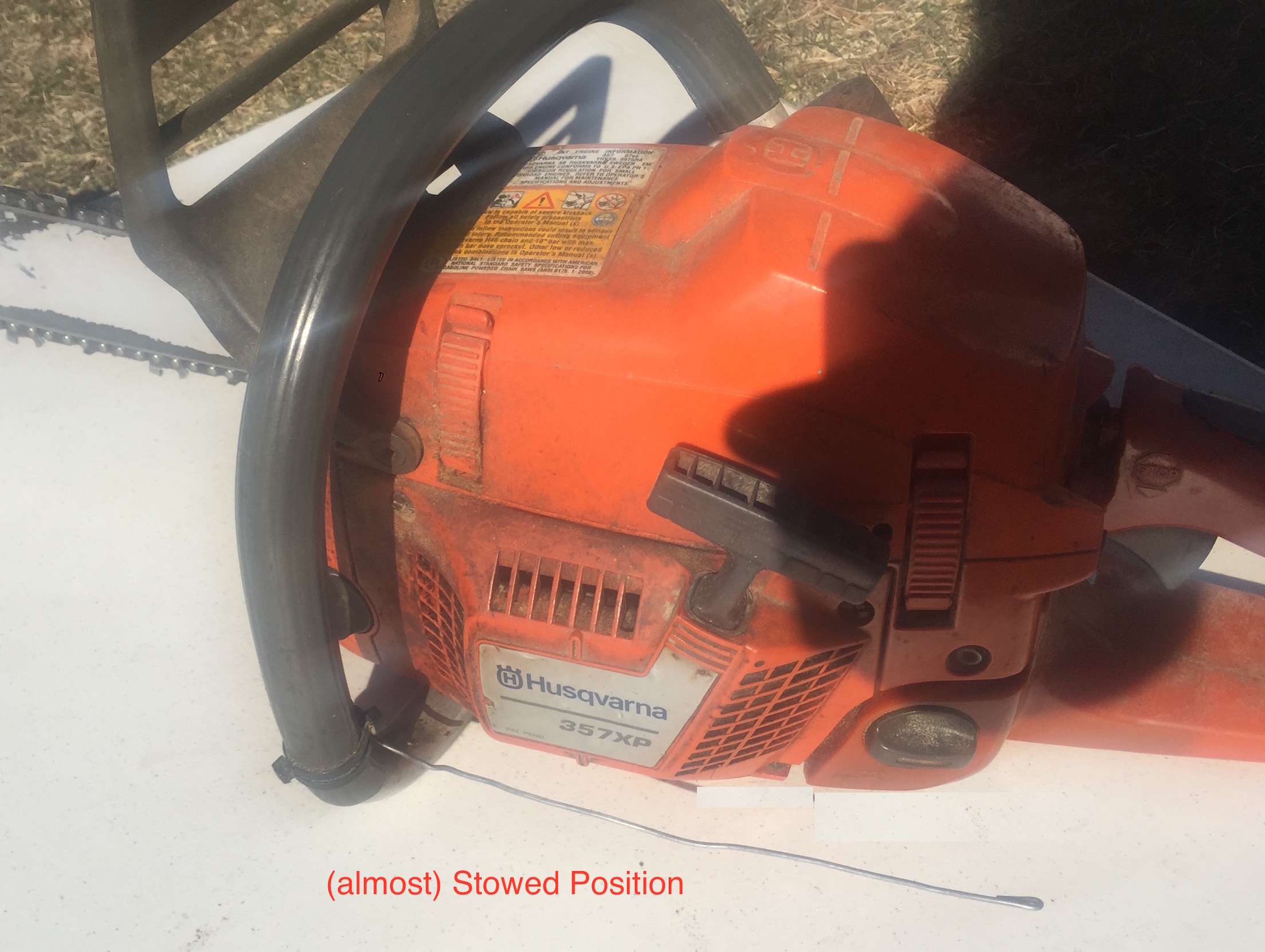

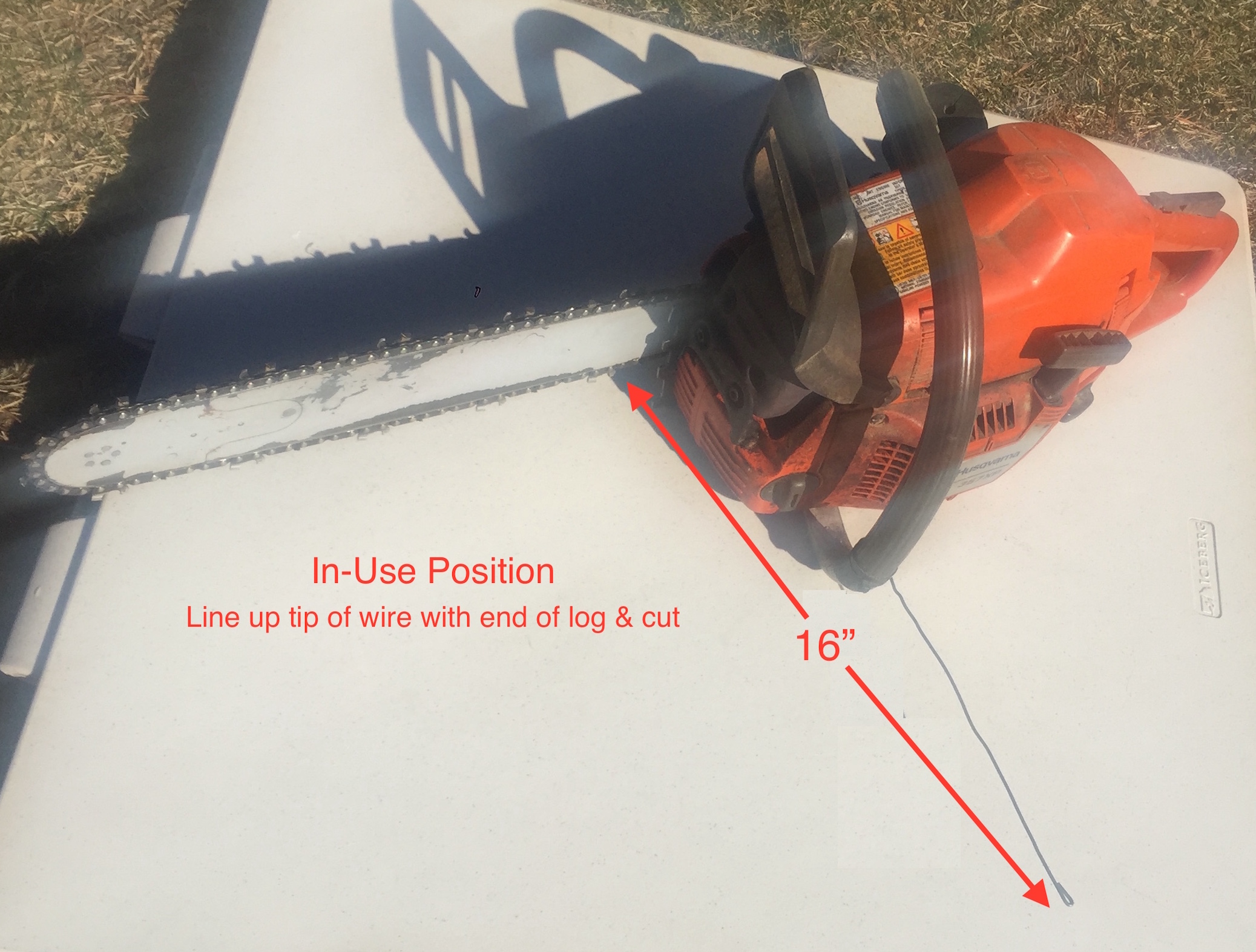

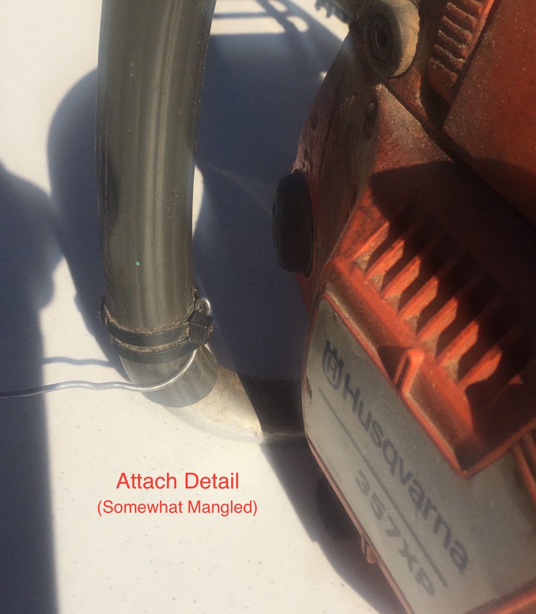

I received magnetic 16" firewood gauge as a gift. I've found it useful in some situations. I typicaly only use it if I'm cutting up a load of logs in the landing. If I brought it into the woods with me, I'd loose it (or anything else not permanently attached) in a few minutes.
Prior to that, I had a bent up piece of wire zip-tied to the left side of my front handle of one of my saws. It flipped back against the body of my saw when not in use. Nothing to carry, nothing to lose when not in use. Eventually, the zip-ties holding it to the handle deteriorated and I pulled it off. I've not yet replaced it. It was modeled after a commercially available gauge that the former director of the Forestry and Natural Resources program at a local technical school showed me.
I've also been known to grab a stick of the right length in my left hand along with the front handle of the saw so the end of the stick marks 16" from the bar. The old "turning my saw sideways so the 16" bar indicates the log length" is a pain in the neck, so I don't do much of that.
Has anyone gotten the idea that despite many cords of firewood cutting, I still stink at judging 16" lengths? What typically throws me is when cutting different diameter logs. If I'm cutting 16" lengths on a 6" diameter log, it tend to cut longer when I move to a 12" diameter log. I've played around with various methods over the years. Most of the time, I just accept that I'm not going to hit the exact length I'm aiming for. Fortunately, my stove can accommodate longer when I mess up on the long side, and shorter logs still burn and give off BTUs, so they go in the stove as well.

I gave that magnet think a look then go nah, I like the the Cut-right thing better, on and off like a air chuck and fits in your belt or anywhere when not in use. Now that wire thingy off the handle bar, that ain't a bad idea I might give that a try, then I can measure both directions when cutting.
I dont do that saw twist thing either it's a pain in the neck, hand, donkey............ I also stick at guessing firewood length, a couple years ago I noticed I was really getting bad at that, some of my wood started @16-18 but slowly ended up at 2', maybe like you say that diameter thing is throwing me off, the older I get more off then usual............
