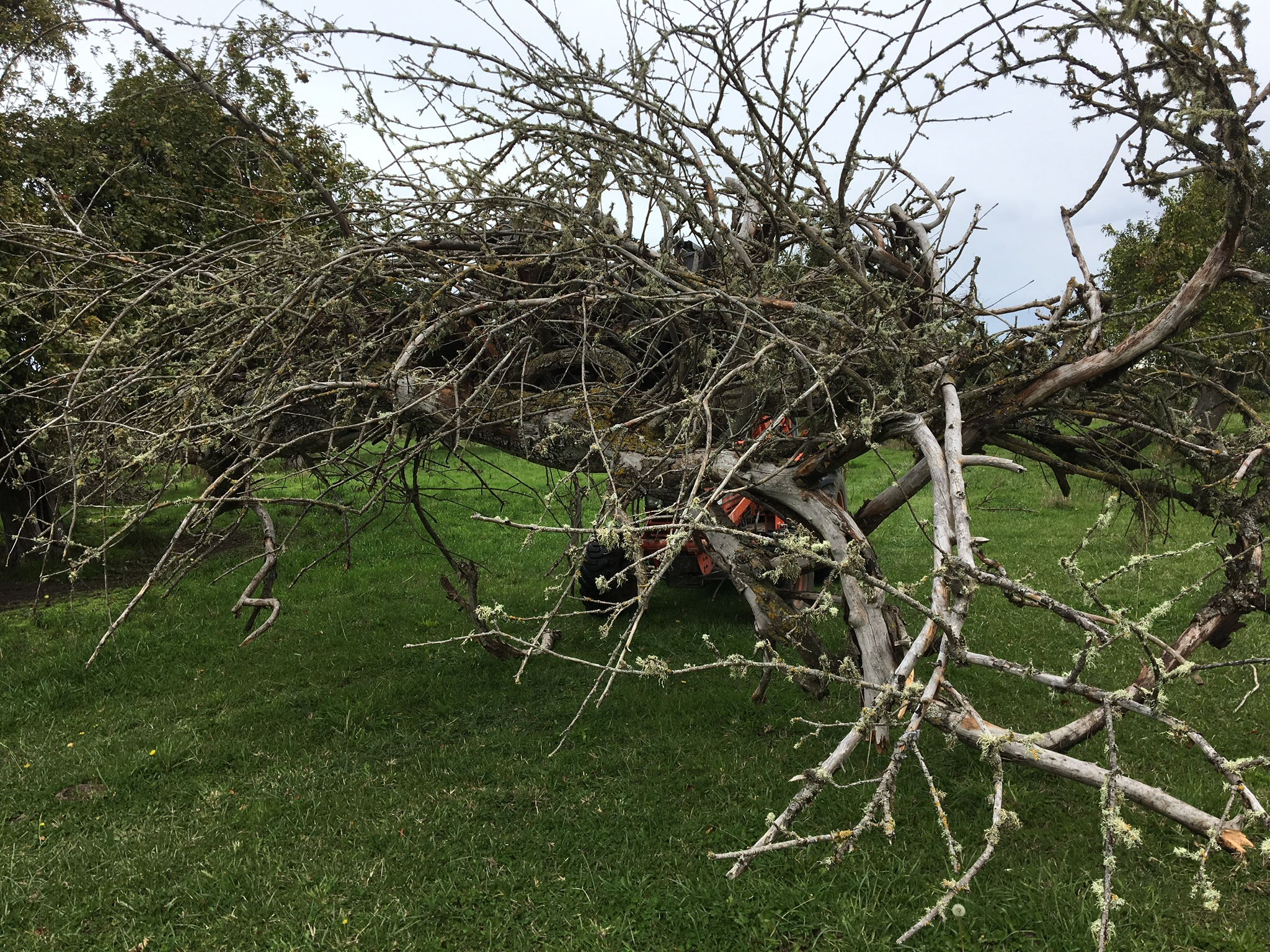

I am not familiar with Blue Max. Dreamland continued today, I fired up my Stihl MS261 in 2 pulls after not using since last weekend. It is not even an Mtronic, it is carbed. If it makes anyone feel better I ran it out of fuel and it took 3 pulls after refueling and oiling.
I was cleaning up some more old apple trees, off to the burn pile. I was able to salvage about a 1/3 cord of apple firewood today, most of these trees were termite laden.
