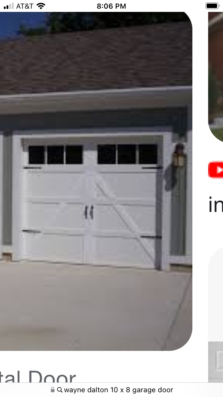

Wife picked out the sectional door for the barn. Of course we know who will be doing the install!
Be careful when handling installing the top panel with those glass windows. Don’t ask me how I know they are expensive and hard to get.

I don't like the windows in the top section, I want them at a level that I can see out when I'm in the garage.
If mine did not have what they call the Star Burst Design they would probably be as you say. Nothing like having to drag a step ladder over to be able to look out.

Kind sir……doorman is in my username.
I train people to hang garage doors!
The top is unusually heavy though
1/2” insulated glass is heavy.
Wife and I had that chat……I was all for a full view (gas station style) door with insulated glass. White powder coated frame. I got shot down. We don’t live on-site full time and too much glass can be bad.

Us amateurs first timers didn’t have training. We learned the hard way.
The school of hard knock is also a expensive way to learn.
My windows are high, using the same header height as the 10ft garage door header. Didn't want outsiders seeing into my workshop. But still get natural light into the shop. Jon
