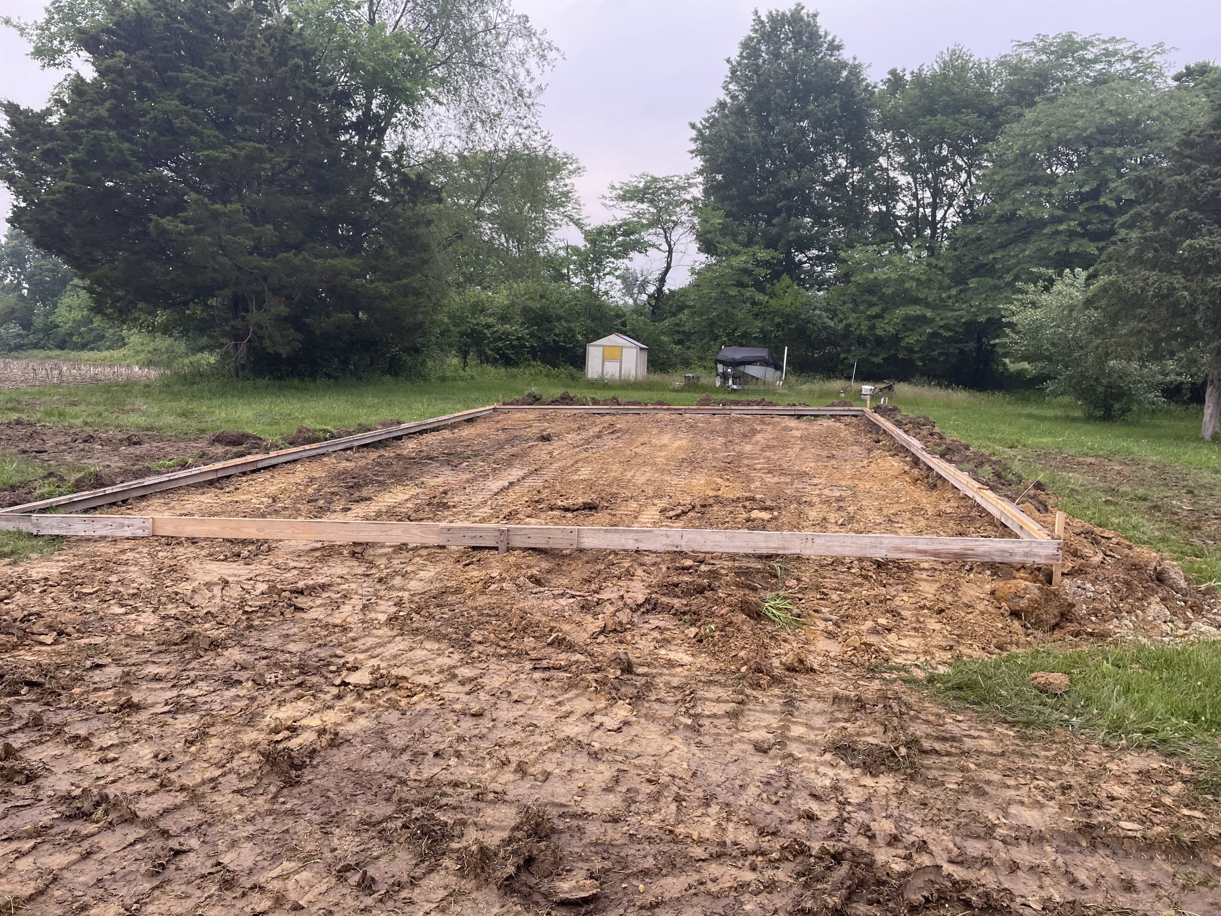

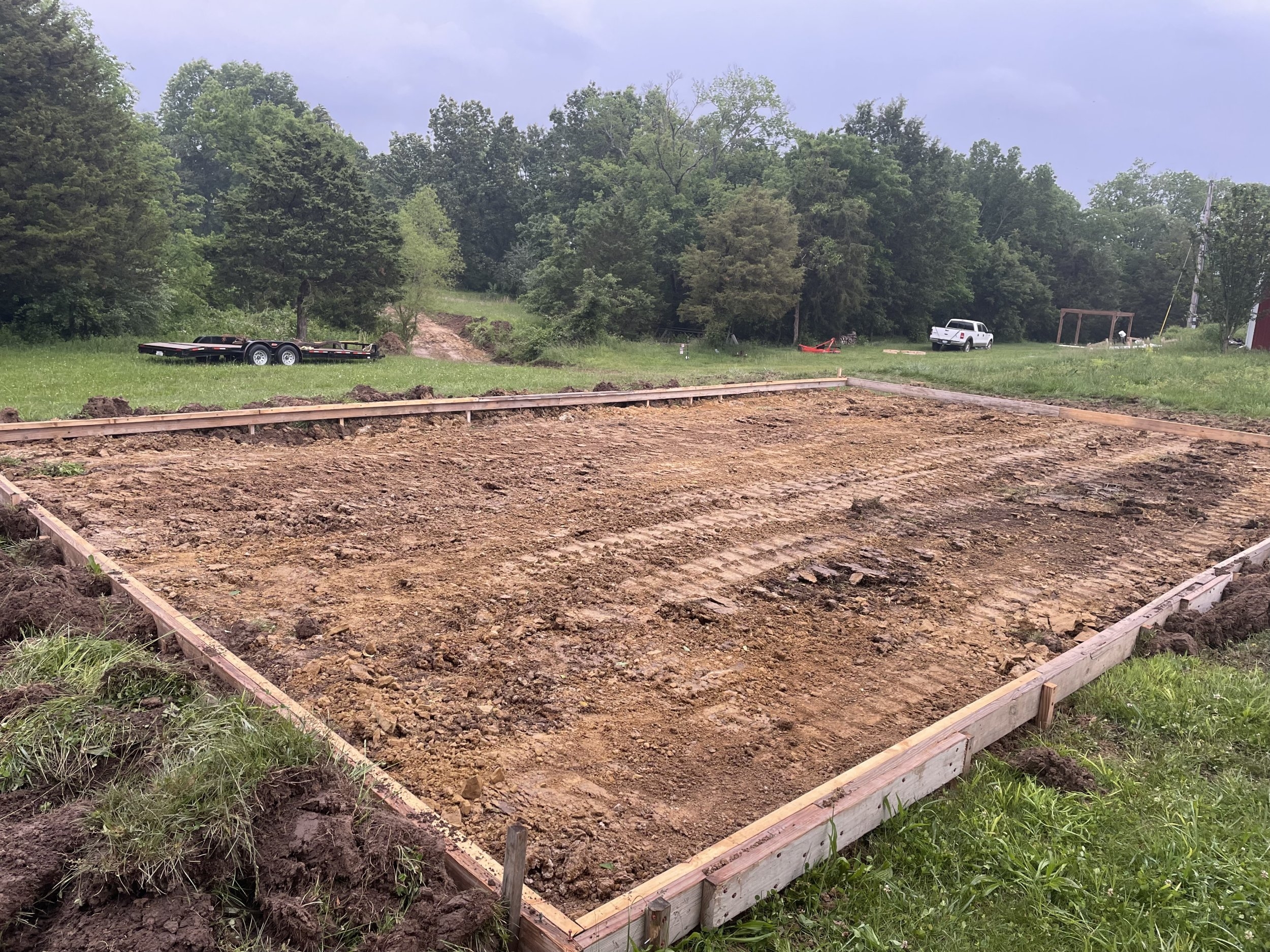

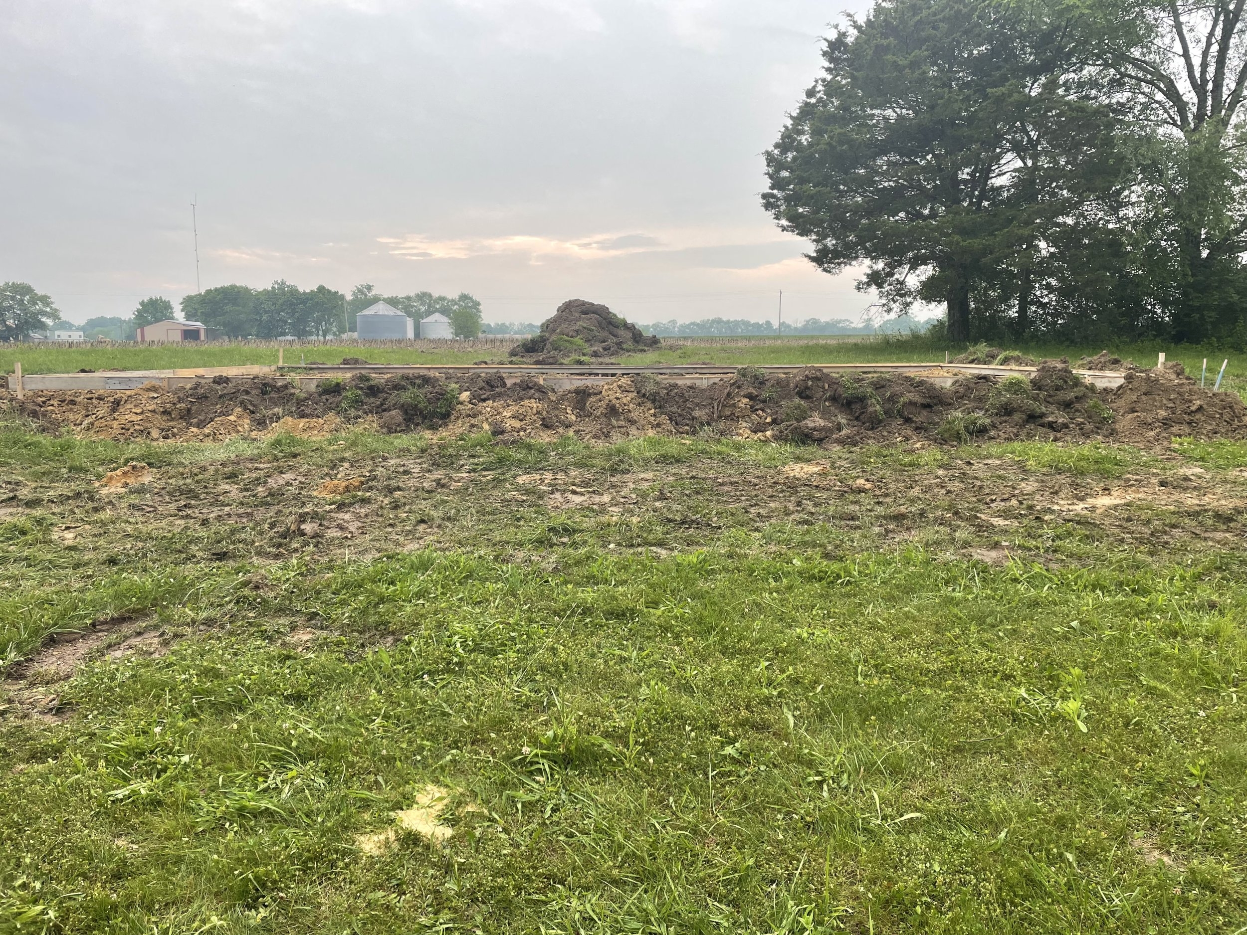

Forms finally set by the builder!!!
Doing our under slab DWV and electric tomorrow.
He will fill with stone and hopefully pour concrete week after the holiday.

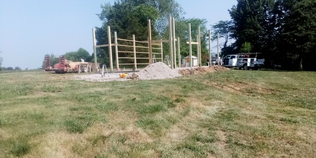

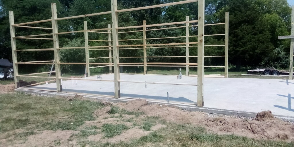

Might finish decking the bridge and load test Sunday morning……

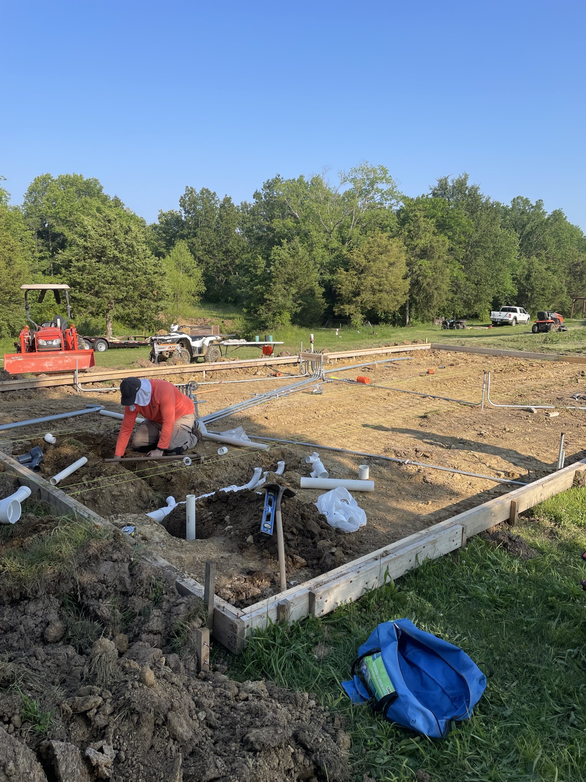

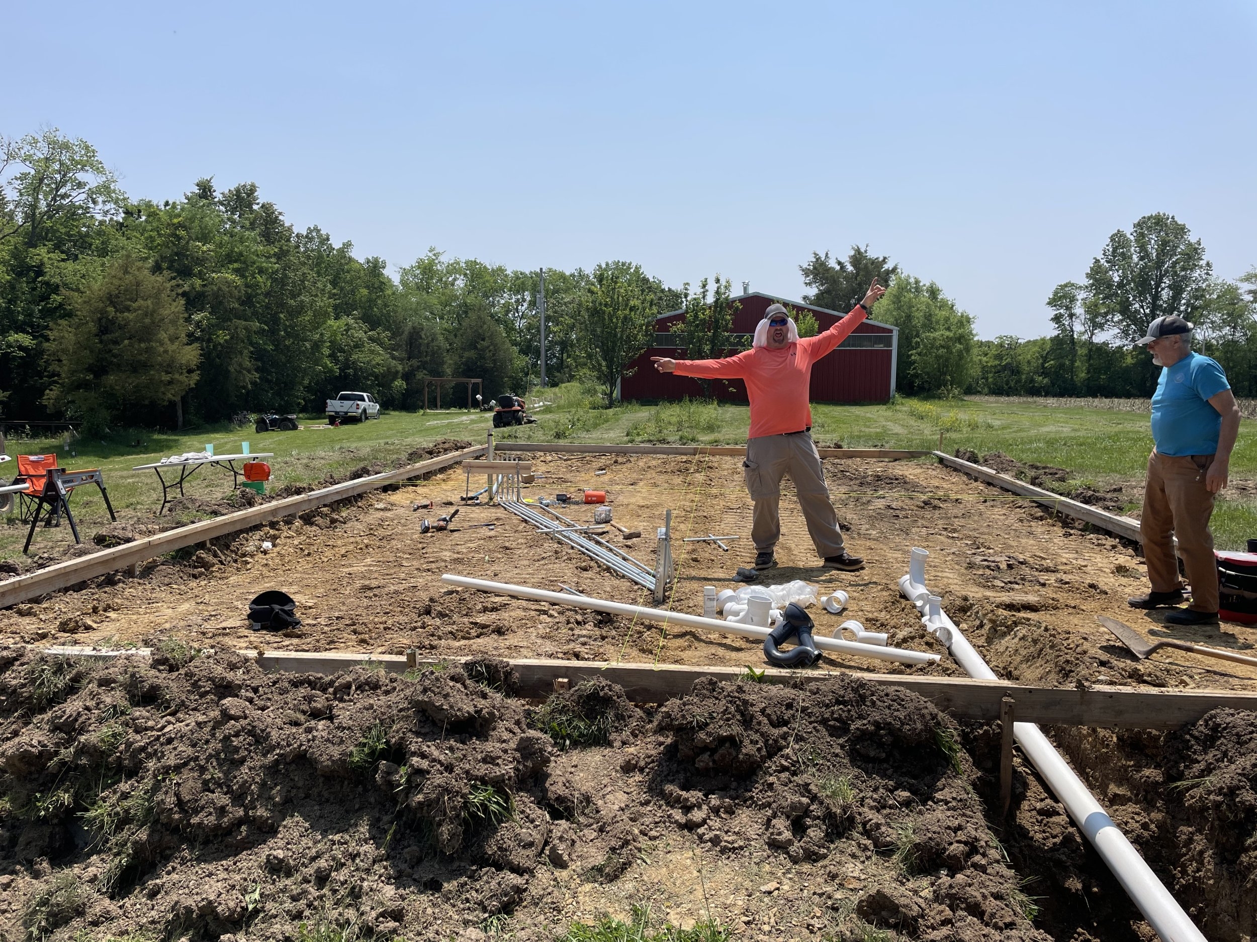

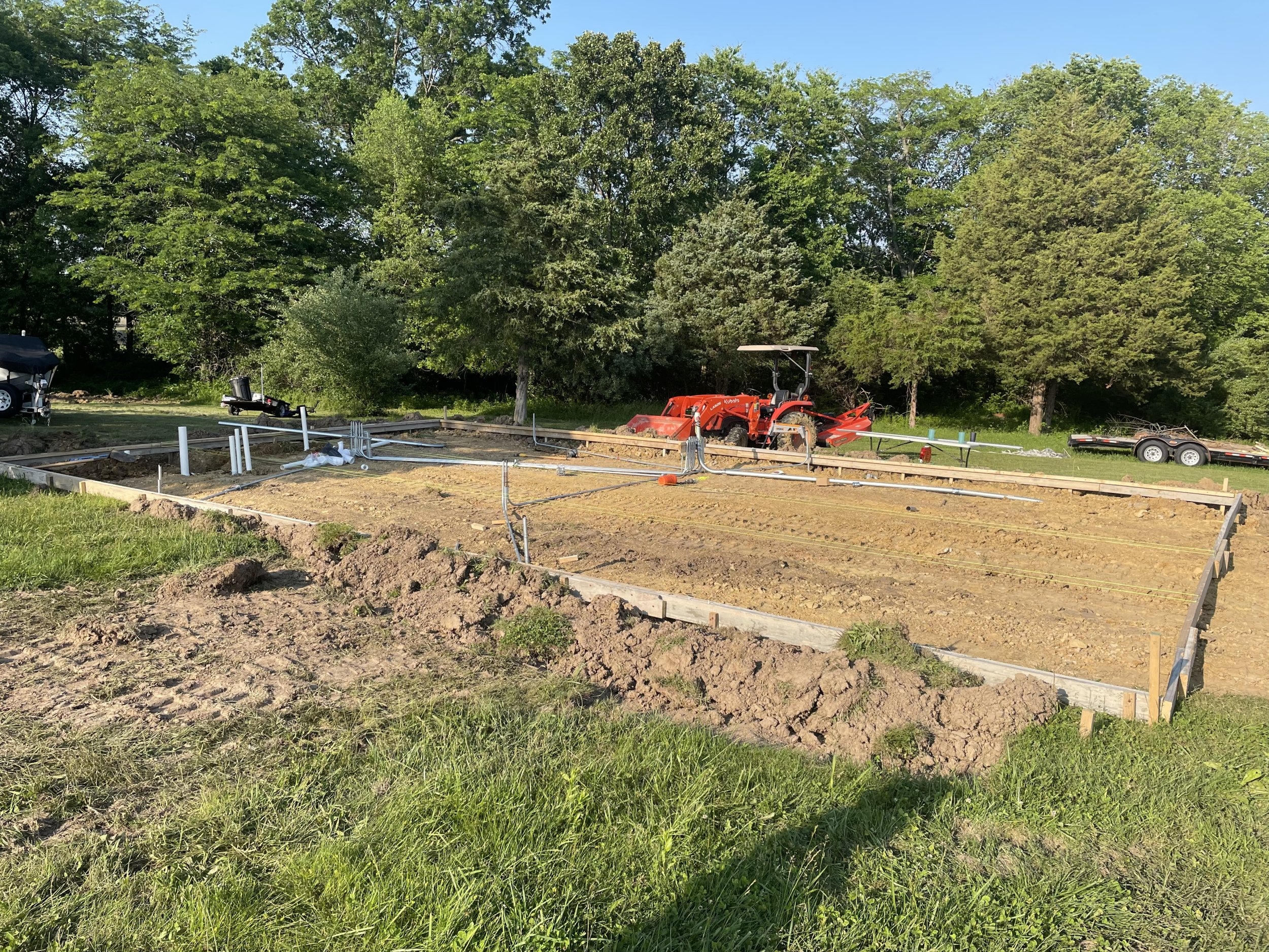

Under slab electric-done
2” pipe for incoming service
3/4” pipe for runs around the building
We are going to install a 24x4x4 wiring trough under the 200amp service to consolidate the pipe work.
A 12x12x4 box will go in the wall where we have 6 pipes coming up out of the slab from the panel. These are most of the high amp circuits in the kitchen/bath/laundry/mech stuff
DWV-all cut and positioned. We will glue and backfill this morning.
Still have to put a 2” chase for the incoming water line. It’ll poke out 36” below grade out of the slab in the mech/laundry room.

We set a a 2” emt elbow 36” down as a chase for the 1” pex water line.
No skimping on primer on this job!

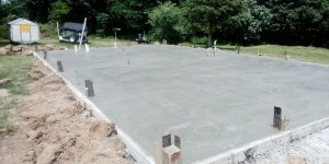

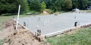

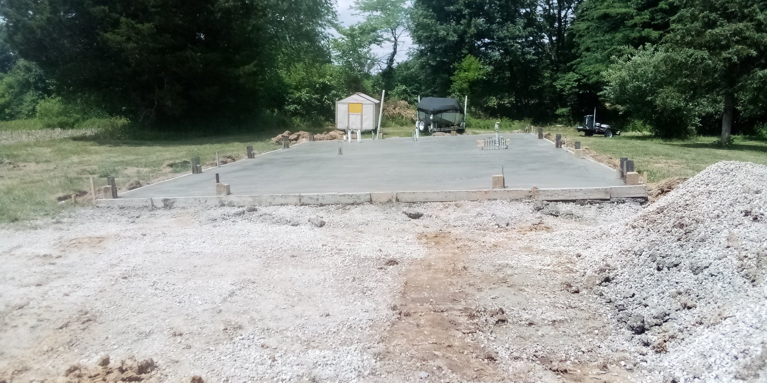

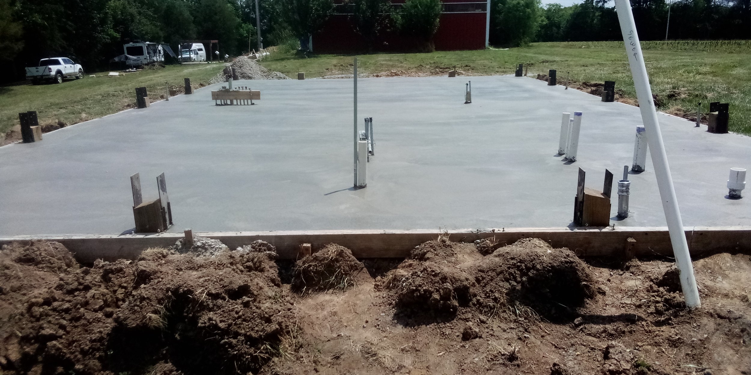

Slab is poured!!!
Crew showed up about 6:30
First truck about 7:10
They were off site about 1:30
15yds approx
Wet set post bases in
Couple pieces of rebar around the perimeter
Power troweled for a nice smooth finish
The front porch is most likely gonna be one step down
There’d be a lot of fill of it was level or an inch down…..knee high approx. porch will be poured later

Your slab looks really nice!!! I'm surprised by all the utilities you have coming through it for just a small living area.

We wanted to run most feeds under the slab. 200amp service.
Trying to keep the ceiling area in the “house” free of pipes

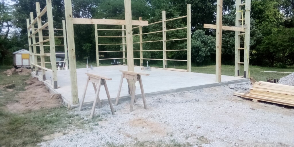

Walls going up!!!
Spoke to the builder this afternoon…….
Trusses ordered and arriving early next week
Wife will email colors tonite for metal 7-10 days for leadtime
Added a window (3x4)
Moved a window
Eliminated wainscoting-boss lady wants solid color walls
Asked builder if he’d be done by July 6-7 so I can schedule spray insulation contractor…..he said yes.
Septic contractor has all his supplies on hand…..hoping he can start before wheat harvest! Supposed to start harvest June 25
